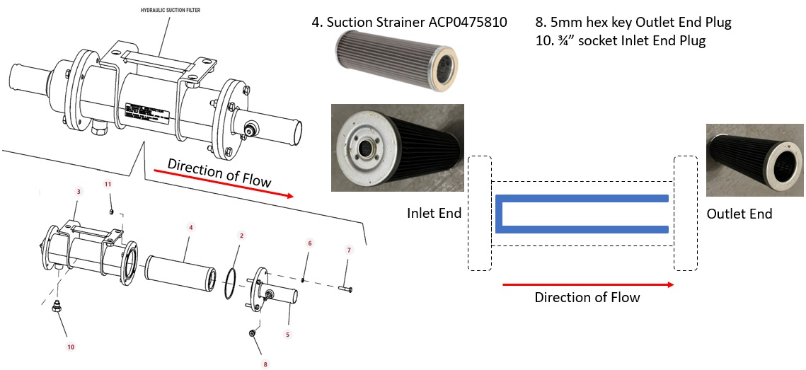

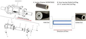

Thanks for all the advice. I added hydraulic fluid, verified the return filter, and the last thing to verify before sending it to the dealer was the suction strainer (this was the last thing I had changed that I hadn't re-verified). Long story short, I'm an idiot and sorry for wasting all of your time. I had put the suction strainer in backwards. I drained the hydraulic fluid into a clean container so I could reuse it, and the problem became obvious when I first took out the downstream drain plug and barely anything came out. Then I took out the upstream drain plug and it poured right out. When I had first removed the old strainer, I remember that I dropped the strainer out on accident, so I didn't get a good look at how the old one was installed. The correct placement of this feels a bit counter intuitive to me, so I know how I made this mistake, but I've attached a picture of how it should have been installed just in case this helps anyone else avoid what I did.

AH I had wondered about suction strainer but where you had specifically mentioned return filter I mistakenly fixated upon that.
good to know you are up and running. hopefully, due to the few moments you have run it, no damage was done.
we all learn from our mistakes and I make so many I learn crap every day LOL
thank you for posting the correction, it very well may help others in future.
