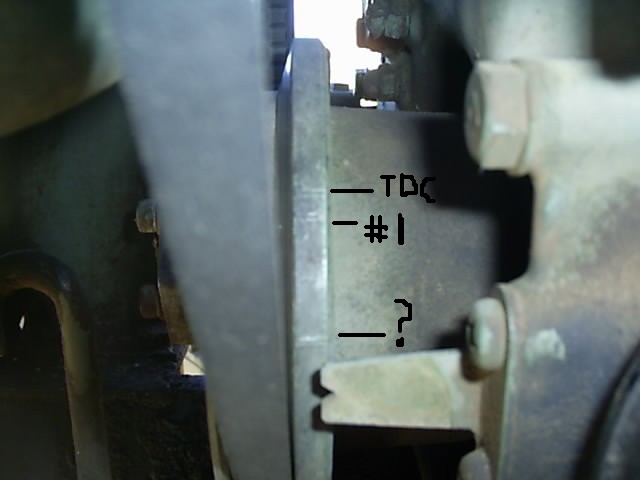

I have posted a photo of my crank pull timing marks.. My manual has a photo too but photo is black and I cannot see anything.
I need help to determine which mark my 3T80 engine injector pump is supposed to pop the #1 injector at.
Right now injector #1 pops at where the number 1 is stamped on crank pully, I set it there. Starts better in cold weather but I think its only 1 to 4 degrees advanced. My manual is not for a 3T80 its for a engine in a 336 not a 2610. Manual says 21 degrees advanced. Is that what my engine should have and what are the marks in photo. I have labled them what I think they are but if someone could confirm what each mark is it would be a great help.
The manual I got from Hoyles is very good for giving proceedures but photos are black and sometimes like this they are a must. Plus I have issues with knowing exactly what information is correct for my motor.
Please help, I will not bother anyone again if nobody can help me. I will just have to tare off valve cover and undue the #1 intake valve and rotate engine until valve peaks... Then I will know, but its alot of work to do when I should have a manual that tells me.

My 336 manuals says 25 degrees BTDC. The only manual that I have for the 3T80 engine says 24-28 degrees BTDC. 0.1mm shims change timing by about 1 degree.

Thanks, Danny!! That helps alot. At least now I know what the timing should be.
What manual do you have that shows info on the 3T80 engine?
Does the manual you have say what the different marks are for the crank pully????
The main probem I have with my manual is tha it shows a timing mark and in order for me to hit the "TIMIMING MARK" I had to install a 1/16 inch gasket plus all the shims that were under pump. That would be the equivilat of 16 each .1 mm shims!!!!!!
It is obvious at this point that the manual Hoyles sent me for the 336 has some major deviations, from my 2610. This is why I am dependant on this forum now to give me some guidance.
Now I am even wondering if my valve clearances are correct. The 336 manual states .006 inches or .15mm. Does anyone know if that is correct for the 3T80 engine??
Danny, you are correct my 336 manual does say 25 DEGREES BTDC.

OK, based on the info provided by Danny and my measurment of the crank pully diameter (4.5) inches. I was able to calculate where my timing mark should be given that the mark in the photo I have labled as TDC is in fact TDC.
24 degrees equal approx .93 inches straight line distance from TDC mark.
28 degrees equal approx 1.08 inches straight line distance from TDC mark.
Believe it or not the 28 degree mark lands right on the unknown mark!!! I have to assume this is the timing mark.
Now here is the hard part. While checking timing I removed all shims behind pump and re-installed. Injector #1 popped about 8 degrees after (assumed) timing mark, and 20 or so degrees before TDC mark.
I have to assume some sort of mechanical problem or my methods of checking timing are wrong. For there is no way to hit (assumed) timing mark with out grinding flange of the pump.
My method was to unhook the injector #1 (rear most) fuel line at injector. I hooked a small plastic hose to injector line and then inserted a even smaller plastic tube in plastic hose. Filled line and tube almost full with diesel fuel and rotated engine CCW by hand untill I was sure all air was out of fuel line, hose, and tube. When fuel in tube began to rise I slowed rotation until fuel level did not rise anymore and that is where I stopped the engine rotation. I assume this is the spot where my timing mark should line up with the pointer???
Can someone tell me if my methods are wrong??
If not is it possible to have some sort of wear between pump and cam that will cause pump to get out of time, to the point where surface grinding may be required???
If my method is good this could be the issue I have been chasing for the last few months. IE hard to start in cold weather. Timing would definately cause hard starting issues.
