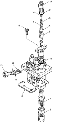

I have a question related to how injection pumps work.
I have a TC33, I changed the fuel filter and could not get the air out. The middle injector bleed fine. The front was weaker. The rear was hit and miss. Sometimes fuel came out and other times it did not. I did get the problem fixed. My son had come over to help. He was going to bleed the injectors at the pump. I corrected him and we tightened up what he started to open. Or so we thought.
It turned out the big piece coming out of the pump that looks like an injector was just a hair from being tight. The line kept it from tightening. When we would really get it tight, about a second later there would be a ping. The line would un-tighten it. I had to take the line loose before I could tighten the big thing.
So my questions:
What is that big thing?
Why did it not bleed?
Why did it stop fuel from making it to the injector?

Your question: What is that big thing? It is the injection pump if I understand you correctly.
You can think of the injection pump as a very specialized hydraulic jack that pumps a small high pressure volume of fuel to the injector where it is sprayed in a fine mist into the cylinder at just the right time in the engine rotation. The pressures are often 15,000 psi or higher so nothing to treat lightly.
A liquid is in-compressible. In other words if you have a tube full of liquid and apply a force to one end of the liquid that force will be immediately transferred through the liquid to the other end of the tube.
Air on the other hand is compressible. An air compressor keeps squeezing more air into its storage tank and the pressure builds up over time. But air is like a spring and does not immediately transfer force like a liquid does. If you have a high pressure steel fuel injector supply line with a tiny bubble of air in it, when the injection pump tries to send a pulse of fuel to the injector the air bubble will just compress and absorb the force in the fuel. The injector relies on the high pressure fuel to force it open allowing fuel into the cylinder. The injection pump is a bit like a distributor on a gas engine which provides a spark at just the right time for each cylinder but in this case rather than providing a spark it provides a pulse of fuel.
Your question: Why did it not bleed? To bleed a fuel injection system on a diesel, things must be done in the correct sequence or you will be unsuccessful.
First you need to bleed the low pressure part of the fuel system which includes the filters and possibly even part of the injection pump. Having an owner's manual for your machine will be a big help as it will provide instructions on bleeding for those times when you run out of fuel or are doing maintenance. The final step in the bleeding process involves loosening the steel lines at each injector as the engine turns over. Once you get a tiny spurt of fuel out of the slightly fitting tighten it and move to the next injector. You cannot do all injectors at once.
Your question: Why did it stop fuel from making it to the injector? You had not bleed the system in the correct sequence and had air bubbles in the system.

I'll add to Dave's post that nut(parts key 1A) holds plunger(parts key 8) into inj pump housing so that plunger can pump fuel to the corresponding injector.

Thanks, From looking at the pic would I be correct in thinking that with part 1A not tight part 8 did not work?

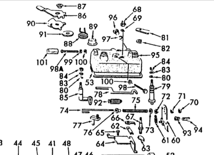

I replaced the o-rings on the throttle shaft and fuel stop shaft because of a leak I put cover back on I bleed the bleeder hole I get a good stream no air, tighten nut.no fuel is coming out of the 3 lines am I not bleeding it properly? I'm sure I got the fuel stop pin in the hooked bar when I put the top back on I loosened the lines but no fuel. It worked before I removed the top.I have the two filter setup,a friend told me to fill up the filters with diesel fuel because I changed them, that mite help are there any bleeders on the top housing
Did that on my 3600 a few years ago. I think you have to bleed the fuel filter so no air in there, then bleed at the injector pump. On mine there is a bleed screw on the injector pump. It is on the side of the round pump body toward the rear on the side facing out. Then bleed at the injectors. I found an article or post about doing this online but don't see it now.

I'm not Dave but I'll bet you didn't get linkage under IP cover attached back the way it was originally therefore fuel isn't getting turned on inside IP.

According to parts catalog Ford 4500 has a rotary CAV IP. I'll bet something under cover on these linkages is attached incorrectly. Is kill cable linkage in correct position?
