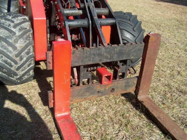

Oh Highridge, Highridge, Highridge...
I thought similar things before I purchased, too. My forks were just going to be for lifting stuff. I bent them once when I wedged them crooked into an old brush hog that I was attempting to muscle around the back yard. The rear of the tractor came off the ground as the tip of the fork bent down. Sledge hammer took care of that one.
Second time I was prying concrete post anchors out of hard ground on a playground. I like to point the forks almost straight down while applying down pressure to the FEL arms. As I push down and the front wheels come off the ground I then wiggle the joystick left and right to vibrate the forks into the ground about 2 feet. Then as I rock the tractor back and forth with the treadle and wiggle the joystick all over the place, one of three things will happen. The huge chunk of concrete will slowly emerge from the soil. The rear of the tractor will come off the ground, OR... the forks will bend many inches out of line, usually bending just one of them. /forums/images/graemlins/tongue.gif
The forks have many uses besides lifting stuff. /forums/images/graemlins/wink.gif
I'd do like JJ said and check out fork lift shops for some adjustable forks of heavier design and have a quick hitch plate welded onto them. Be sure to do the slight anlge on the hitch so you get the proper travel as has been discussed in another thread.

Maybe it would be more worthwhile to buy the attachment plate and find a small, sturdy set of forks to weld the plate to.
I won't be carrying pallets with sod or pavers.

Mossroad is right! The forks are great for removing fence posts and I particularly like them for removing shubbery. Adjust the forks close together, insert them beneath the root ball, tilt the forks up, move them left-to-right to cut the remaining roots and tap root and pop the shrub out of the ground.
They are also usefule for removing asphalt and concrete slabs. They are great for pulling up roots when clearing. In a pinch, I have used them to lift the rear of my car to put jack stands under it. I still have an old lawn tractor that I have to work on frequently. It is great for lifting the tractor up to a comfortable height to work underneath it. If you do this, make sure that you add support underneath the forks. The hydraulics will slowly creep down with time.
There is also a clamp-on trailor hitch available that will clamp directly to the forks. This allows you to push a trailor and place it where you want it.
After felling a tree, I use the forks to lift the trunk up so that I can safely remove branches and cut the trunk.
As with any piece of equipment, you have to think about how you are going to use and be aware of potential things that can happen. For example, you don't want to use a chain saw too close to the forks.
