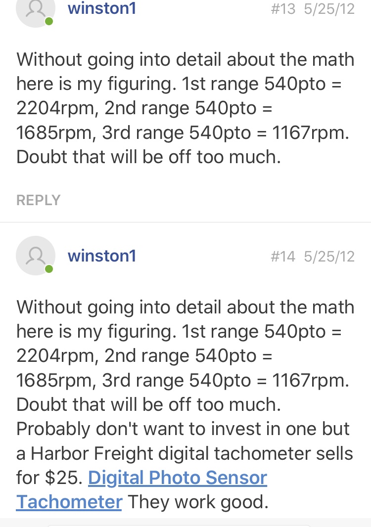

This is one of those bits of wisdom that I have gained from Winston1
