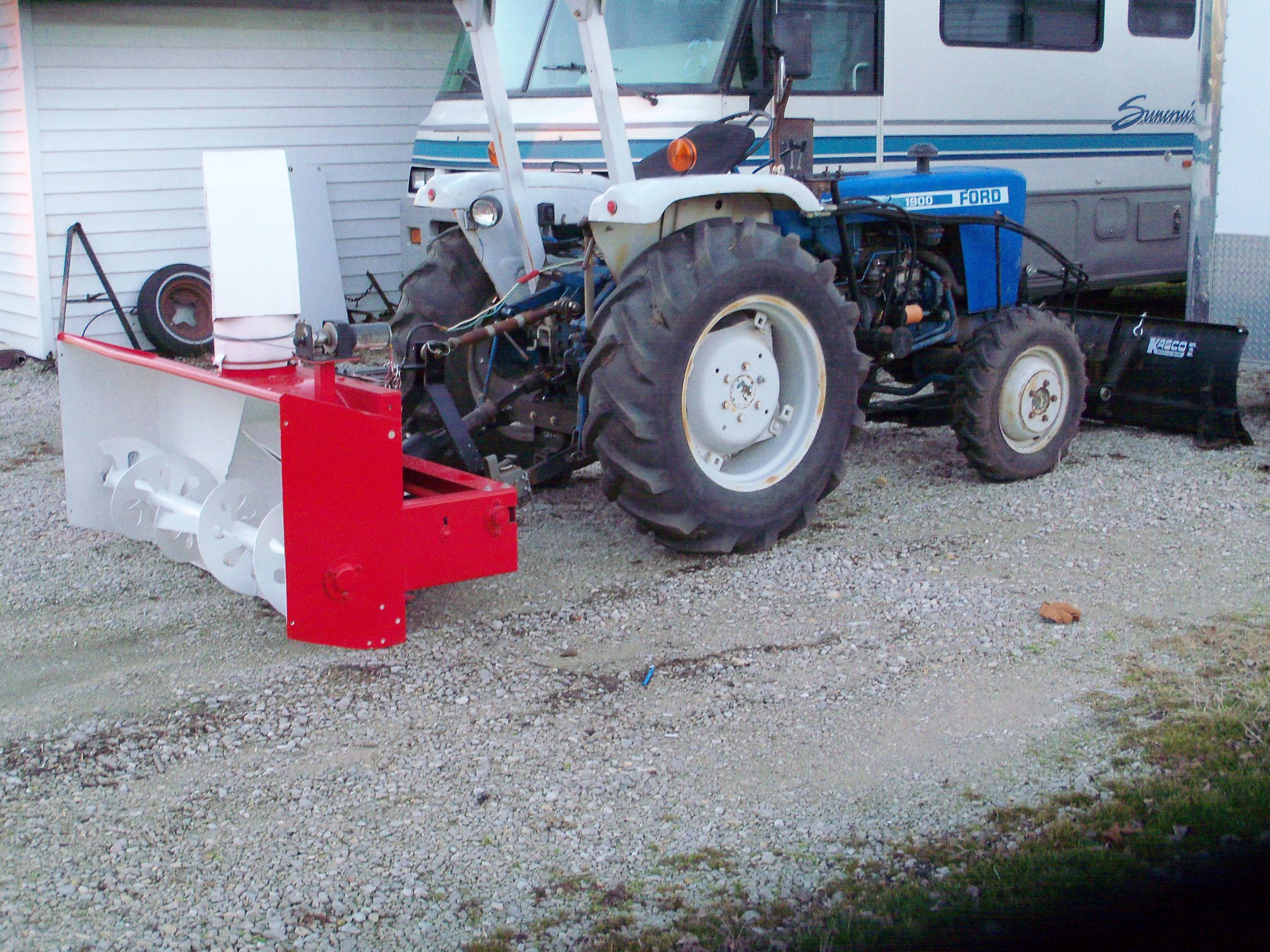

I have a Ford 1720 SSS and have used both a 3 and 4 blade snow blower.
When I was looking to purchase a new snow blower I was in the same situation, how big & which one to buy.
I also calculated the velocity & area of the fan to help my decision.
While your math may be correct in this instance speed works against you.
You need sufficient speed to throw it 20 or 30 feet not atomize it & throw it into the next county.
I would bet on the Ford that operates at 540 because it has twice the torque available to ingest, accelerate and throw the snow out the discharge.
The 4 blade (my current snow blower) discharges the snow much smoother & appears to be more efficient but 24 of snow or snow that is plowed at the end of my driveway by the state would bring it down to its knee痴 for lack of HP during the first full cut. That problem was solved 2 years ago when I installed a turbo on my Ford which solved the HP problem.
The 3 blade impeller is less efficient than the 4 blade but the HP used to accelerate the snow to 51 mph will in my opinion overload the Kubota.
My bet is that the Kubota running at 1100 rpm will struggle
Tim

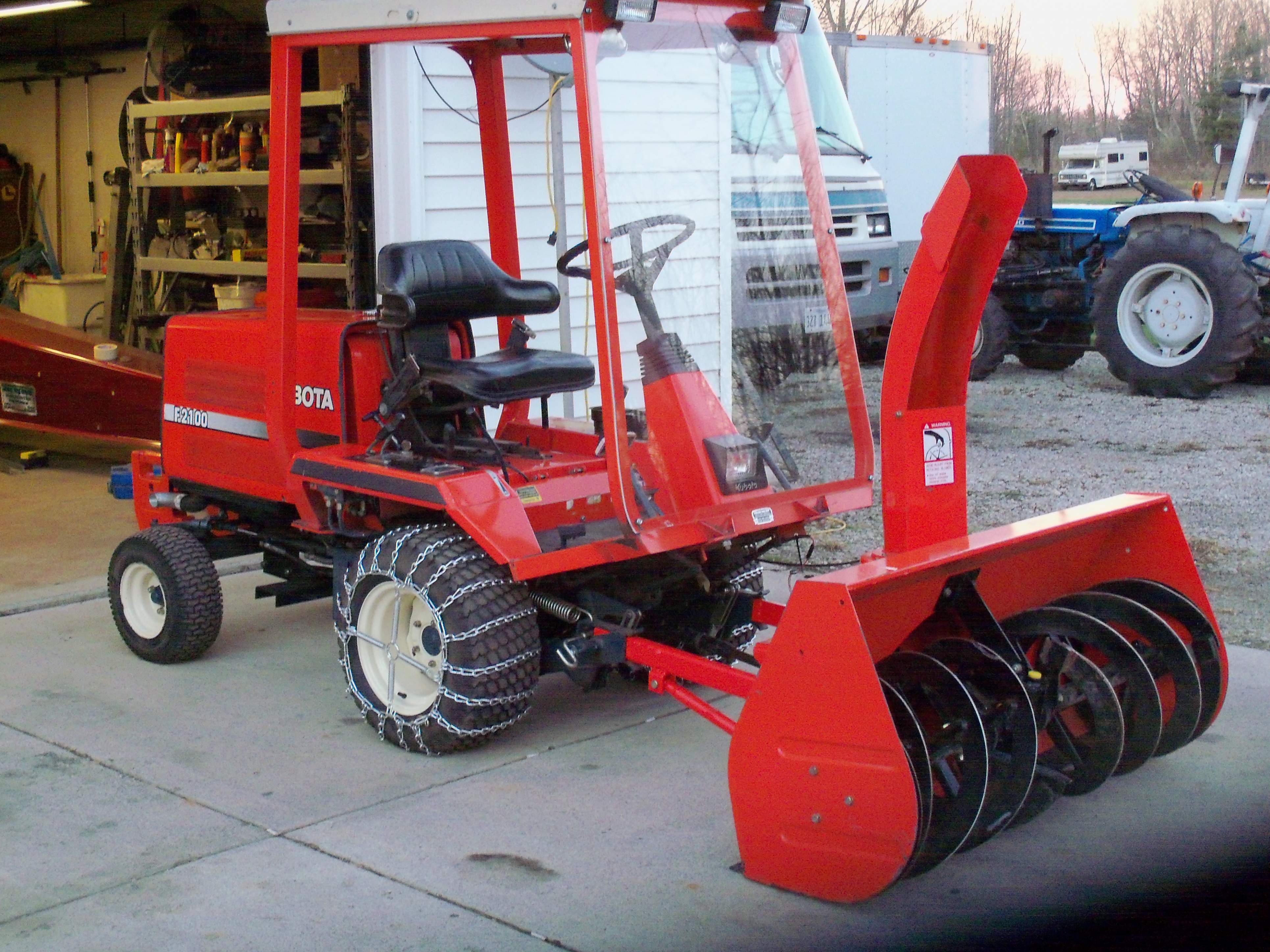

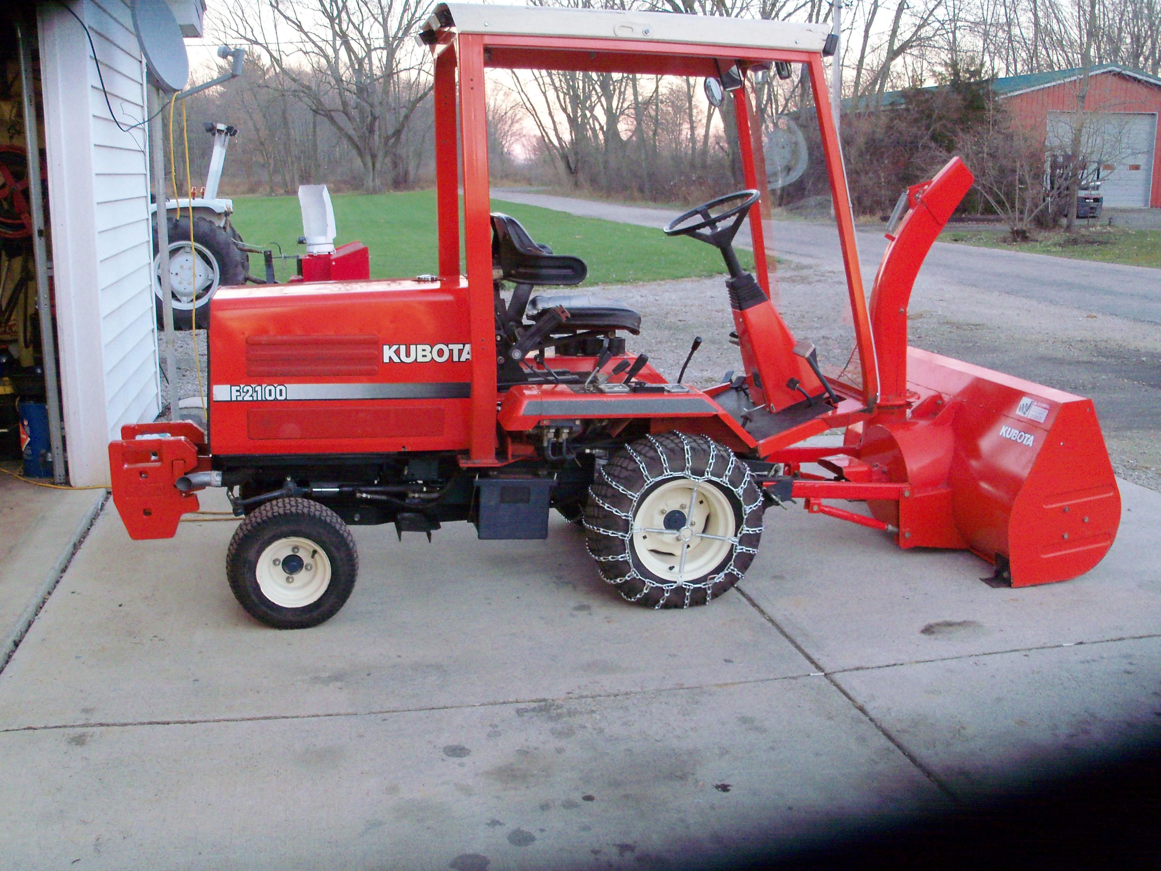

I hope the Kubota does as well as I am hoping. The front mount will make my life a lot easier. here are some pics.100_0479.jpg100_0480.jpg100_0481.jpg100_0482.jpg
   / In theory which blower would be better #14
IMHO front mount blowers are safer and easier on the body. (No twisting around to see where you are going.)
They are also more expensive. :(

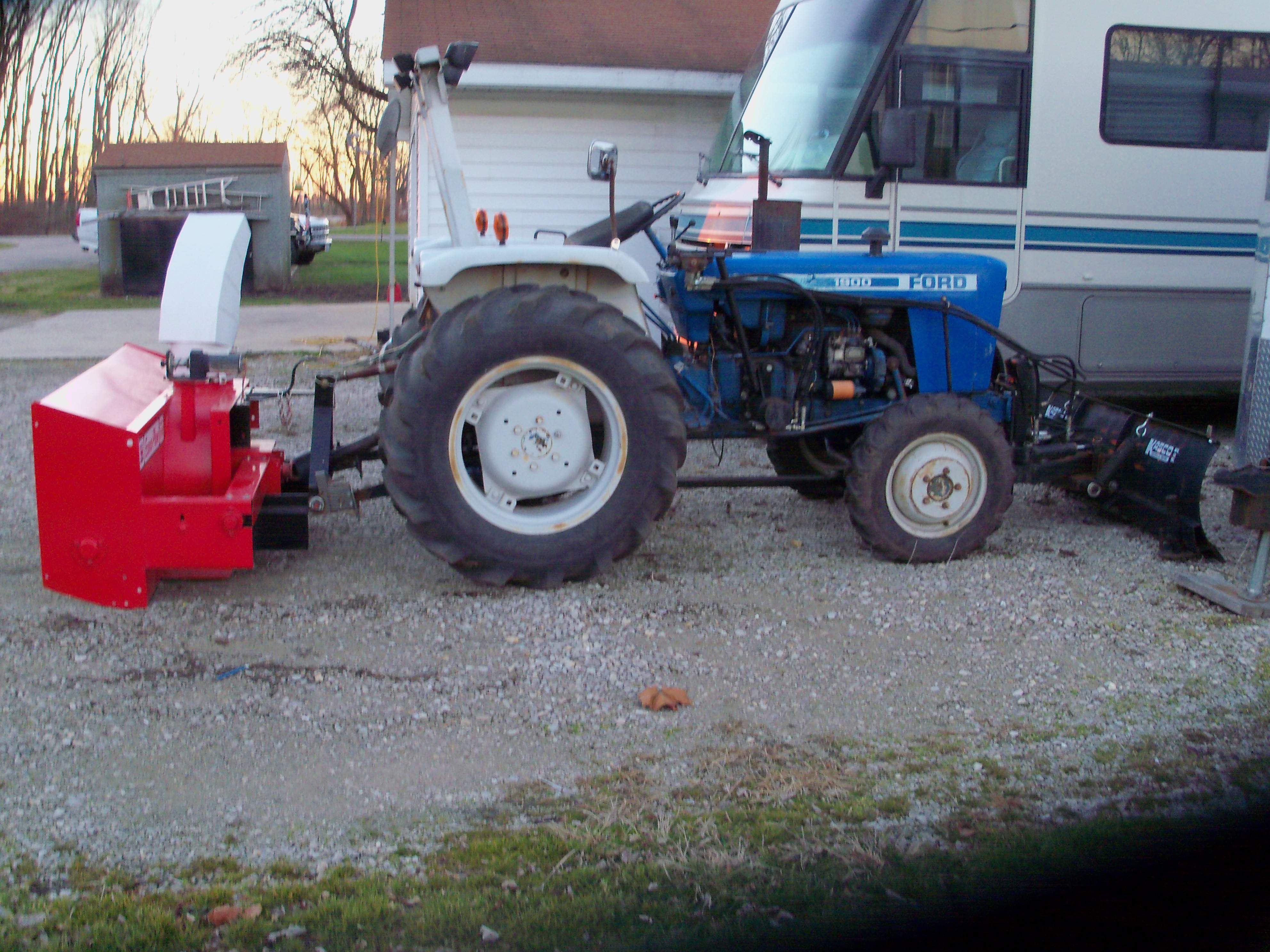

I have 2 snow blowers. I have not used either one yet. I have a 5'6" McKee with a 24" 3 blade impeller on my (29hp) Ford tractor that operates at 540 rpm's. If I did my math correctly this blower will have a discharge velosity of 38 mph. On my Kubota (21hp)I have a 52" with a 16" 4 blade impeller that operates at 1100 rpm's. The discharge velosity on this comes out to 51 mph. Acording to the math the kubota should be the best blower. Am I missing any thing here. It will be interesting to see which one does better. Maby one will do better in wet snow and the other better with powder. We will see if the math lies if it ever snows here.
Bill
Kubota hands down!
Wet snow (slush) will be a pain for any open auger blower...
The rear blower front blade would be good for this task
   / In theory which blower would be better #16

The Kubota puts out a lot more air. I might finally get a chance to try them out later this week :thumbsup:
Bill

What's your definition of "better"?
All other things being equal, in general, the higher the tip speed the farther the throw. Similarly, the bigger the immpeller diameter, the larger the through putfor the same rpm and on and on.
Your case has different impeller diameters, different impeller blade counts, different impeller speeds, different widths, etc.
So what do you mean by better?
