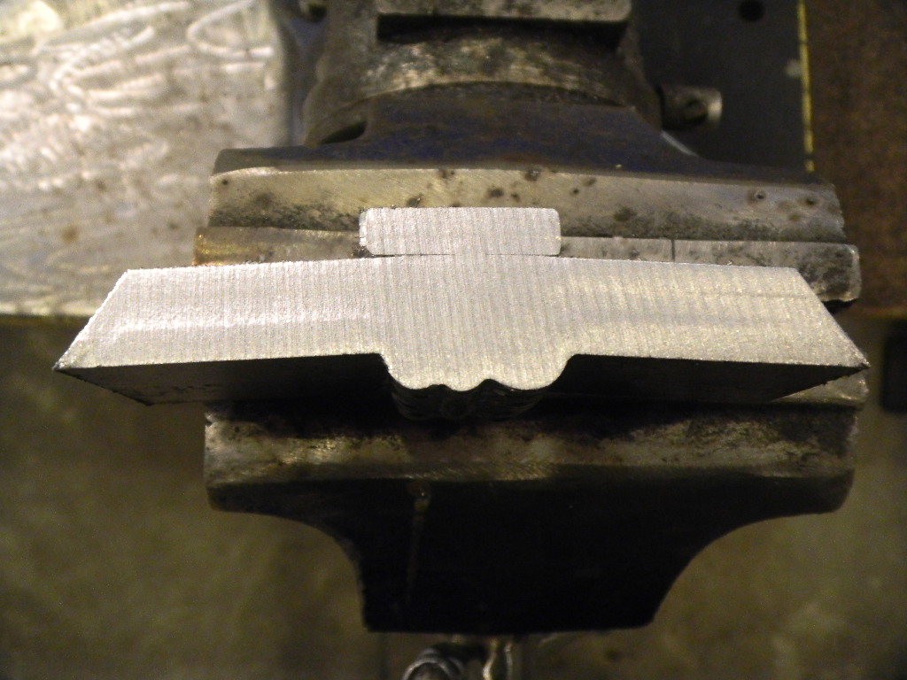

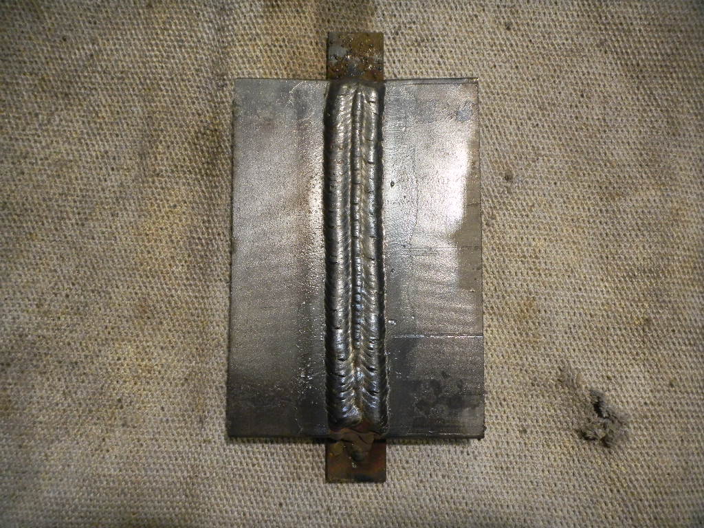

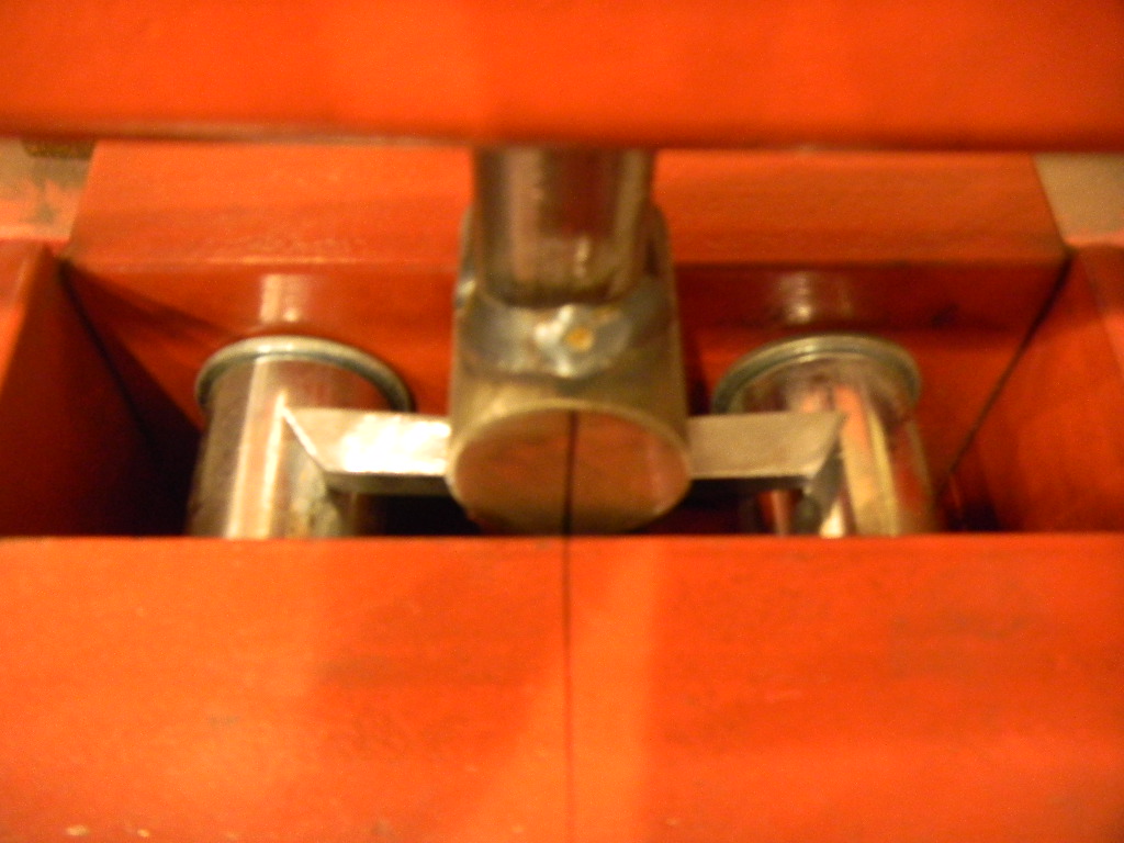

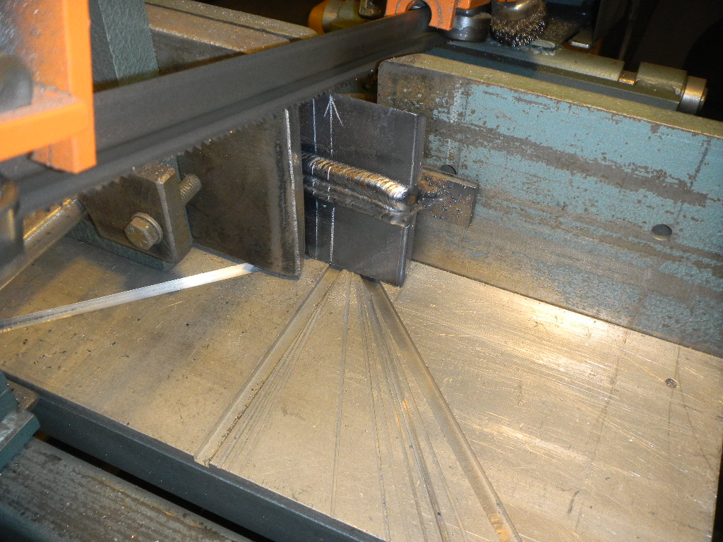

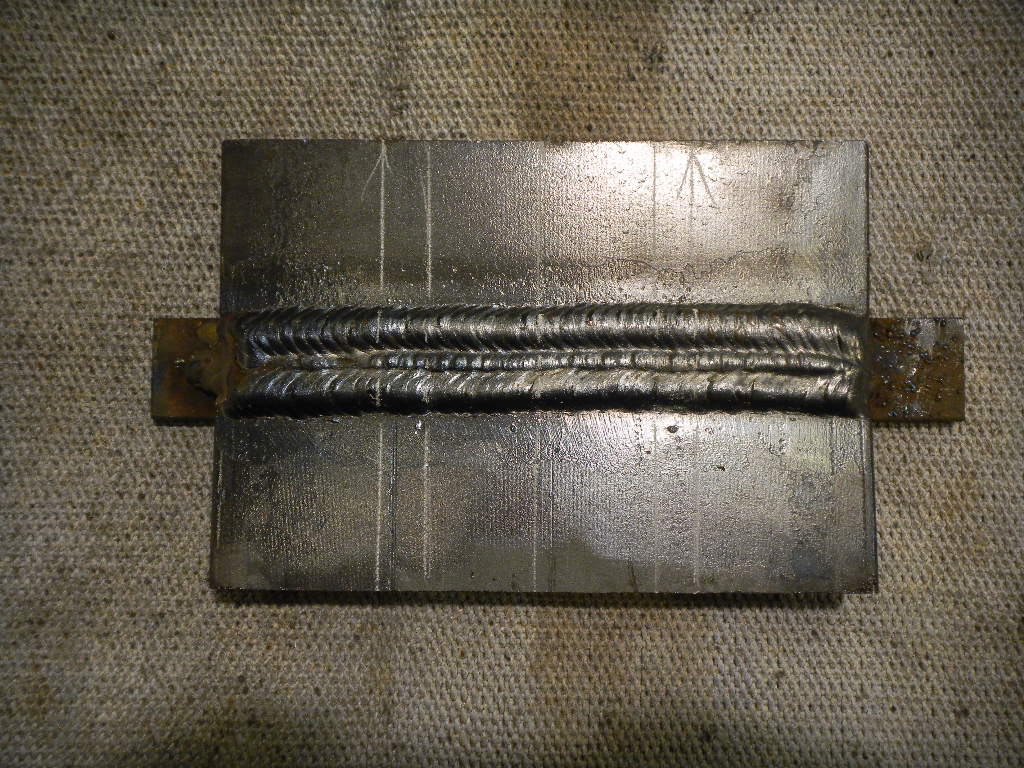

I agree with paulharvey. Let's have a proper series of tests done on 110v welds at the upper end of machine capability. That is the only way to learn and get
beyond the back and forth.
If there are any members here who live in the Puget Sound area who would be willing to loan me their 120-volt Mig welder. I'd be glad to run a side bend test. I'd like to get my hands on another one, with plenty of time to play with it.:cool2:
Here is a vertical up side bend I ran.
