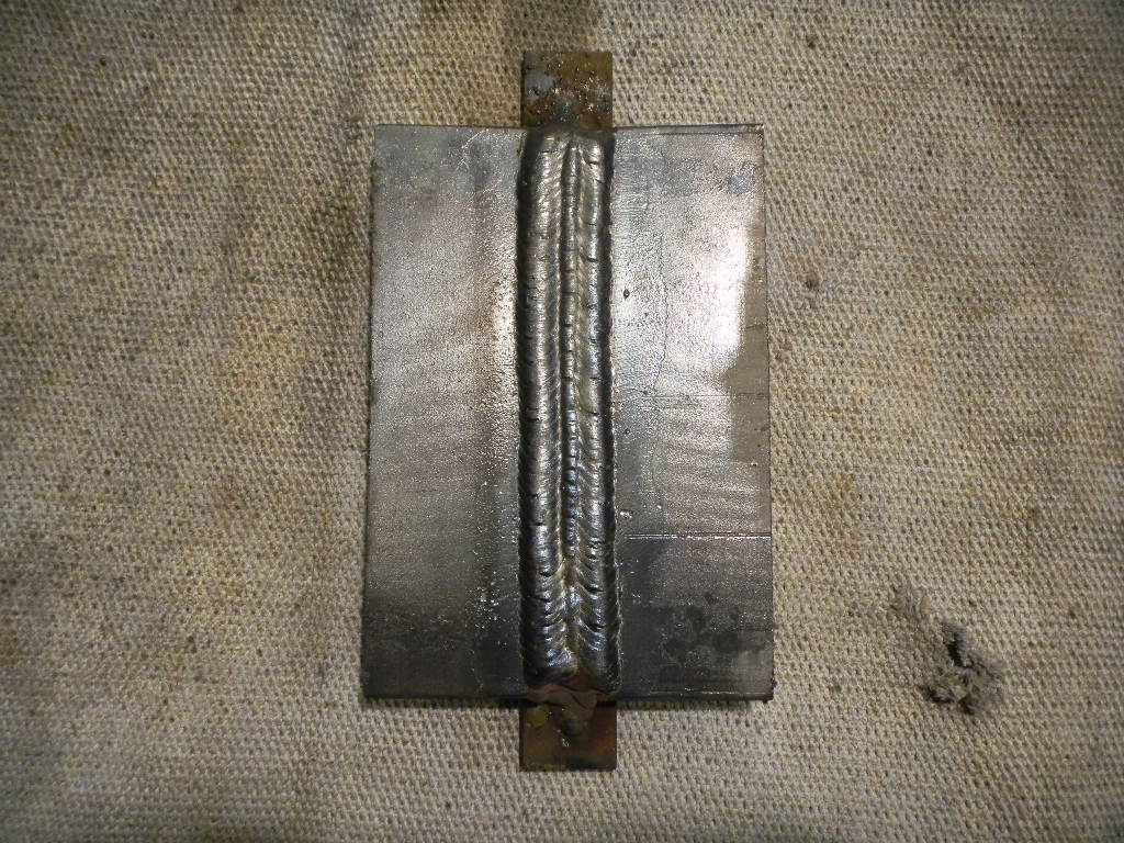

I agree with paulharvey. Let's have a proper series of tests done on 110v welds at the upper end of machine capability. That is the only way to learn and get
beyond the back and forth.

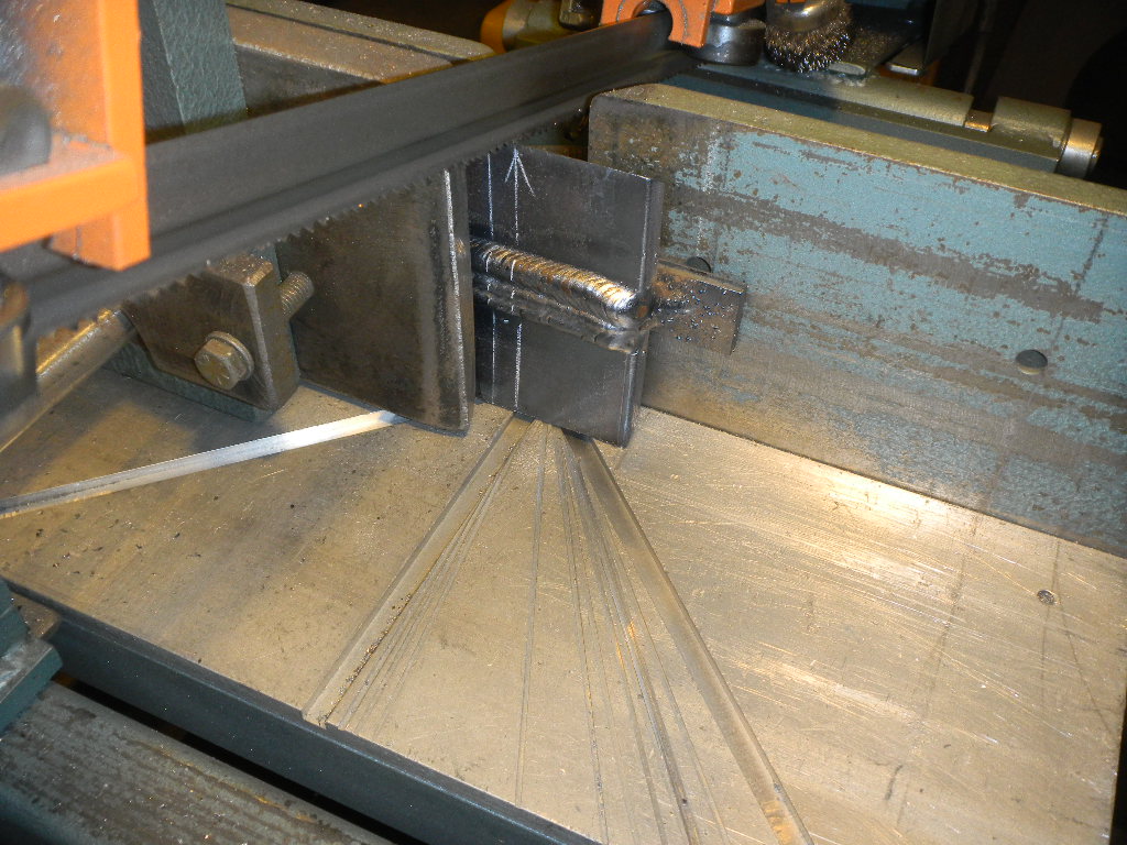

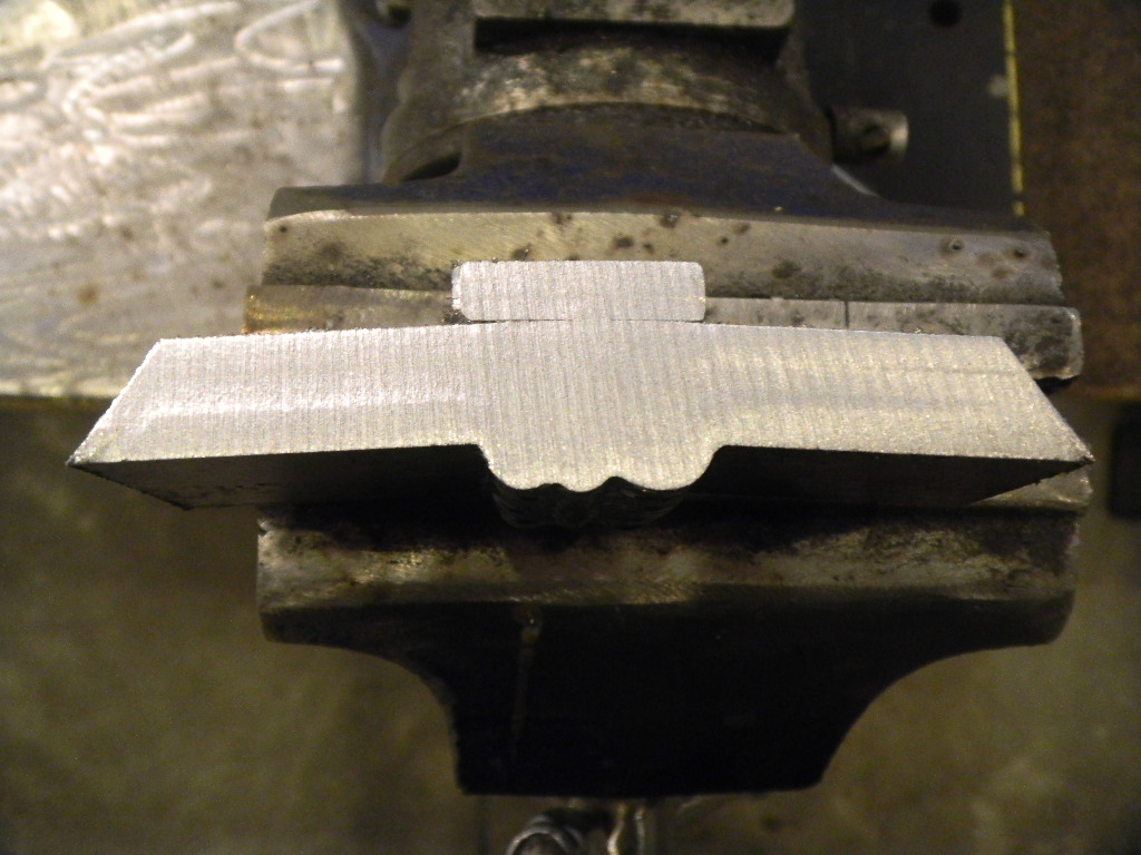

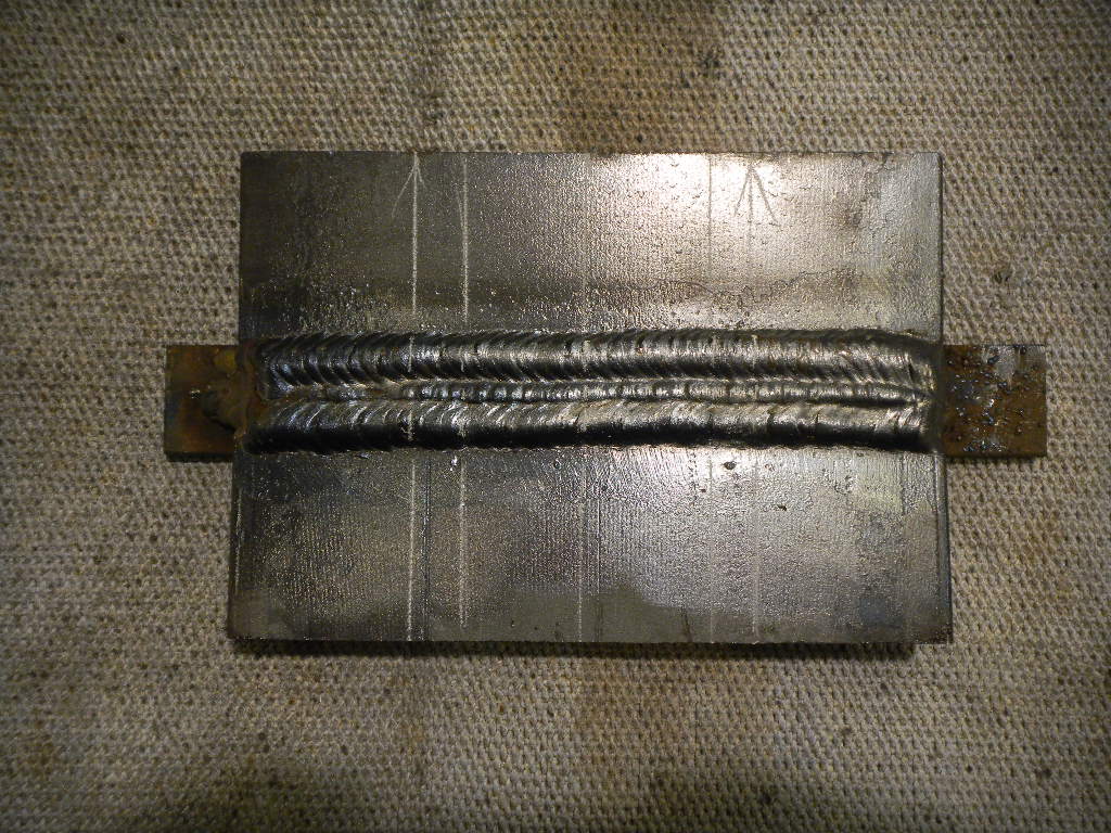

If there are any members here who live in the Puget Sound area who would be willing to loan me their 120-volt Mig welder. I'd be glad to run a side bend test. I'd like to get my hands on another one, with plenty of time to play with it.:cool2:
Here is a vertical up side bend I ran.

Mudd I can see that you understand how to use joint preparation to mitigate the lack of AMPs. Welders do it all the time. It doesn't take but a short time for a competent welder to learn this. I assure you that all the experienced welders on this forum know this intimately, and know very well how they'd any situation if ever stuck with a 110v MIG. Nobody says "you can't weld 1" thick steel with that little 225 Amp welder". All they say is "you can't do it in one pass". But with a 110v welder the general forum wisdom, even from the experienced guys is "you can't do it".
Well, you (often) can. A "110v welder and technique" is not for every welding situation but probably 95% can be done well (with regard to tractor forum projects that I've seen on this forum). More amps is definitely helpful. Sometimes if you don't have amps you can change the design to accommodate. For example add "bracing", or overbuild, which is perfectly acceptable.
Your statement is not not so far off. I think a more defensible statement, if you want to make a universal AMPS statement is "it takes AMPS to efficiently weld thick steel in a fillet weld". Show us the back side of the welded plate
