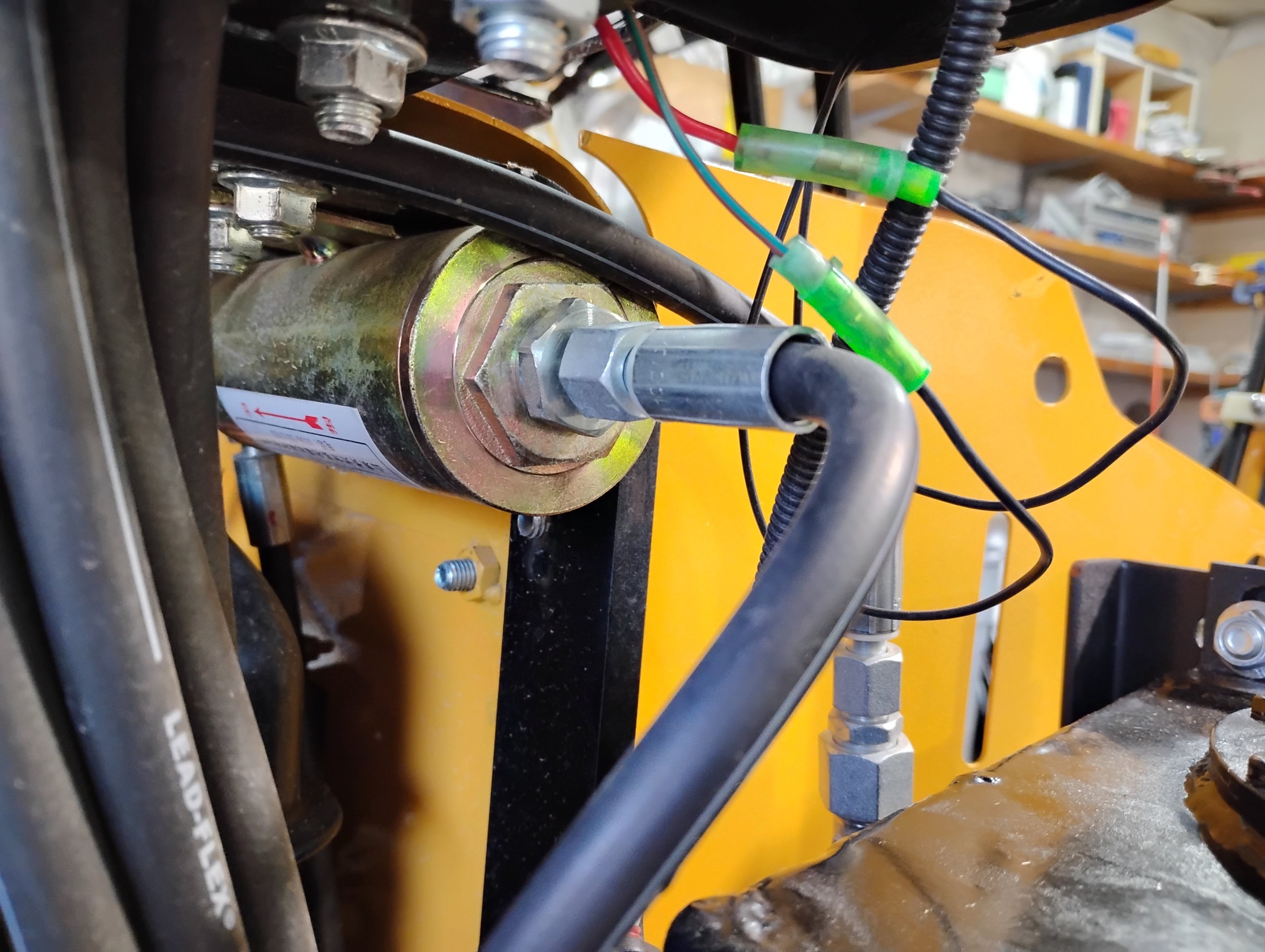

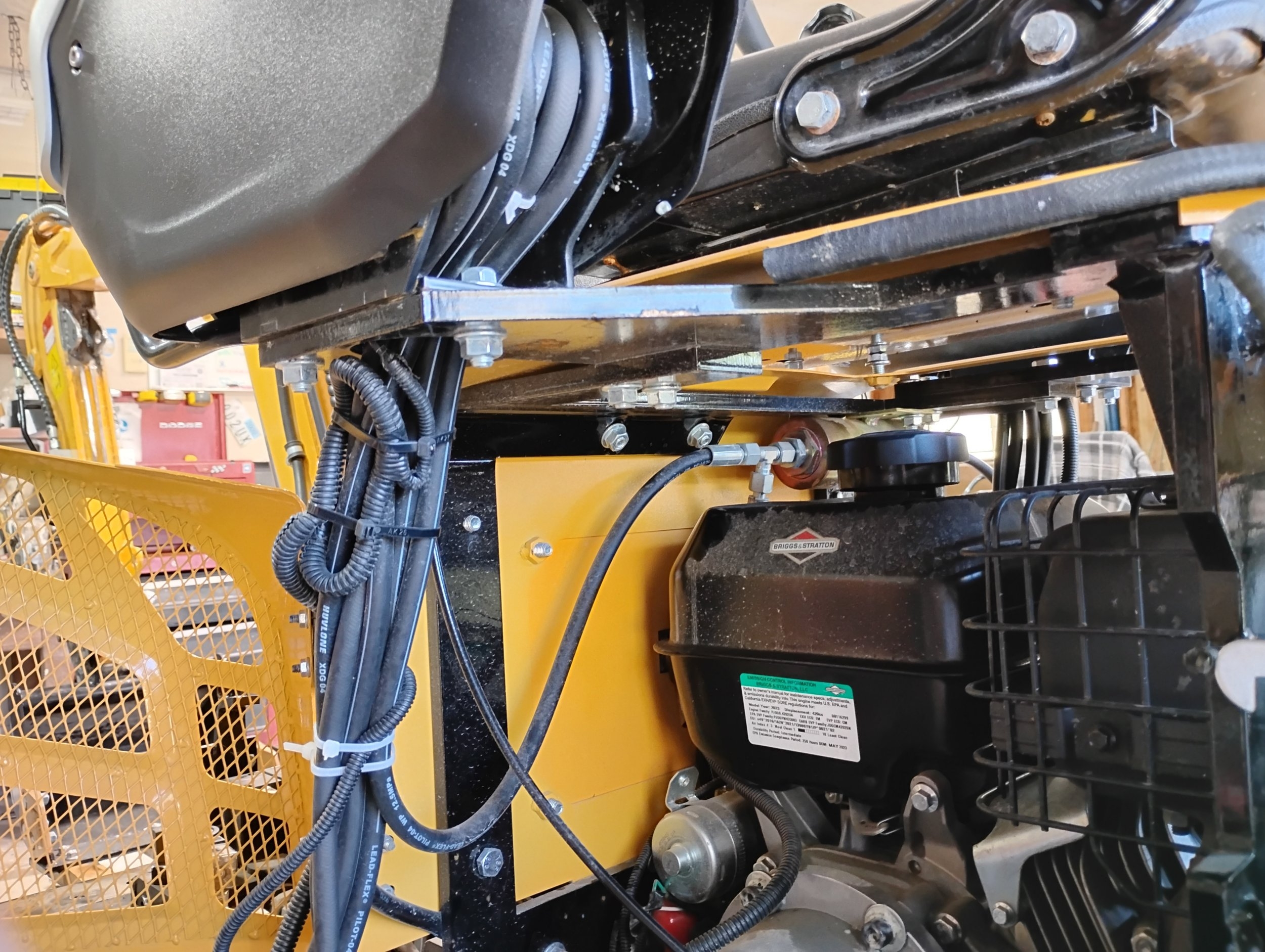

Well, curiosity got the best of me and I removed the floor plate for a good inspection. It looks like a small hose goes from the lower left side of the flow divider directly to the input of the filter just below the seat. I say input because of the red arrow on the filter housing. The output of the filter tees off and one hose goes to each of the pilot hand controls. Does that sound like it is a pressure filter?
I plan on taking it apart during my next fluid change for further analysis and hopefully determining what a replacement filter would be.

After I return, I will do some mods like replacing the existing internal tank filter with a 10u external one like you recommend. Will that filter alone be enough for the machine or would you also replace that existing ilot filter so all the return fluid is filtered
You could tee the return from the pilot valves to the IN on the return filter you are going to install, and use only one filter.
Looks like they put a hi-pressure filter on the IN line to the pilot controls. Strange. This filter will see the full pressure from the pump, regulated by the pilot RV, which is probably 500-1500psi. A proper return pressure filter usually is designed for no more than 500psi, and that's when it starts to resist flow.
I hope they chose that pilot pressure filter properly.

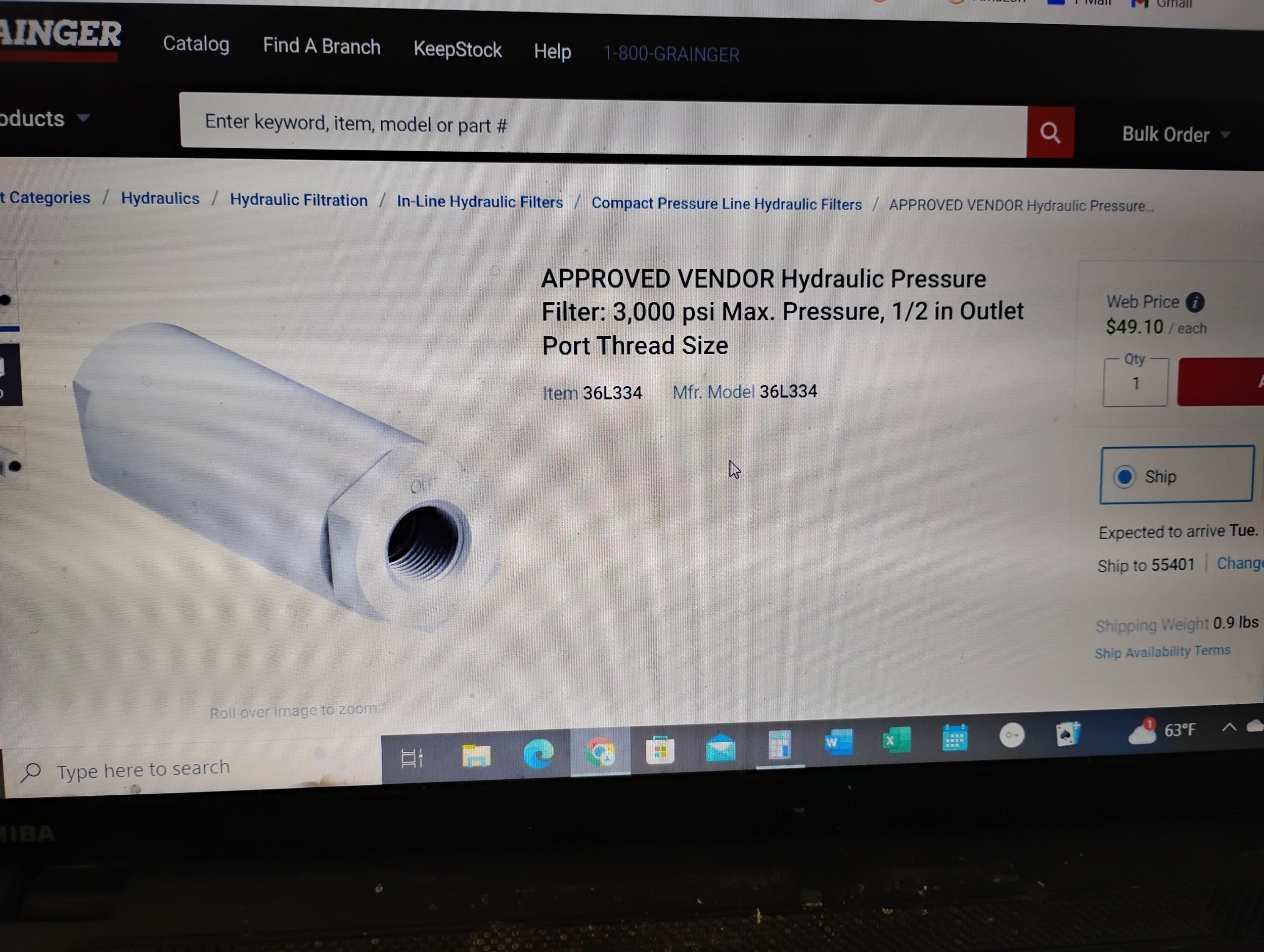

Most pilot hydraulic systems on CE I have been involved with have a pilot filter on the supply side. You don’t want crud getting into a joystick.
   / Importing and modifying a new mini excavator from China #1,308
It seems like a good idea to have that filter. I'm thinking or replacing the Chinese housing with one with from Grainger (or similar) which is about the same physical size but has 1/2 ports. I could even tee in a pressure gauge on the filter output port to monitor pilot pressure. The filter Housing is about $50 and replacement elements are $13, not a terrible price and maybe I can find one cheaper. It's 25u so it will still let the primary return filter do the really fine filtering down to 10u as the fluid eventually cycles through the entire system
Of course I will have to deal with metric adapters and that world is still mostly a mystery to me.

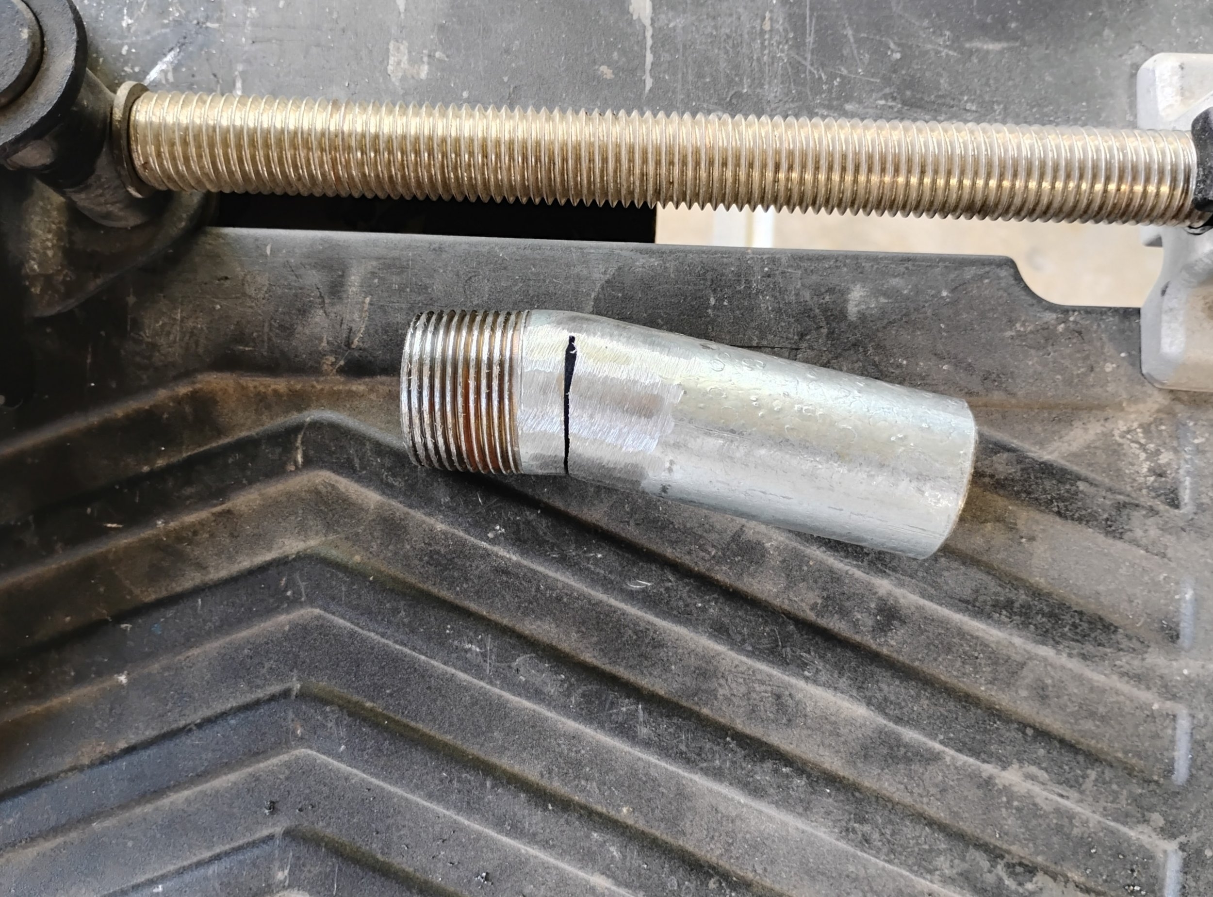

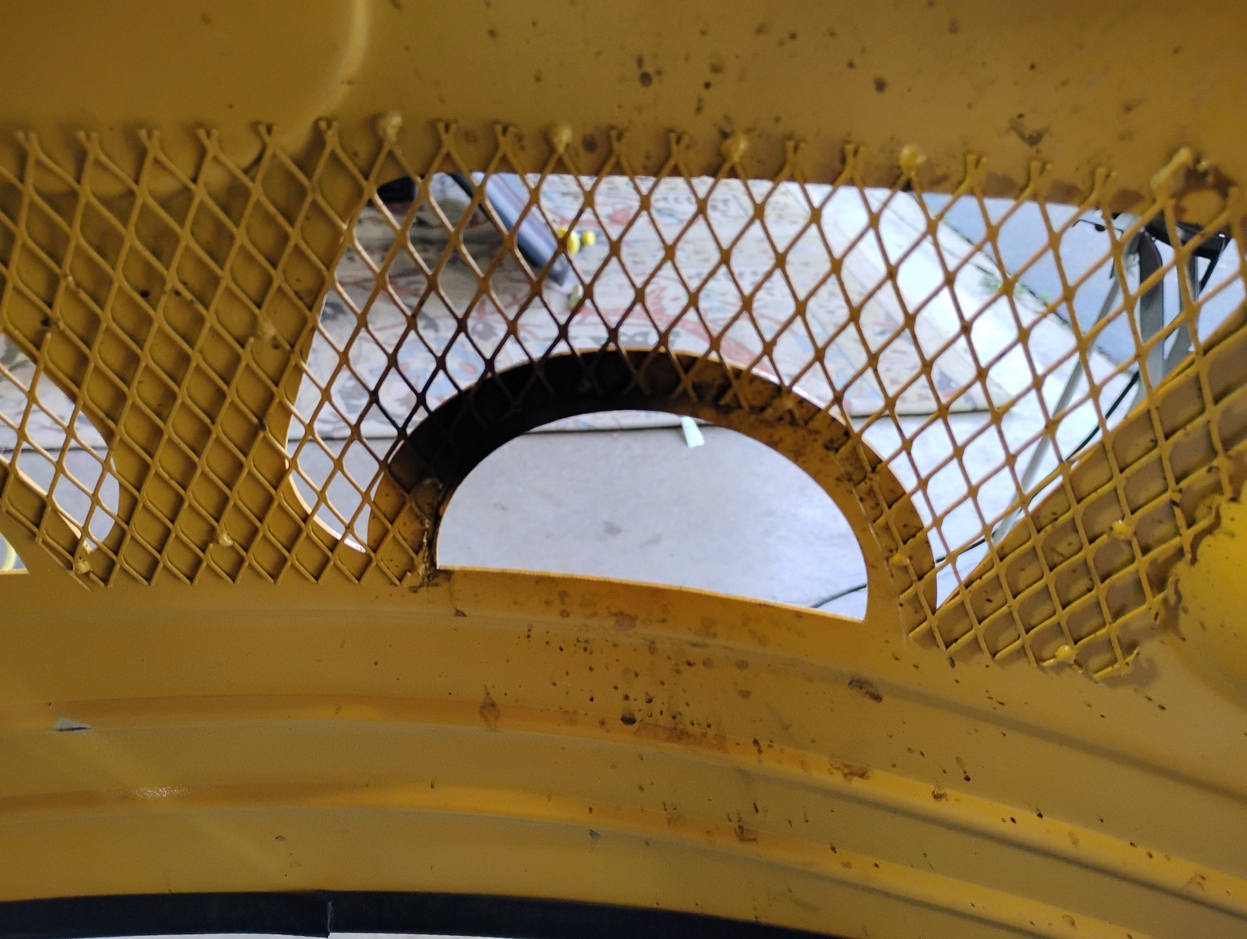

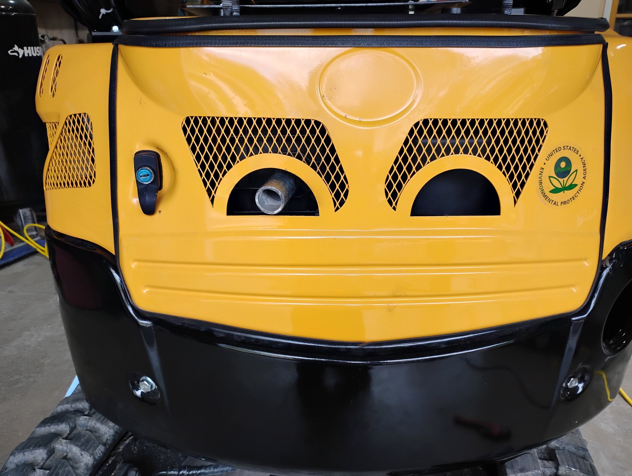

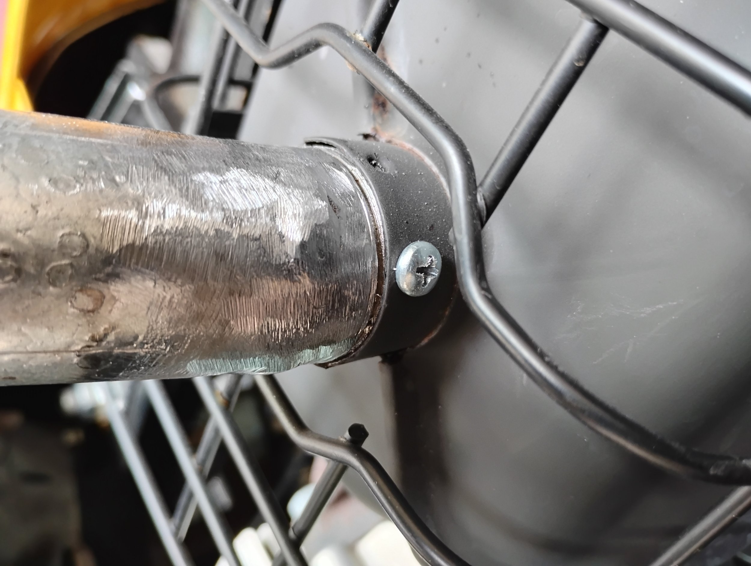

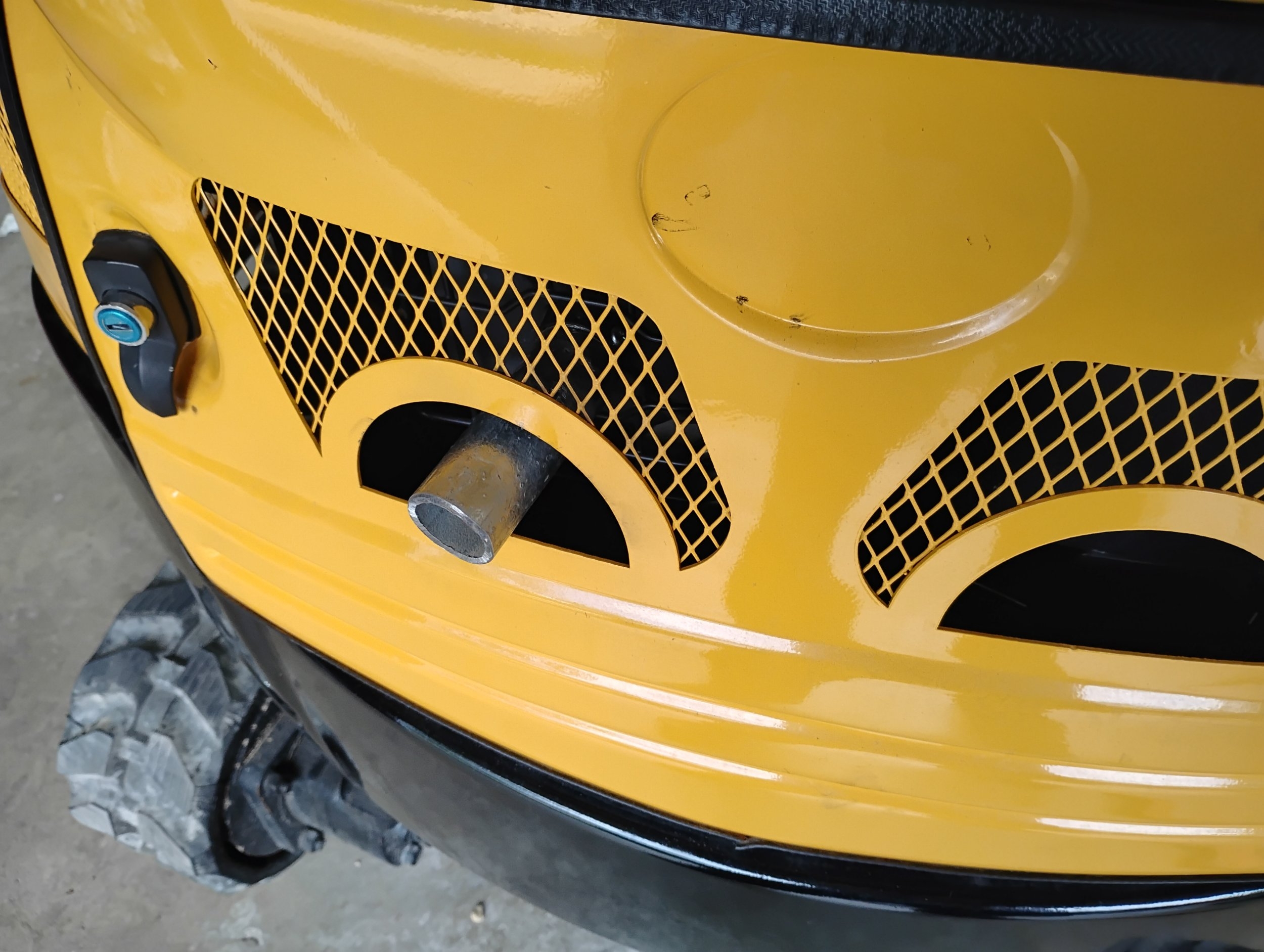

I noticed the exhaust was blasting against the rear door of the mini due to the muffler outlet being short and not aligned with the cutout in the rear door. This was causing extra heat buildup and unwanted noise in the engine compartment. It has the BS 420cc
A piece of 1in galvanized pipe was just a bit too large to fit inside the muffler tip but after a touch on the grinding wheel to dull and taper the threads, it fit perfect. Next, a slot was cut in the pipe most of the way through then bent, cut and bent again until the angle of the pipe allowed it to align with the center of my door cut out. Grind off the galvanized coating in the weld area and weld it up.
After threading it in, a pilot hole was drilled and a self tapping screw was added to keep it from vibrating loose since it's not really threaded in.
It was already pretty quiet, but it's even better now.
That's a step in the right direction.
Note that the stock muffler also puts out a ton of heat, and it is completely enclosed inside the house.
The off-the-shelf screw-on mufflers I have used are not as quiet as the OEM, and they DO have to be unscrewed to open the rear door or panel, but they do work even better for heat removal.
I can operate my machine without hearing protection, but I may upgrade my muffler to one of those larger rectangular ones commonly seen on 5000W generators.
