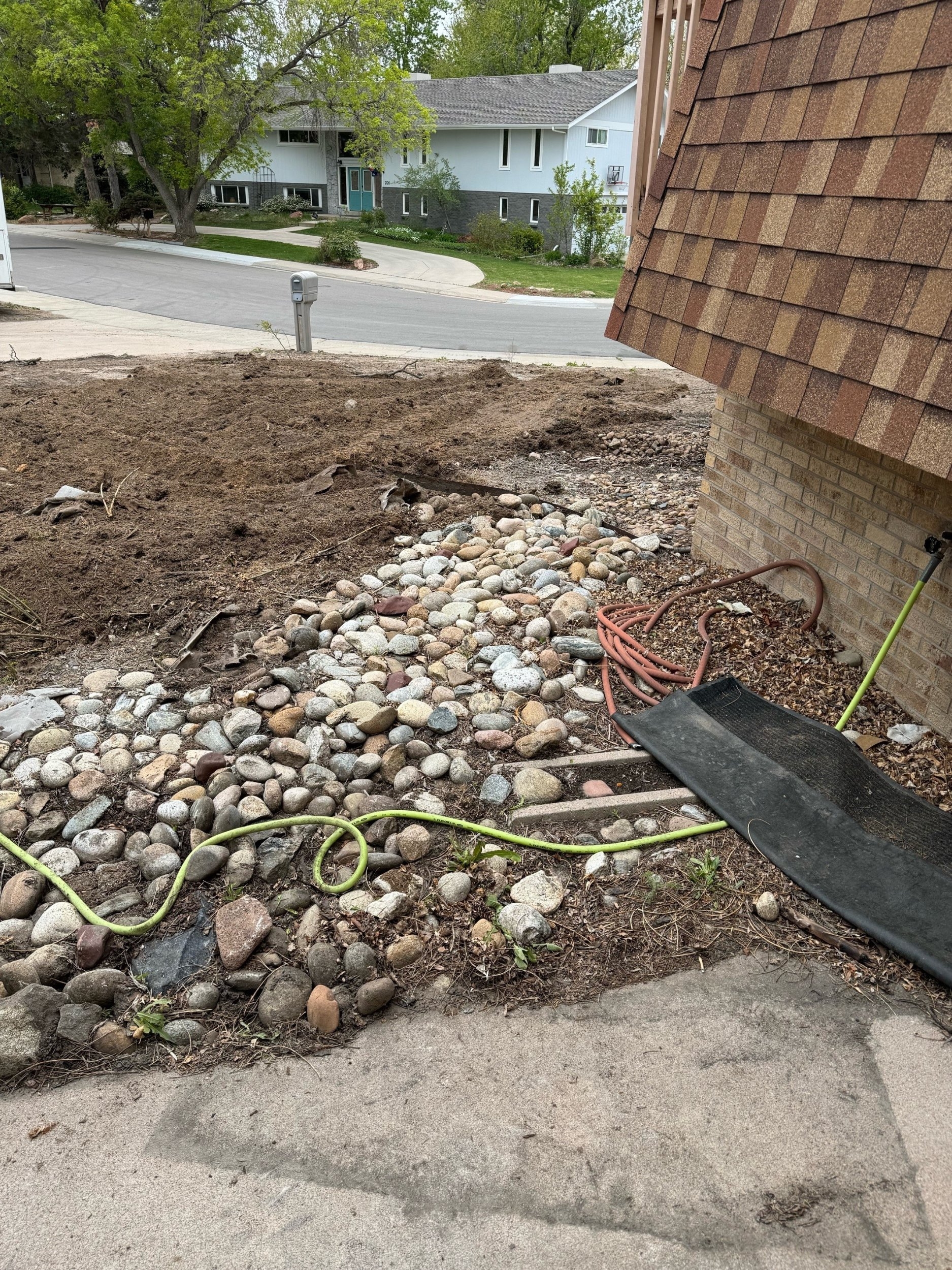

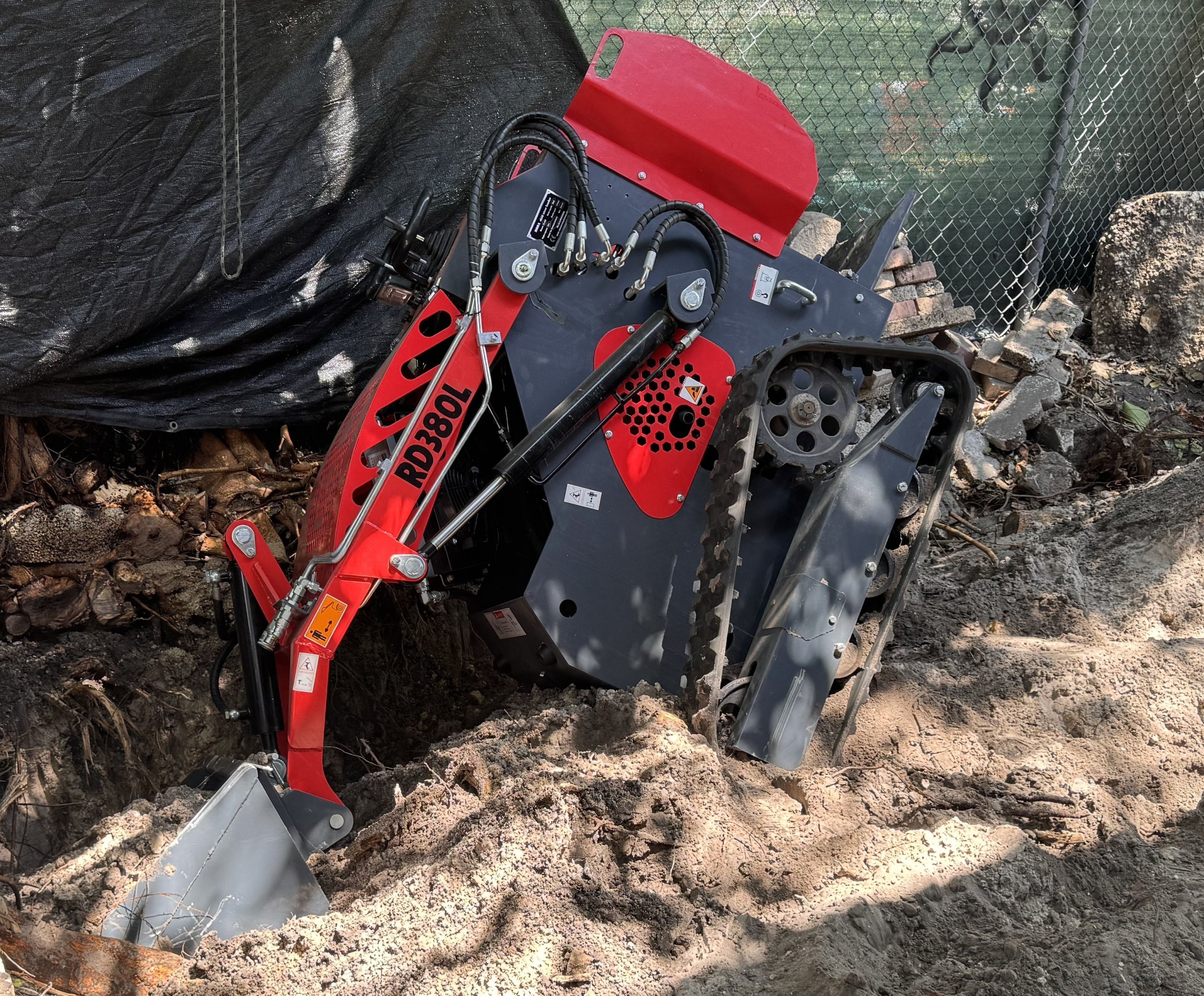

Also had issue moving period - there doesn't seem to be enough power and could barely get up a slight incline (picture attached).
   / Importing and modifying a new mini excavator from China
#1,322
Almost all these machines have their system RV set too low. How to fix that is early in this thread and on Utube:
You want 2400-2500psi.

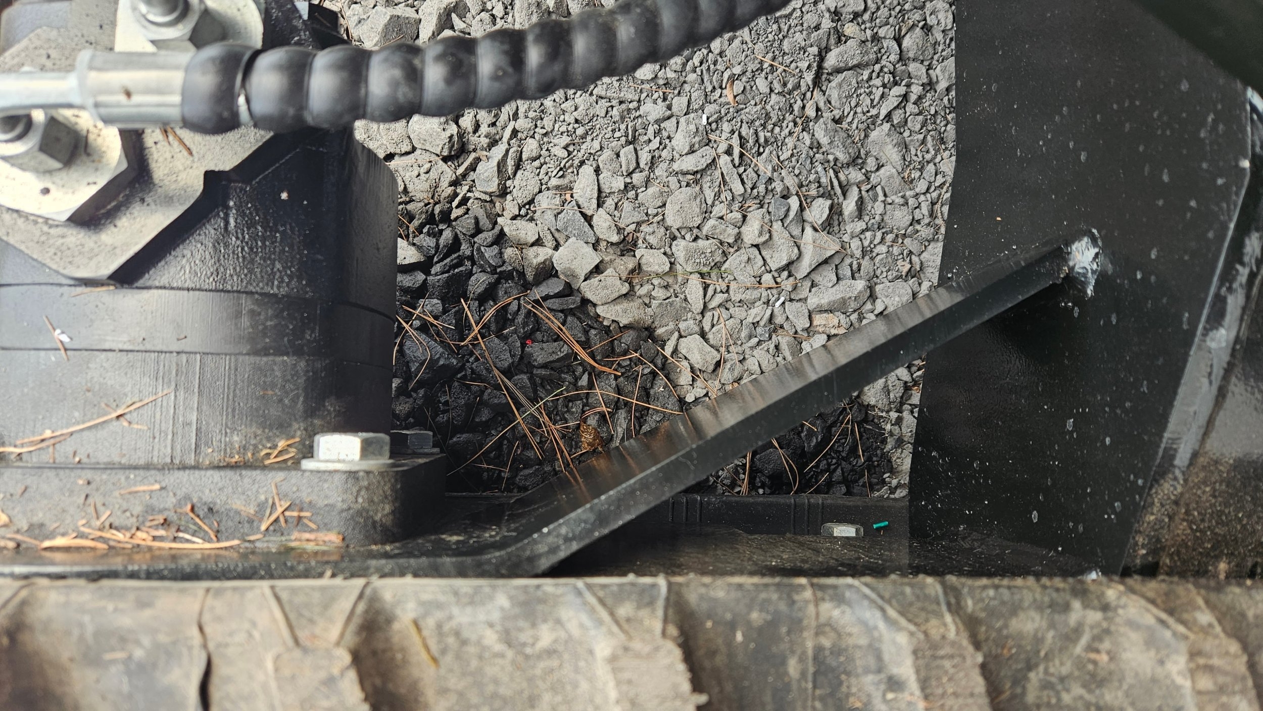

I remember a comment about the EM15 having weak track motor mounts that could bend inwards or outwards. Here is a pic of my 2023 EM15 which seem to show a plate doubling the motor support as well as bracing inwards toward the house support.

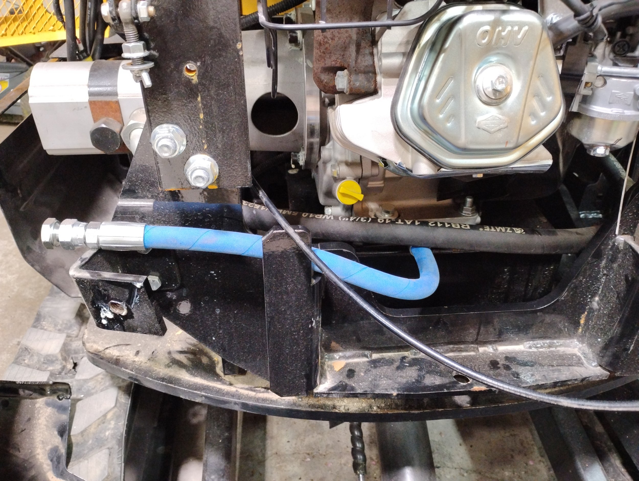

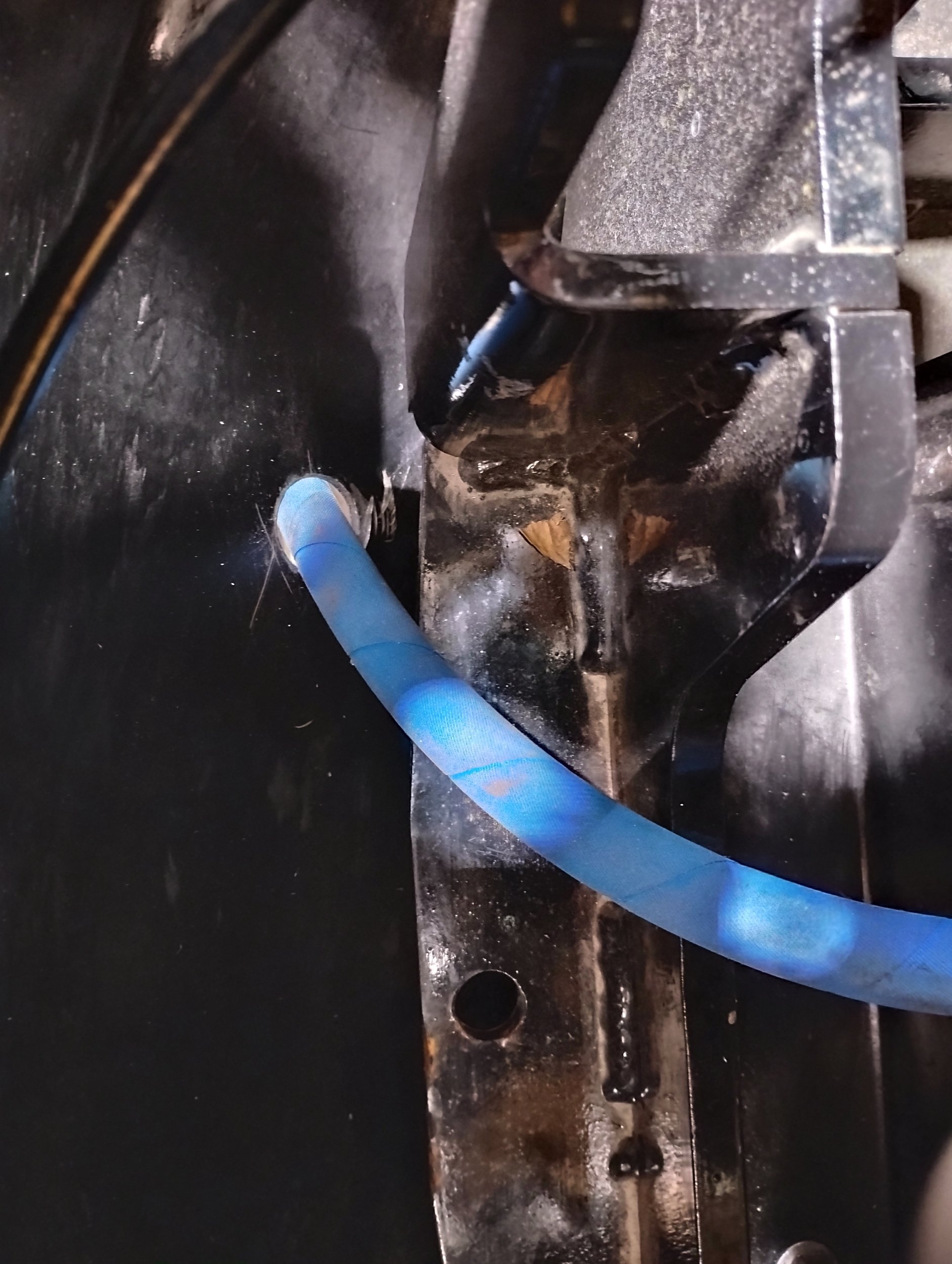

I ordered and installed the oil drain hose. I'm pretty happy with it I guess. I plan to keep it stowed inside the machine and feed it temporarily through a hole that was drilled in the rear bumper when it's time to change oil. Hopefully it will be less messy this way.

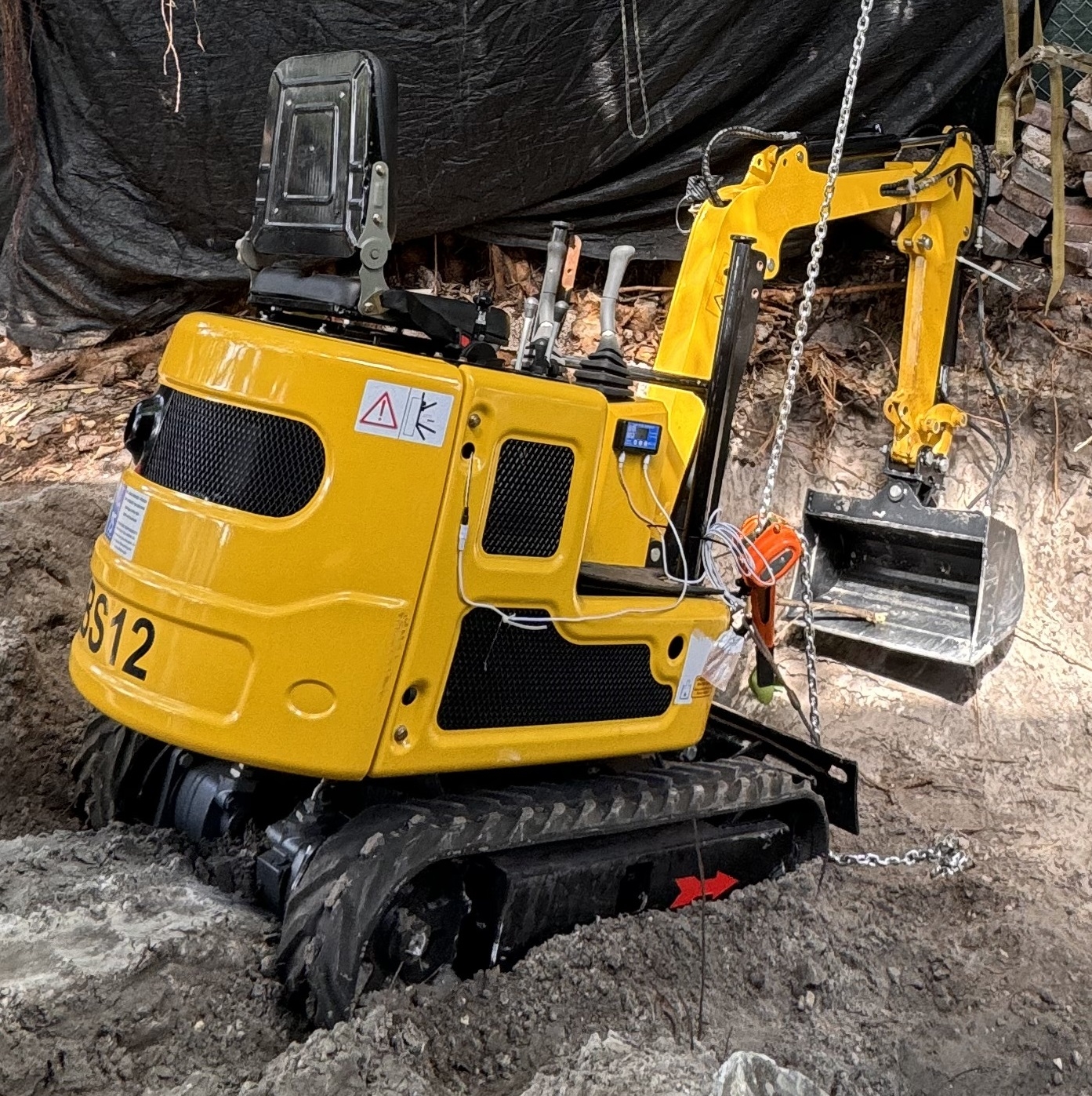

My experience with cheap Chinese mini excavator and skid-steer: I recently got a $6k no-name skid steer and a $10k no-name mini excavator. I also got a bunch of attachments online: a hammer, wide bucket, and an opposing thumb.
#1 issue is that purchasing them is very tricky. Specs are murky, sellers avoid straight answers, and the credit card dispute is often the only way out. E.g. One Chinese seller, after accepting the full payment, claimed that it was only a 50% deposit, and demanded twice as much, etc. I was able to find a third-party local seller, and purchase them as-is, for cash, picking them in person at the time of payment.
These are gasoline-powered due to environmental regulations, which makes them inferior from the scratch. Controls are very jerky, which is typical for any such gas-powered equipment that doesn’t come equipped with sufficiently heavy engines and flywheels. I knew only one gas-powered one that operated well: it was one of the first Bobcats with a huge Wisconsin engine. Diesel is the king for such equipment.
These gas engines run at high rpm to compensate for their weakness, so they are prone to overheating. The newer equipment comes with electric fans fit in their enclosures to cool them.
Their weight is insufficient in comparison to the offered power. It needs to have back ballast added, but the market does not seem to offer any cast steel ballast plates. The good thing is though, it could be easily transported on a back of a 1,500 pickup track. The bad thing is that they are very unsafe, I had them roll over more than once.
After only 5 hours, both track rollers disintegrated, with blocked bearing that basically fell off. I found no replacement track rollers commercially available so far, so they would have to be produced custom. There is no service, no service manuals, nor any parts available.
There are no grease fittings, and when replacing a bucket after approx. 10 hours, the bolts were already badly scored, as apparently there was too little grease to begin with.
There are no filters. Neither hydraulic, nor fuel, none. You got the idea. It’s a throwaway product.
Engine stops at even the smallest incline, probably due to crankcase oil sensors, as adding oil helped slightly. The photo of the excavator illustrates the incline at which I had to hoist the front to restart it.
Hydraulic power dies on a very small downward slope, due to the hydraulic reservoir installed low in the front, starving the pump.

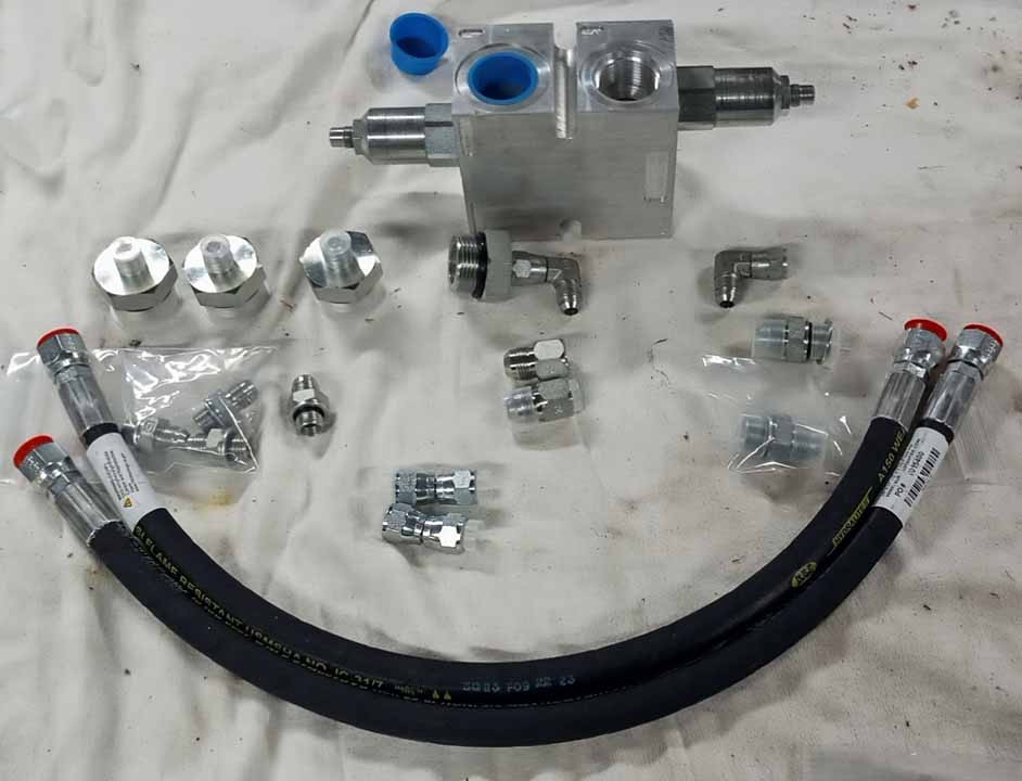

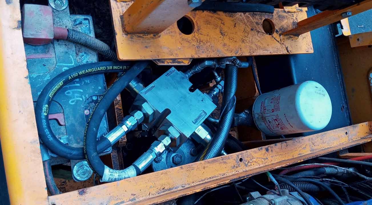

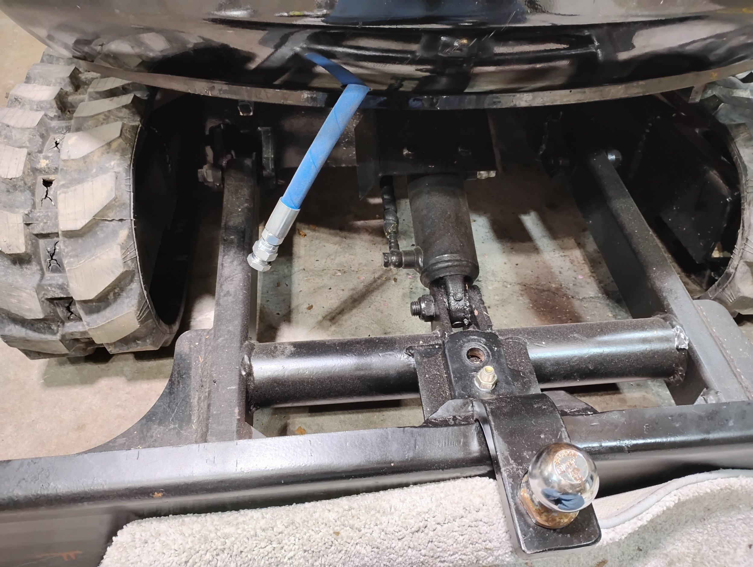

My house motor cushion valve is installed and working well.
The Danfoss dual-crossover RV I used came pre-set to 1500psi. I turned both RV adjustors in one full turn as an initial setting. I was shooting for 2000-2200psi. This work-port relief setting is hard to measure with a gauge.
The parts I needed are shown. The best cushion valve I found for this project is from Summit Hydraulics, and runs about $100. I landed the too-large valve in the photo for half that, and I made it fit. The installation was tight, but it worked.
I used this opportunity to check hoses for wear, and add even more wear protection. Plus I cut up the floor panel so I could get it off without removing the ROPS.
I see that Cam of centraldiggersupply.com now offers a kit to do this, for $250. I think that is reasonable, and he uses the smaller valve.
