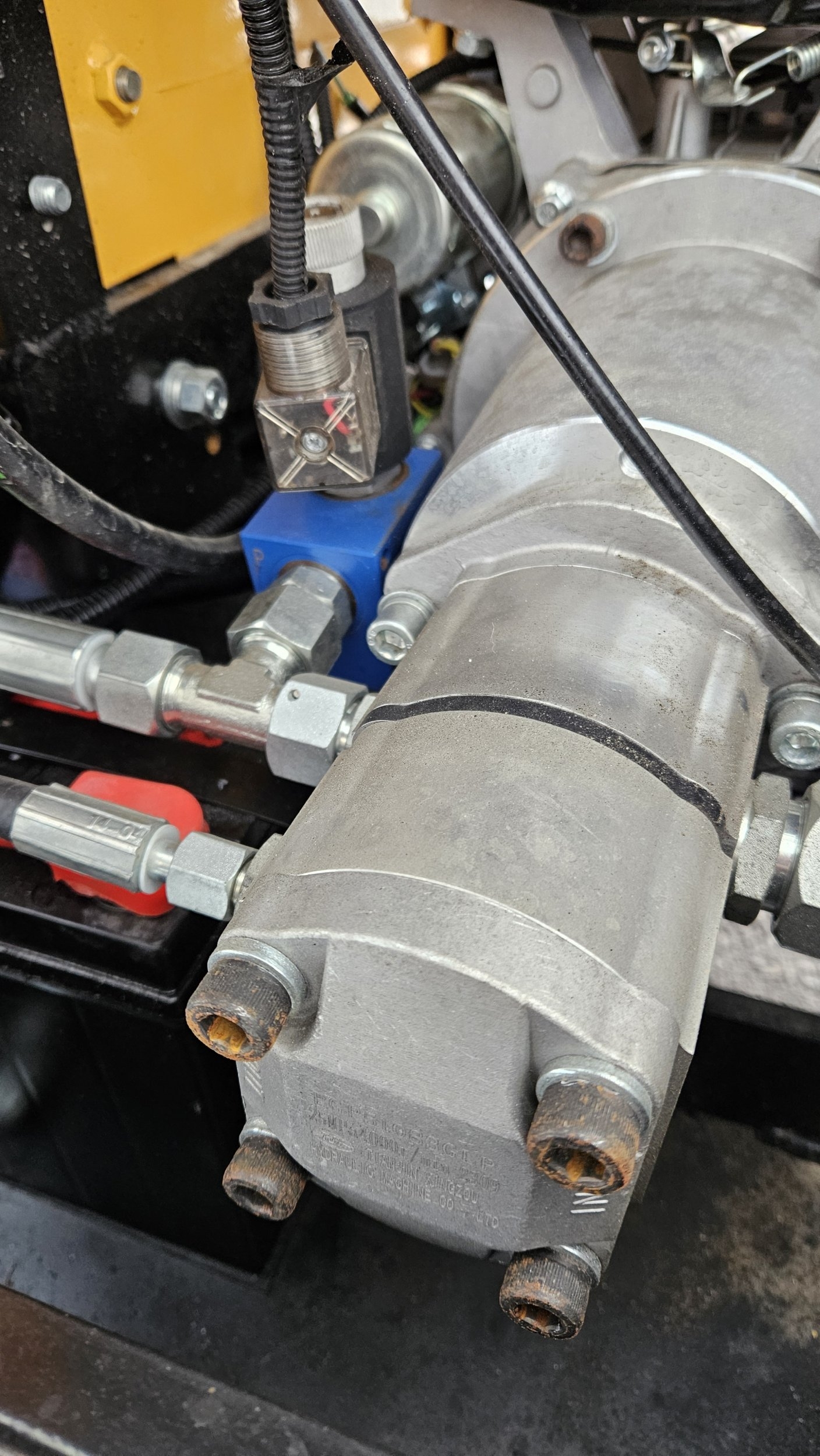

The accumulator is there on the attached picture behind the flow diverting valve, just above the silver solenoid coil, on the left side. That valve body has both a solenoid and pressure relief valve on top...what would it be called in hydraulic's lingo?
The blue solenoid, located at the pump's output in the second picture, bypasses the first pump chamber back to return rendering both tracks and foot controls useless. The silver solenoid on the pilot control valving, in the picture attached, disables both pilot controls (joysticks) so all functions are disabled when the operator's console is in the up position.
OK, I see the accumulator now. Now you gotta open up the cylinder on the right to verify it is a filter.

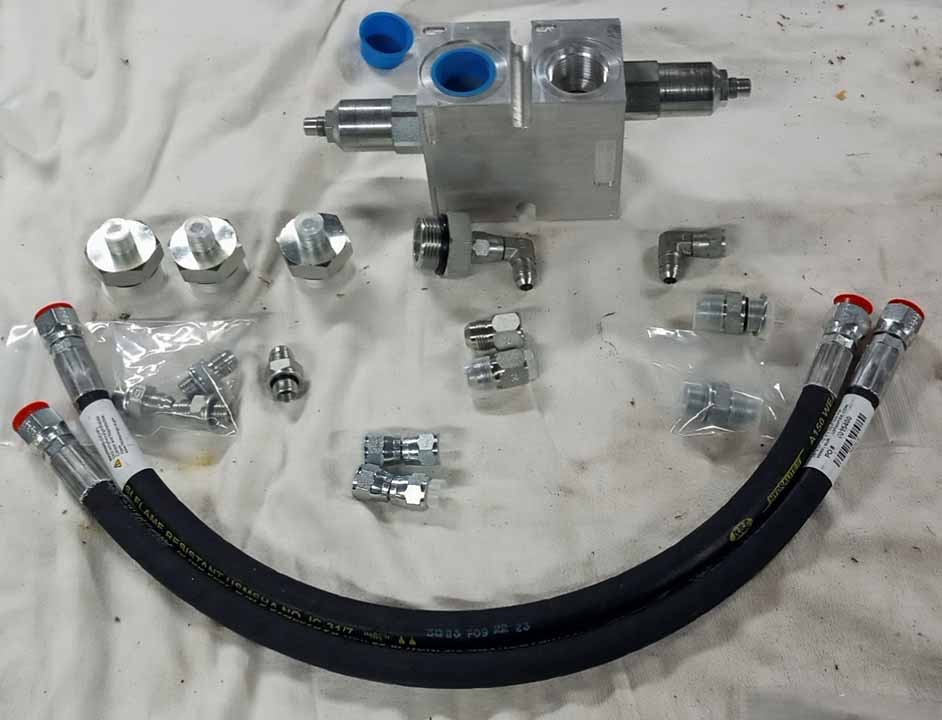

Well, it has taken a couple of weeks, but I now have all the parts I need to install a double crossover relief valve (cushion valve) in the house rotation motor circuit.
Metric adapters and hose ends still seem to be tough to find in the US, and very high-priced. I used 4 different sources for these parts, as well as a few from my own collection.

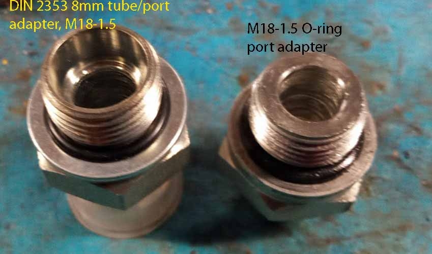

Those of us who have lived JIC, NPT, ORB, and ORFS can get confused by all the variables in the metric world. There is DIN 2353, which is a tube standard used throughout Europe and Asia, but there are other metric standards that use O-rings. Photo is a DIN Light L08 M18x1.5 adapter (for both ports and 8mm tube) next to an M18x1.5 port O-ring metric adapter. Both same thread, but latter can not accommodate hoses with metric ends, as those use tube-style connections.
Not only are there confusing similar port/tube metric adapters, there are Light (L), extra light (LL), and heavy (S) versions. Don't buy the wrong one.

When these metric fittings are threaded into a port (valve, cylinder, etc), it uses either a copper washer or a dowty washer to do the sealing.

Here are my parts for the cushion valve project.
Other Chinese minis may use different size hoses or ports, so you still have to measure everything with a caliper. My philosophy is to convert hoses to ones with female JIC ends, then adapt to the required metric size. The hoses in this photo were standard 24" from SurplusCenter and only $12 each.
I know what you mean by the bonded washers. I have seen them, but did not know the name, Dowty. The one above uses a separate washer and O-ring, however. Are the adapters specced differently, O-ring vs. Dowty washer?
