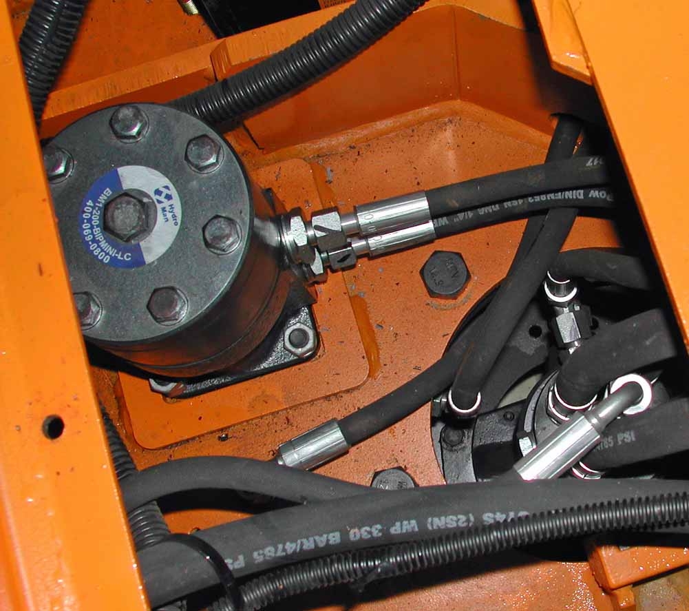

Could you turn camera on and slide it under the digger and then wiggle the house? Or use a selfie-stick?
I would be impressed if the hoses allowed the movement we see.
Very interesting, must be a recessed bolt in there. Or a set screw up above the gear?
I will figure out a way to get a better vid.
I think what we see in the photos is the shaft of the motor above the pinion gear, so no room for set screws.
In this photo, you can see how the motor is mounted inside the house. There is a square weldment that limits the movement of the motor if it comes loose. Not only did they use double-nutted bolts here, but they mostly seem to be grade 12.9. They did not seem to cut too many corners here. Other makers, maybe not.
Accessing the heads of those motor bolts for removal will be difficult.

Both are certainly possible. I suspect the mesh is the likely culprit. I have considered removing the swing motor and enlarging the mounting holes so there would be a little adjustment possible. Then push the motor a little closer to the ring gear to remove the slack. As the weather here improves, I will be more involved with some repairs.
I also think slop in the keyway of the pinion gear may be the issue.
I took my house motor off months ago and video'd that the slop was internal (posted here and also found on my chan). Zero perceptible play in ring/gear mesh or gear/keyway/shaft. All internal to motor.
Slop in motor (and boom/dipper) have grown after >35 gal gas hard use. So now having a new spare motor eventually I'll swap in fresh and fully disassemble old to see more precisely what is likely just poor tolerances internally.
The fact swing function runs full pressure on these if fun but they take wear fast (esp under abuse like using as a battering ram lol).
Also soon time to add oil cooler and fan, and attempt to take up the little slop that's also developed at the dipper and arm joints. I got pins but missed getting the corresponding (removable?) bushings these apparently use at all pivots.

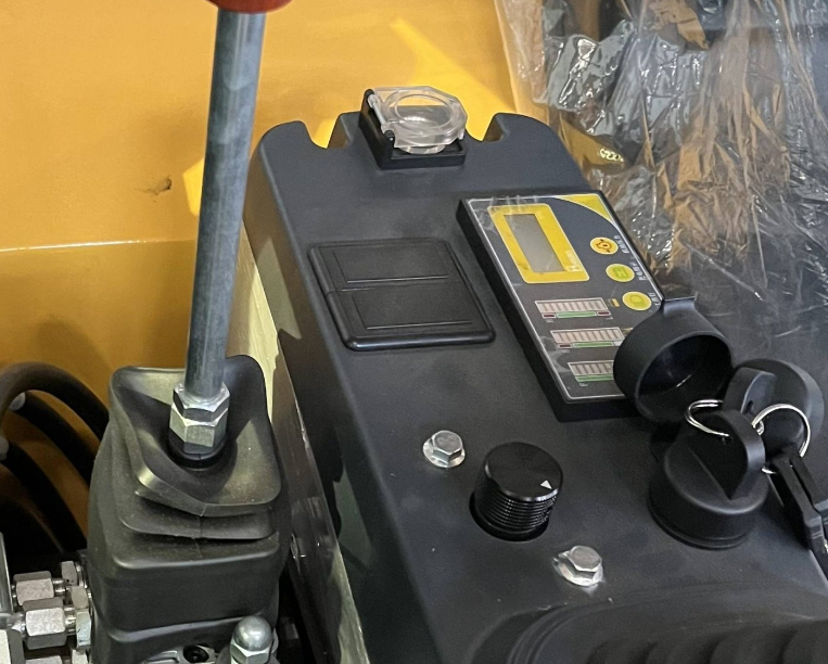

Your first image looks interesting to me.
Is your digger electric?
Mine is, and this side almost looks identical. The potentiometer is for the electric motor for the hydraulic pump; while the lever is for lowering the blade, and widening the track. All same colour, position and form.
Could you please share an image of the control/display panel and mention what the gauges are showing? Thanks.
Uh, no not electric, sorry I've no idea what you are on about!
I literally have zero gauges, potentiometers, or even 'control' panel. Not even an hour meter bud!
Congrats on the E-digger, perhaps ours are similar base machines - it would be fairly simple to substitute one power plant for another in this case and with any of these machines.
When I checked prices they were a bit too steep for an 'E' setup, but would (and could) fairly easily convert after sourcing a good motor and motor controller setup (assume they are using 3 phase sensored DC motors).

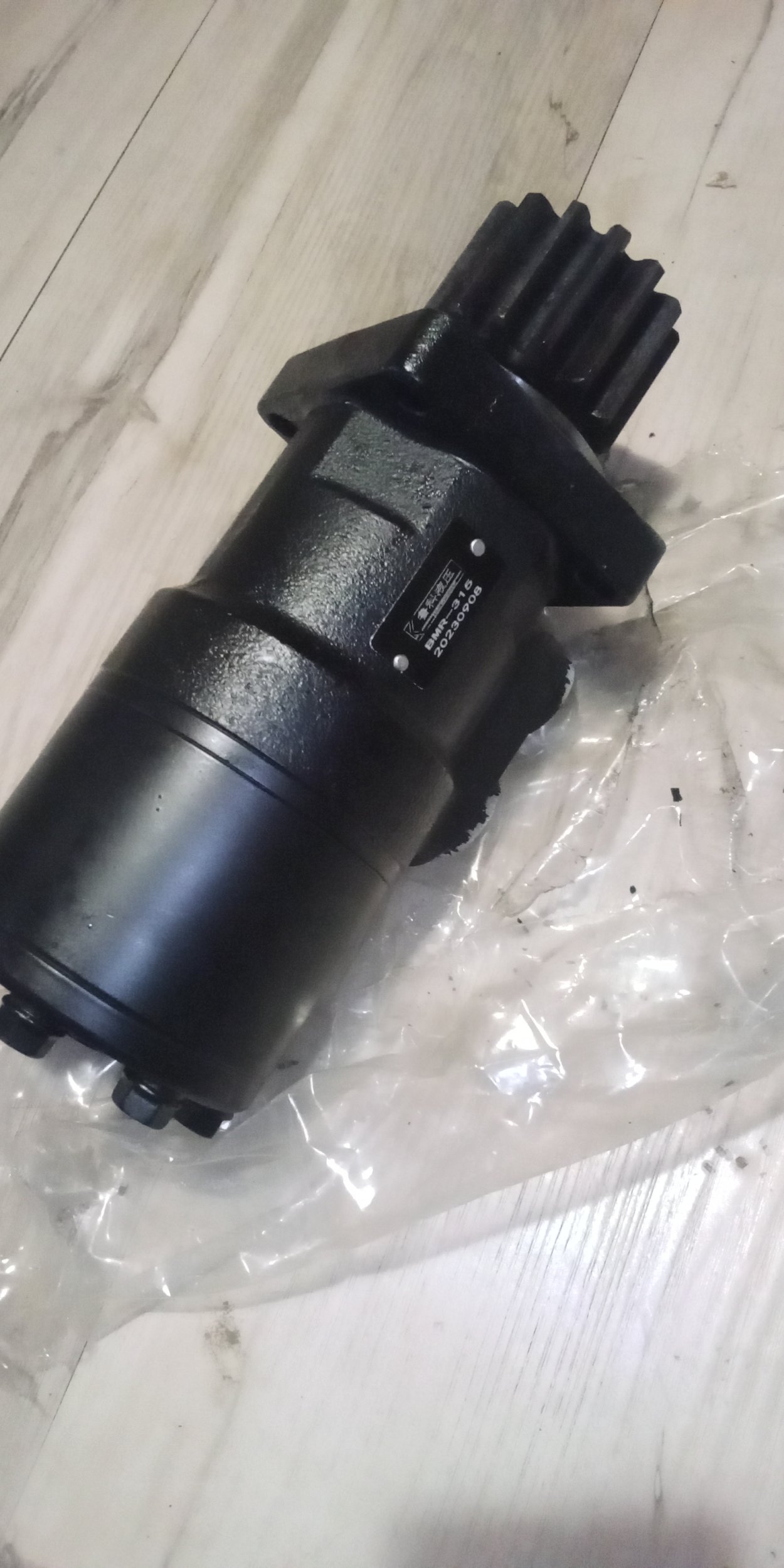

Bolts/ motor came out and went back just fine. Key/ keyway appear same.
You have not replaced any inserts yet? IIRC you said <100hr on yours.
Mine look kinda soft like brass - not ridiculously worn but joints aren't near as tight as new. Inserts prob softer than the pins. Would prefer to use whatever manufacturer used but might check generic bushings/inserts thanks. Tolerances have to be kinda tight ID and OD
You have this potentiometer next to the ignition key. What is it for?
   / Importing and modifying a new mini excavator from China #1,258
That's not any picture of mine. No I def don't have any poteniometer on the machine. Highest tech thing is a solenoid lockout for pilot control down on the main valve body
   / Importing and modifying a new mini excavator from China #1,259
That's not any picture of mine. No I def don't have any potentiometer on the machine. Highest tech thing is a solenoid lockout for pilot control down on the main valve body
OK then... The whole arrangement looks eerily similar to mine... where this potentiometer controls the speed of the electric motor.
The lever on the left (in the image) adjusts the track width and moves the blade.
What is weird in the picture, is the 'engine start' button at the end.
The yellow is the same on mine, and the metal is bent at the same location.
Anyway, thanks for the reply, well never know :)
