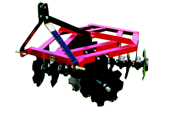

I have this 4' Howse disk harrow and I highly recommend it. I have not seen many larger disks for bigger tractors that work as well. This disk has a lower set of holes in the gang holders that lower the frame and match up great for the 2200. I used mine this fall to disk up about 10 acres of food plots and all that saw it work were amazed. <A target="_blank" HREF=http://www.howseimplement.com/>http://www.howseimplement.com/</A>
