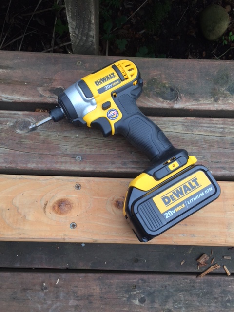

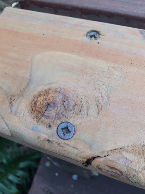

Thanks Bruce for starting this thread. After reading... I purchased this 20V Dewalt Impact Driver this afternoon.
DEWALT 20-Volt Max Lithium-Ion 1/4 in. Cordless Impact Driver (Tool-Only)-DCF885B - The Home Depot
First impressions here: Replaced a rotten tread/step on our entry deck. Removed 6 3in rusty deck screws and reused them through a treated 2x4 outdoor wood. This thing had absolutely no issue, easily sub flushing all but one that I decided to drive too near a tight knot. Didn't think it would handle it but got near flush. The LEDs are bright and the balance is nice and steady and feels solid for such a compact driver. Quick disconnect chuck sweet too.
Don't know how I have gotten by without such a tool. :duh: Not sure the rest of my drill/drivers will see much action going forward.
