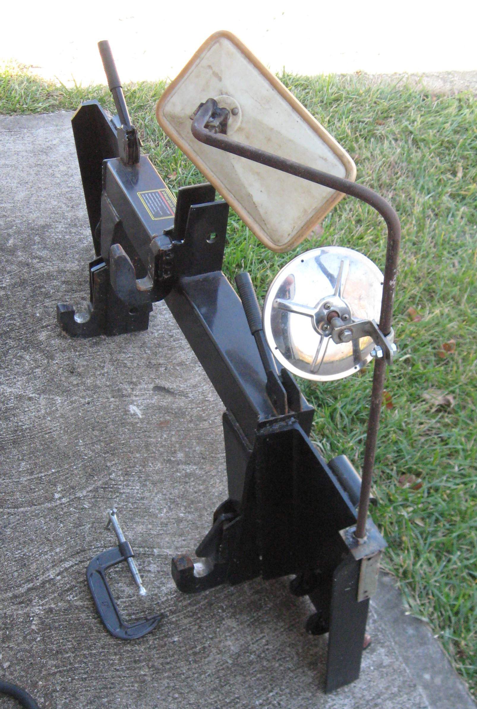

I am thinking about getting a imatch. I wanted one with the fixed tophook. A dealer said yes we have one and I got there and was the adjustable tophook. Has anyone had problems with the imatch with the adjustable tophook not working on any implements? I am concerned that the bolts and where the tophook bolts to may interfere. I had to extend the tophook on my harbor freight QH to make it work with my Woods LR72 and RB60.

I have both styles. The new style with the adjustable hook is a pain in the butt. As you said, the bolts & bracket interfere with hooking up implements that hook up fine to the old style.

Do you find that the bolts themselves are the problem? My thought was to remove them and weld the hook in place... if the bolts are the problem.

The problem is with both the bolts & the brackets. I believe the hook needs to extend farther out beyond the brackets. The new hitch has to be centered perfectly to get the top to hook.

If it extend 3/32 or a 1/8" it would be perfect.

I suppose I could have another hook plasma cut, or just move it out, weld it in place, and get rid of the bolts.

Any of that would work. I extended the one on my harbor freight QH. It was really bad. Depending on what implement it is you could elongate the bolt hole for the top link link bushing to move it forward.

I have the old style JD Quick Hitch, but have an adjustable HF quick hitch that I use for my front mount. Had the exact same problems wth the pins interfering with attachment upper link. I wound up having to cut the pins off and puddle weld them to get rid of the protruding part. That solved my problem. This leads me to think that I would rather have the old style JD quick hitch.IMG_1591B.jpg

I replaced the bolts on my V2 iMatch with pins and gained enough clearance so that it works with my box blade. The added plus is not needing wrenches to adjust the hook if needed.
