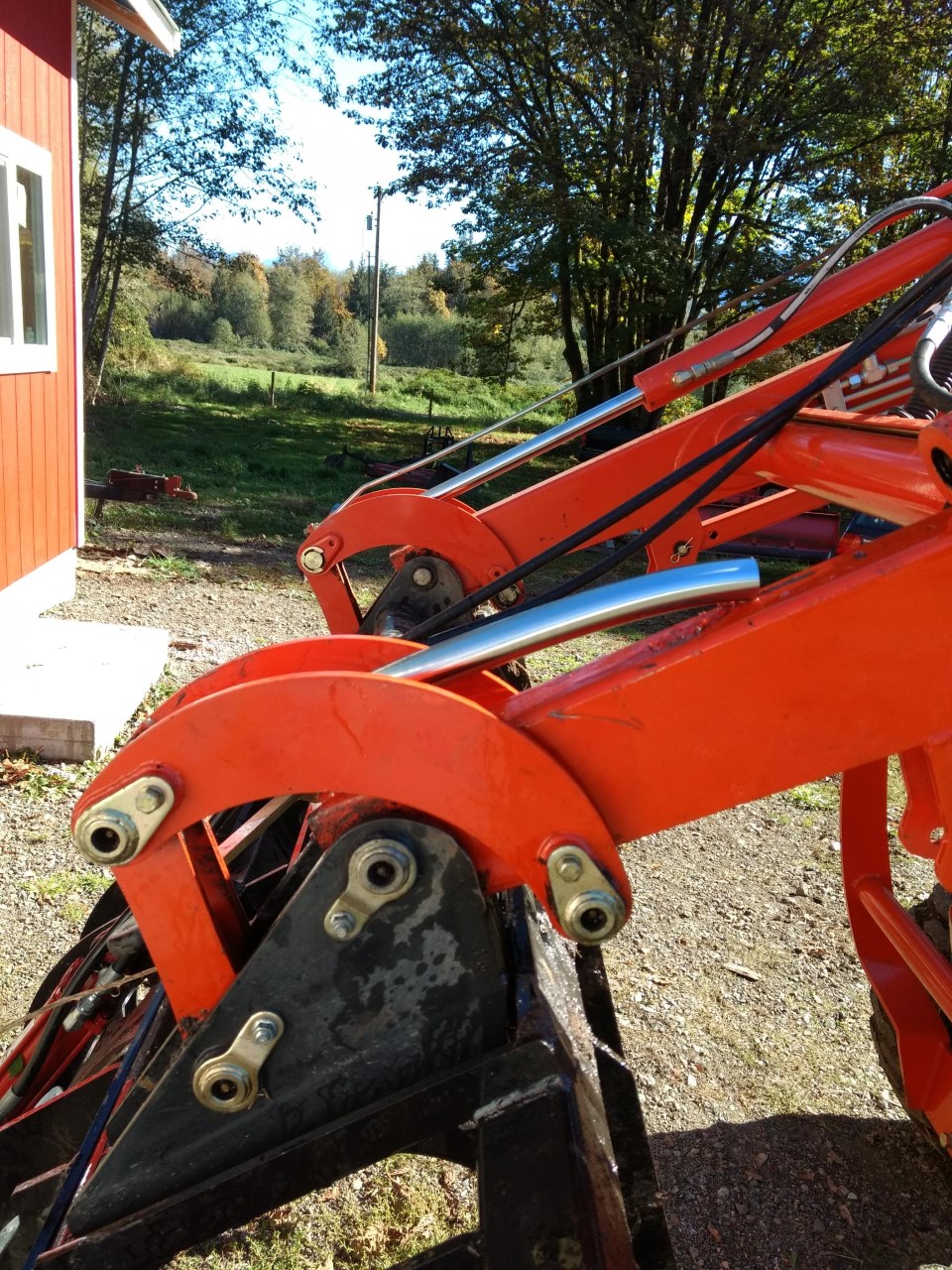

OK - $300 turned into a pipe dream. As it stands, because the rods need to be replaced, I may as well buy new ones.
What I want to do instead: Buy off the shelf cylinders on 1" pivot pins and use bushings to get these to fit into the FEL 30mm pivot mounts.
THIS is what I think I know:
Cylinder diameter 2.16"
Stroke 20.67"
CrossTube Pivot Pins 30mmx121mm & 30mmx100mm
Flow 10 GPM
Rated 3000 PSI
What I cannot locate is ... the Retracted and Extended length of the Kioti cylinders. M3245-41211
Anybody have this info???????

Ok, What is the rebuild price? I'm still thinking its the best course of action.
On stroke, I'd probably articulate the loader and measure actual installed requirements.

Rebuild was pushing $600 each. As for "articulation" ... on rod is snapped and the other is bent and inoperable.

I can get new 20" stroke cylinders for about $200-$250. While the stroke is ".67" shorter, I think I can live with that. I would like to know the retracted/extended length of the factory parts just to be sure I don't exceed those specs in the process.

Remove the cylinders. Articulate by other means.
If I were you, I'd write the $1200 check.
Why would you want to put the cheapest possible non-OEM cylinders in place of what you know works (when you don't do silly things).
/ I'm not the only dummy #31
It's not about "cheapest." It's about ... these cylinders are not worth $600 a piece. That price is because it has a Kioti name on it. The same probably holds true for almost any brand.
I'm pretty sure I can replicate the performance for far less. I just need to know the specs.
If my "silly thing" results in pretzels ... well ... I'll charge it up to a learning experience and write the check.

We all do silly things. My loader curl cylinders are $900, i think $600 is fine. My biggest fear is bending my backhoe curl cylinder dragging out rocks and stumps.
If you get a bigger cylinder, will the diameter fit? Are the cross tubes about the right width. Do you need hose adapters? Also, price out the cost of the necessary new hardware and see how much that costs. For me, new bushings would be expensive as I'd want to buy a lathe and machine them myself. :)
Lastly. If you make the cylinders more robust, could you make something else fail?
Please update us on progress when it happens,.

Yes .. I've thought about the mounting complications but I'm hopeful. :)
Being tilt cylinders, over-build, doesn't worry me as much - but - I really don't intend to drift too far.
This is all still a work in progress, and I really can't move forward without the length specs. I'll try to get them directly from my Kioti dealer tomorrow.

Really? Try Kubota! A replacement cylinder on my Kubota B7800 was $700. The NX's was right around that price and it's a substantially bigger cylinder.
You messed up (sorry, but own it). Shell out and tell yourself that that's your penance for messing up. There's value in taking an extra hit: it'll stay in your head better than a cheaper replacement which you'll likely treat as cheaper.
$600 rebuild (shops that do these things are going to be better than new because they're hands-on; also have a local guarantee; AND, you're supporting local businesses; AND, you're recycling!) x2 is still $200 cheaper than new replacement factory.

No argument. I own it. I just don't want to own it TWICE! LOL
Looked for bushings today ... thought I had it ... 30mm outside - dandy ... 1" inside - .02 too small.

Your ego is going to cause you to chase your tail (don't let it!): I say this not in a demeaning way- believe me, I've been around the block on such things many times- figure it, as others are also promoting, wisdom. How much time are you going to spend trying to track down a match? Time is important (it's the ONE thing you cannot get more of).
/ I'm not the only dummy #38
It may well prove unjustifiably difficult to build this puzzle with off-the-shelf parts. If I had a few machine shop tools, this would not be such a challenge.
I won't agree this is ego driven - or that I'm "cheap." I can spend money like water when it suits me. This is more of a "Are You Kidding Me?" "How Much?" type of thing :)
You are correct ... it may be a complete waste of time. A few more days and I'll just order the ^$^%*#*%%$ things!

My little Branson has 1 1/4 inch pins on the curl cylinder which is around 31 mm so other manufacturers also use larger pins than 1 inch.
have you looked at dalton hydraulics website? They have a lot of cylinders shown but no clue if anything close to what you are looking for
