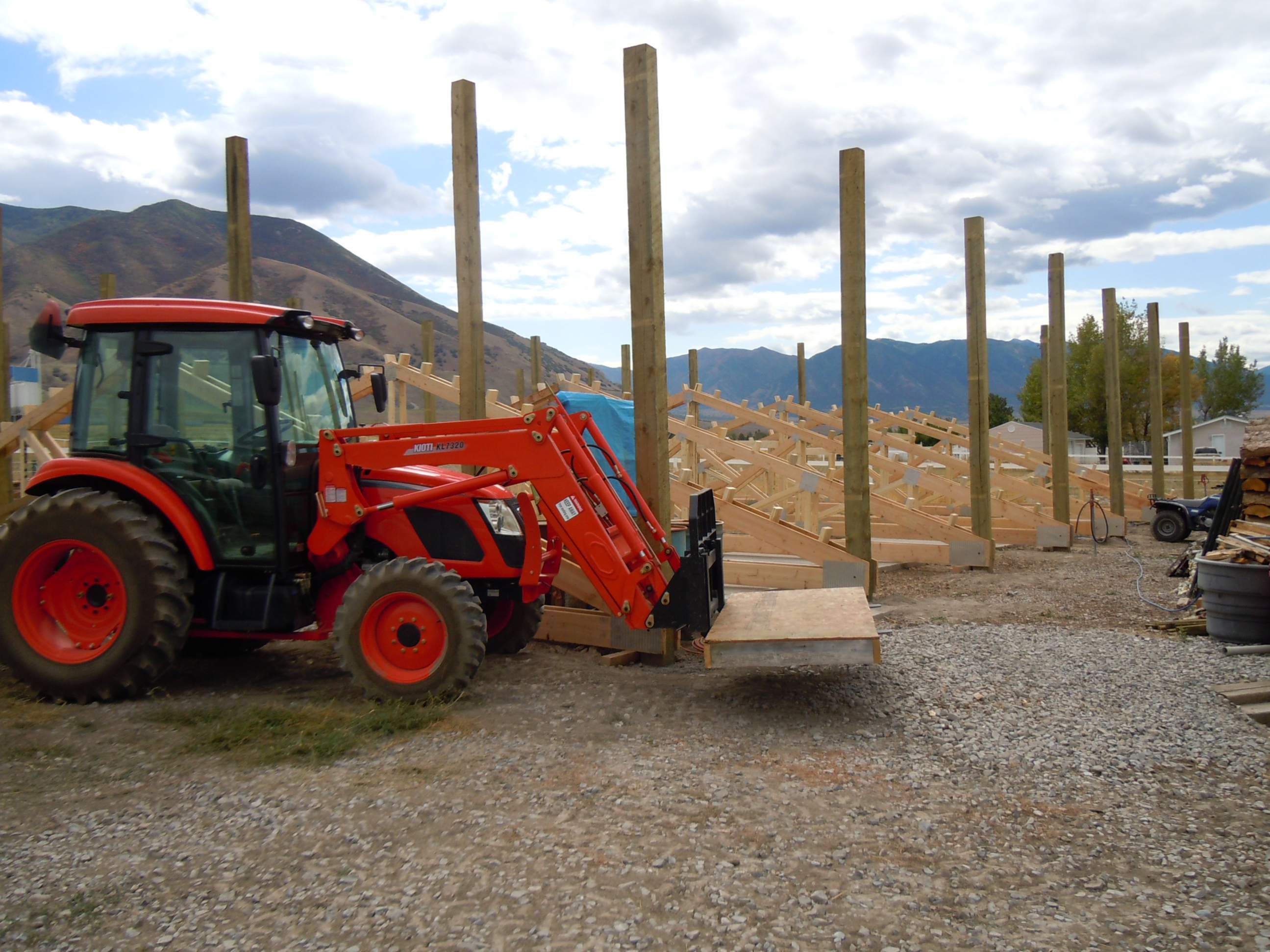

General,
I would suggest building a working platform. (if you have pallet forks) I built this one from just scrap wood before building my barn. It was used as much as any tool I had.

Yes, I plan on using my pallet forks w/ a pallet as a platform to work off of using my Kubota. Some work will probably be off a ladder too.
