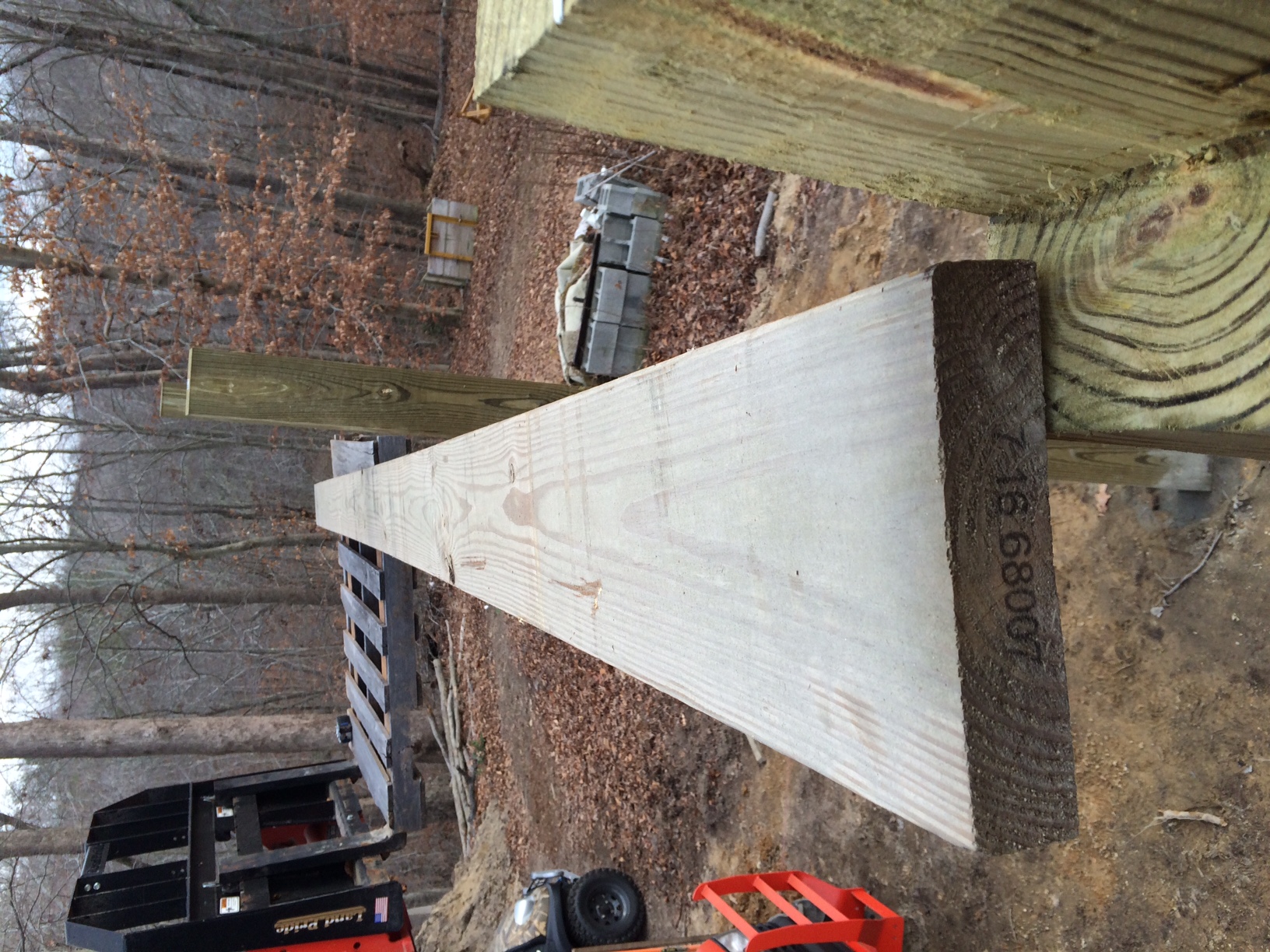

Well got the double header up this afternoon. Only had a portion of the day to work on it. For the notches I started with my cordless circular followed by the cordless sawzall, but as you said Eddie it was eating my batteries up. So I dragged out 150' of extension cord used the power sawzall to finish everything up.

Last Sept., I built my woodshed on the side of my already existing pole barn. Specs are roughly 10'x22' wide with the posts 9' from the pole barn.
I used 2x8's doubled as my header and 2x6' on 24" centers for my joists. I centered the 2x8s on top of the posts. I did not notch the 2x6's, just set them on top, then used those galvanized joist hangers to keep them in place. My 4x4 posts were roughly 7'-8' apart, depending on what side I lined them up to the existing 6x6's of my pole barn.

Ahh, thanks for the visual FTG. I will definitely be using the joist brackets/hangers.
