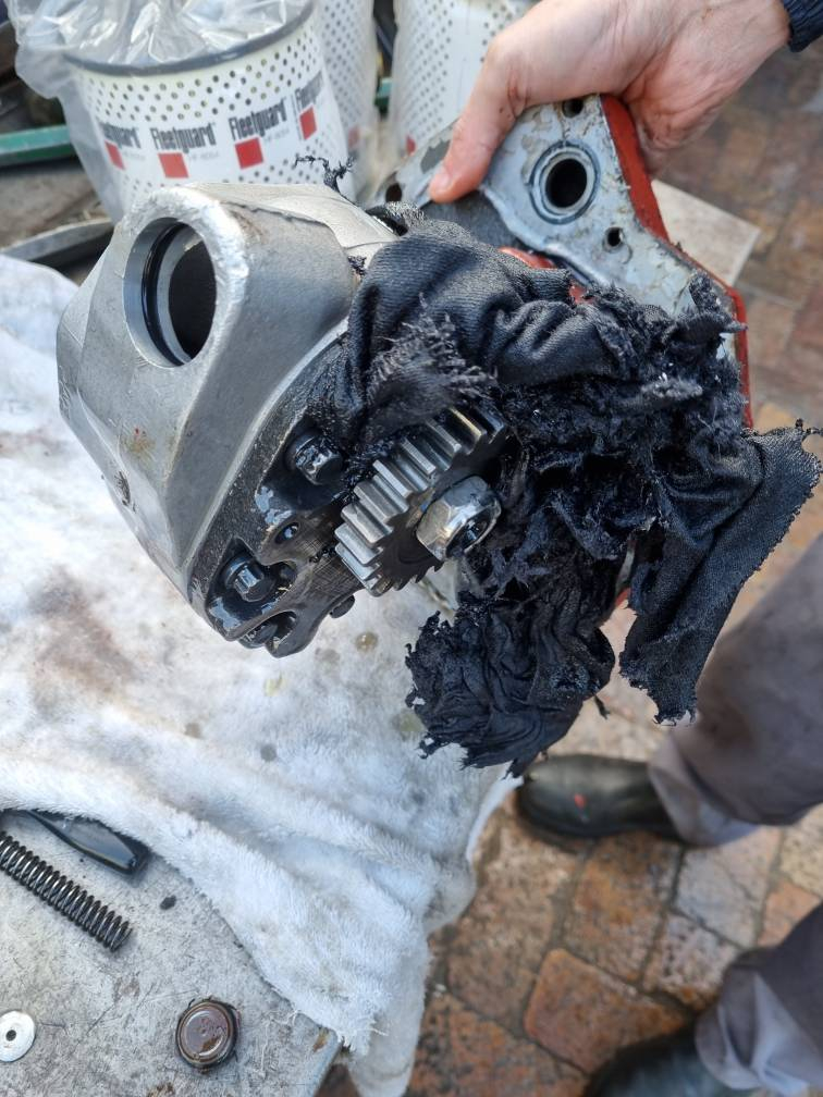

This tractor does not want to move . No forward or reverse.
I did check and replace the hydraulic filter. It was cloged up with some cloth. Someone before me left his cleaning cloth inside.
I also removed the charge and mainpump and had it checked out. This is the pump on the right side of the gearbox.
Then I removed the other pump just infront of the left rearaxle. There I found the rest of that cloth.
Then on some advice I removed the pto pack and stripped it. Its pick-up was block aswell and the plates was burned out. I overhauled it and that is working now. I do get oilpressures at the hidge and externales and at the pto.
No oilflow at the inching pedalvalve.
Help is needed please ?

Damn that is a shame that someone did that.
I always liked the Hydro 100 especially after a turbo gets added to them for more pto power.
An awfull lot of small ports that can get plugged up with fibers.
Good Luck getting her going.

At this port I do get 400 psi and I can adjust it more.
At the bottom testport I do not get any prssure

With no help I found these checkvalves fitted the wrong way. I am about to start this tractor and test it.

I looked at the pistures and found this pin shorter than it should be .
Will make one that will be longer and then test it

Congratulations, good to hear.
They were a nice tractor for general work and great on pto jobs.
I ran one a lot doing cultivation and irrigation couragations for flood irrigation.
