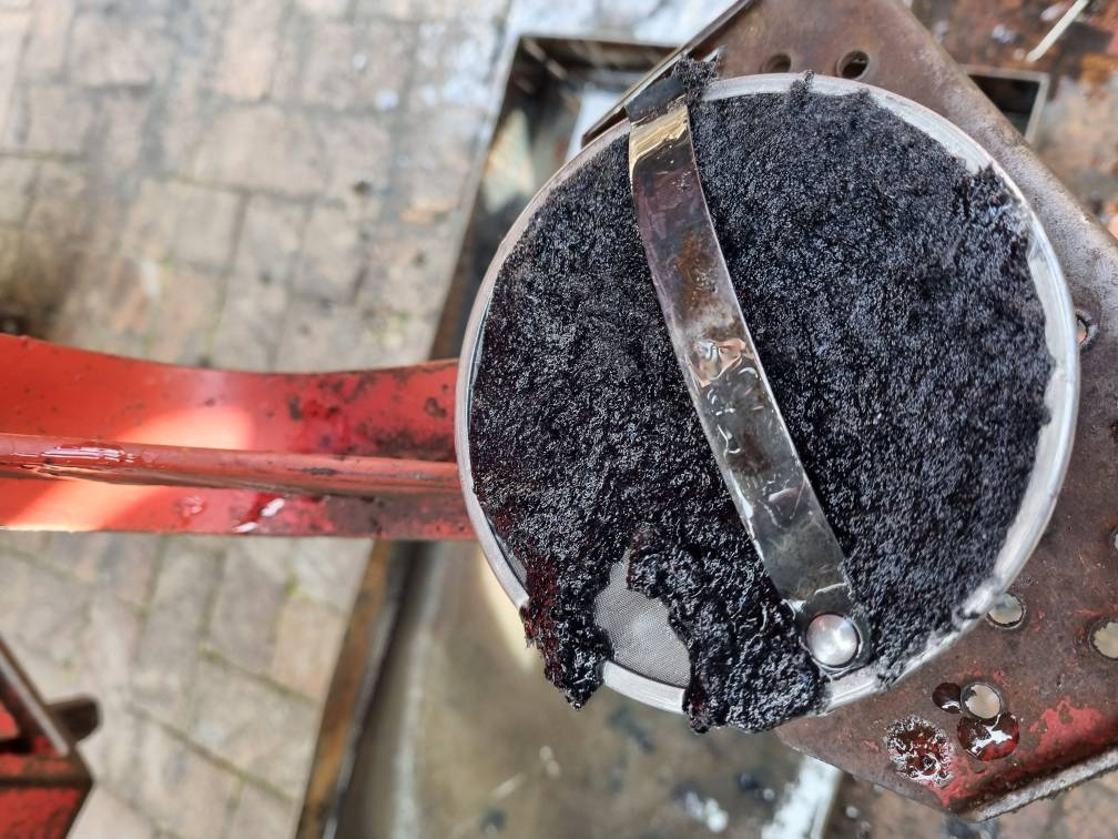

This tractor does not want to move . No forward or reverse.
I did check and replace the hydraulic filter. It was cloged up with some cloth. Someone before me left his cleaning cloth inside.

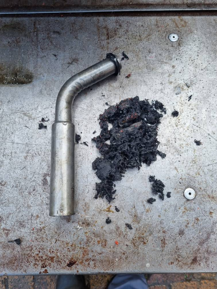

I also removed the charge and mainpump and had it checked out. This is the pump on the right side of the gearbox.
Then I removed the other pump just infront of the left rearaxle. There I found the rest of that cloth.

Damn that is a shame that someone did that.
I always liked the Hydro 100 especially after a turbo gets added to them for more pto power.
An awfull lot of small ports that can get plugged up with fibers.
