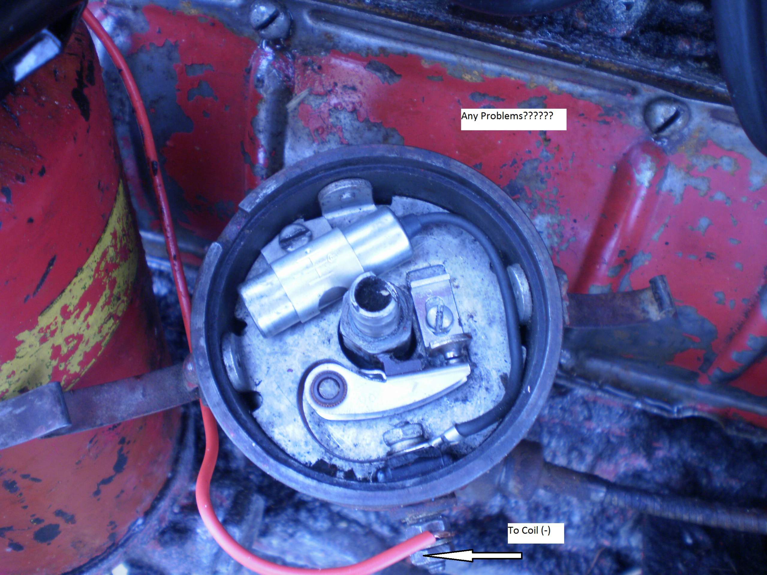

As mentioned, that is quite a gap in the points, for almost being in the flat of the cam. And can't tell if that is cam grease, or the rub block is worn. Being you said you replaced them, I will just assume it is cam grease build up. Bump it until the rub block is on the high point of the cam, and adjust the points to .020".

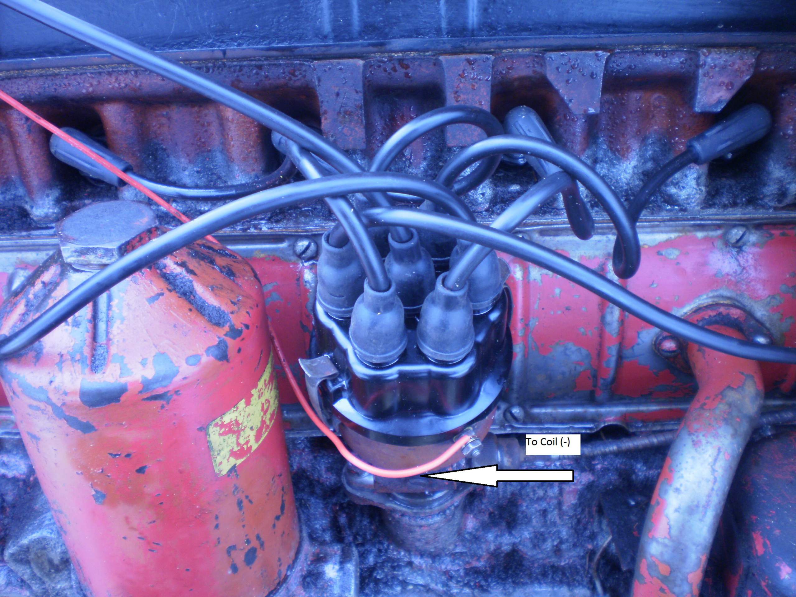

And not that it's that big of a deal at the moment, but following the rotation of the plug wires, looks like 2 & 3 are crossed, unless my eyes are deceiving me. I'll look tomorrow on my 656, and check the location for number one position on the cap. Can't help for some reason thinking the position of the wires in the cap are 180º out. The shop manual for my 656 is at the other farm, and it's getting down towards 6 degrees, so I'll look tomorrow... Is #1 marked on that cap..?? If so, it should only fit in one place, due to a notch in the cap, only letting it set completely down in one spot. For some reason, I'm thinking #1 should be the first hole, to the right of the hold down tang towards the front.

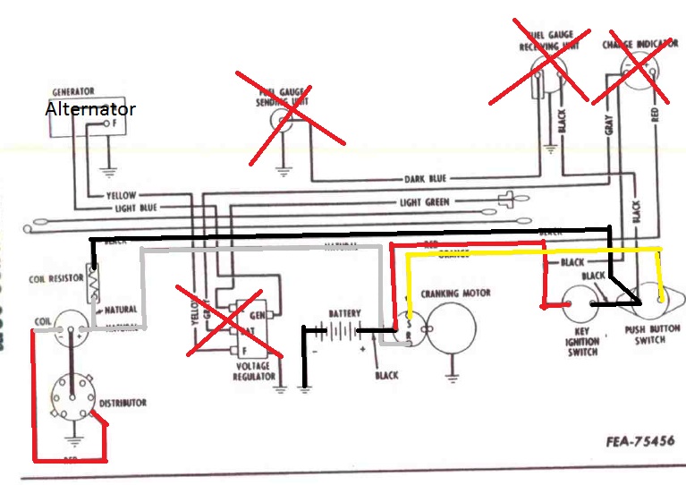

And you are correct about the 12V bypassing the resistor on start up. They are designed to give it 12V on startup for a hotter spark, then cut back to 6V to run, once you release the starter button. Supposedly to prolong the life of the points. Minneapolis-Moline used the same starting circuit on a couple of their tractors.

I'll definitely fix the gap in the points. I'm still very new at all this.
Yes, it is Cam grease.
I think all the wires are hooked up correctly, every hole is numbered.

Once you get the points set, better check 4 & 5 plug wires, I do believe they are crossed. For some reason last night I had the distributor pictured on the right side... Guess I was thinking of all of my 4 cyls., I only have 1, 6 cyl tractor, and 11, 4 cyls. Firing order is cast into the block there below the plugs, and as mentioned earlier, a CW rotation. Always remember..., 15 too young, 36 too old, and 24 just right. :)

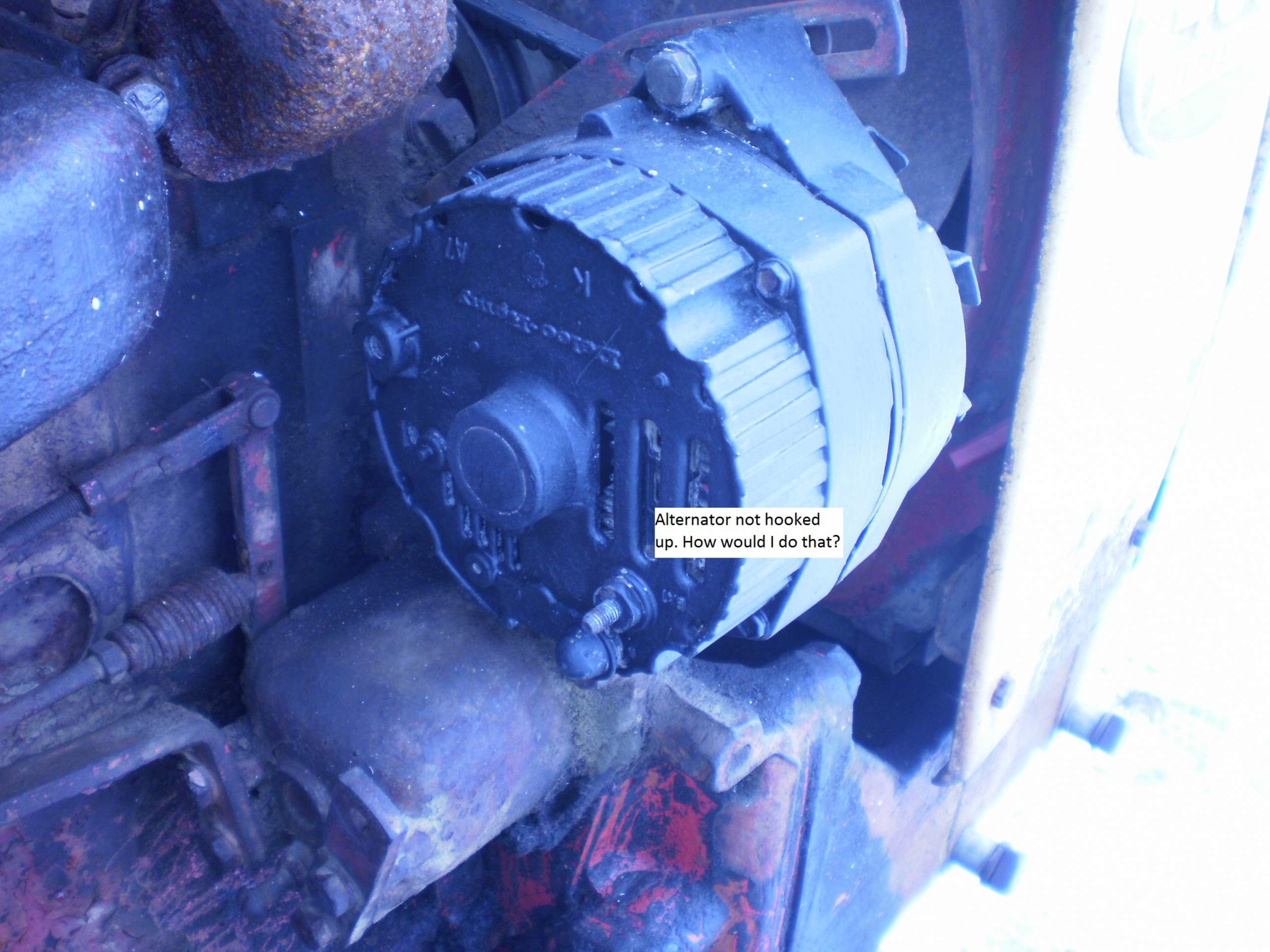

Alternator is an easy hookup. Single wire back to the - side of the volt/amp meter. If the + side is already tied into the harness as shown in the schematic, you should be good to go.

DJ54-distributor cap order was correct. Did you mean Counter clockwise rotation? That's the way this one turns anyways. The picture might be hard to interpret. Or, there might have been a chance that I made a mistake when I took the picture... and have since fixed it during on of the the gagillion times I've taken everything apart.
Soundguy/KevinJ- Gap was adjusted to .020. Multimeter tested, everything was working, all over the tractor... but it still wouldn't start.

Glad you got it going..!! Not all IH 6 cyls. have the same rotation on the distributor. My 656 is CW. It really does pay to have a specific repair manual for your model tractor.

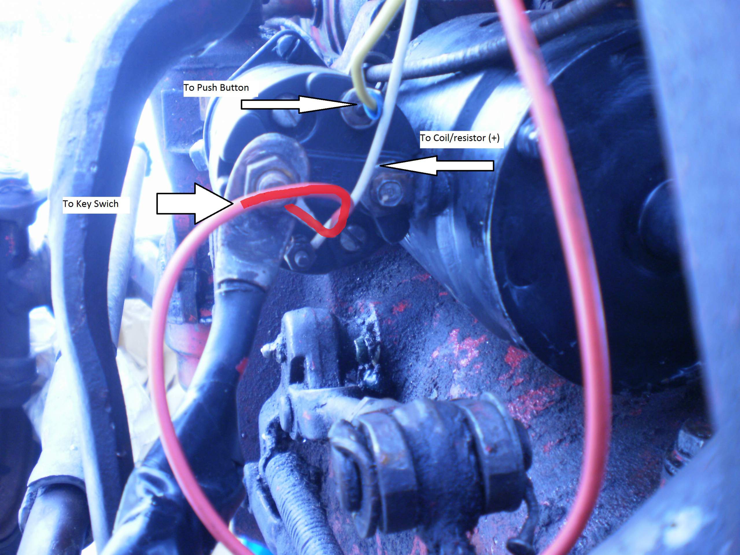

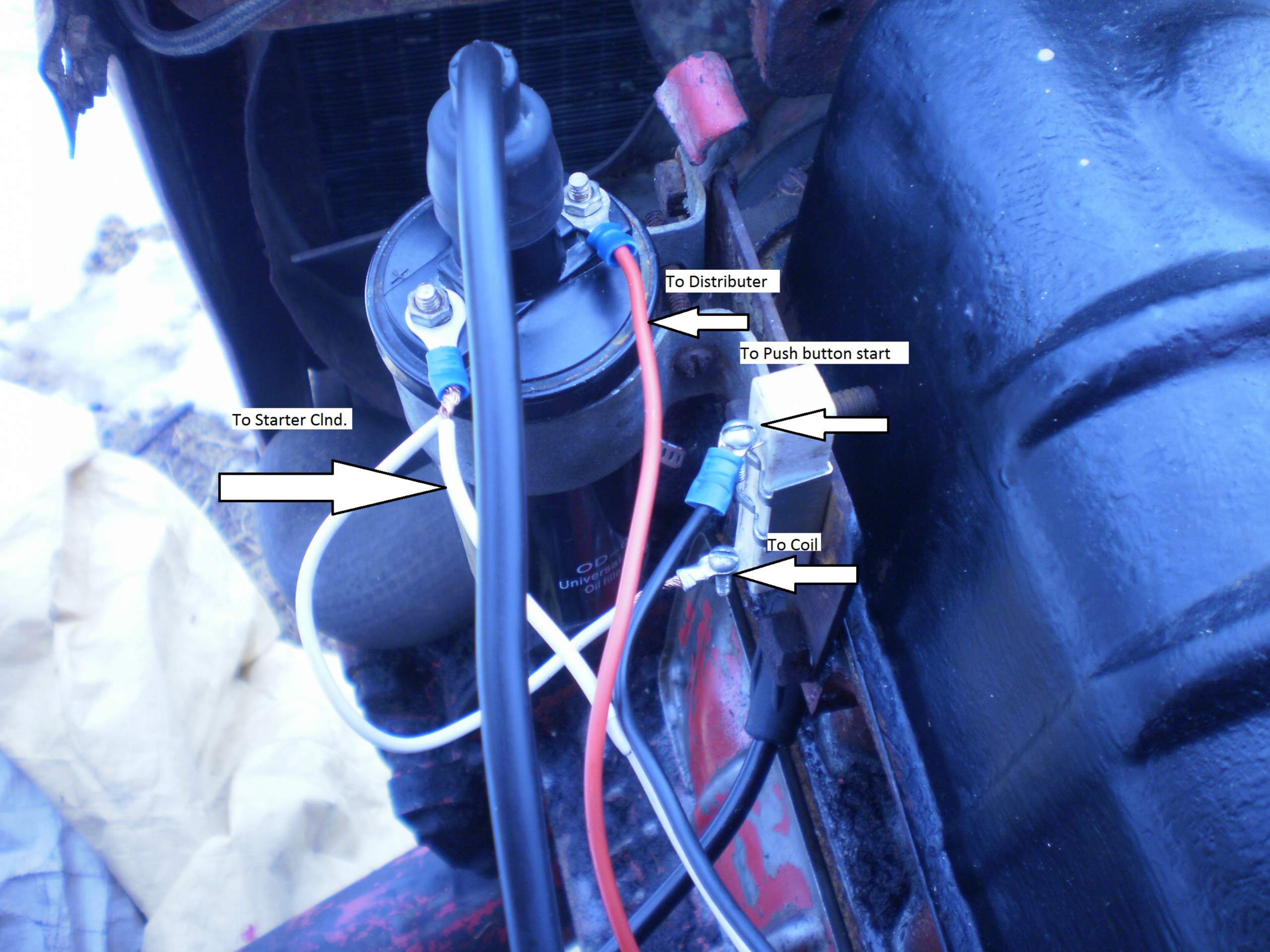

Don't know if you caught where I explained about the 6V coil on the 12V starting system. If you have the 6V coil on, and proper wiring from the starter switch to the solenoid, then bypassing the resistor per your wiring schematic, it should give it 12V (hotter spark)on startup, then once the starter button is released, it will run on 6V through the resistor.
I checked at Case/IH parts, and it shows two different versions of the ignition system, apparently doing away with the resistor, and 6V coil on later models. Shows same distributor, and same contact points on both systems. So like Soundguy said, you could lose the 6V coil, and do away with the resistor. Since you have a new 6V, that would be up to you...
Either way, if wired like it shows in the wiring diagram you posted, you should get 12V to the distributor when cranking the starter.
