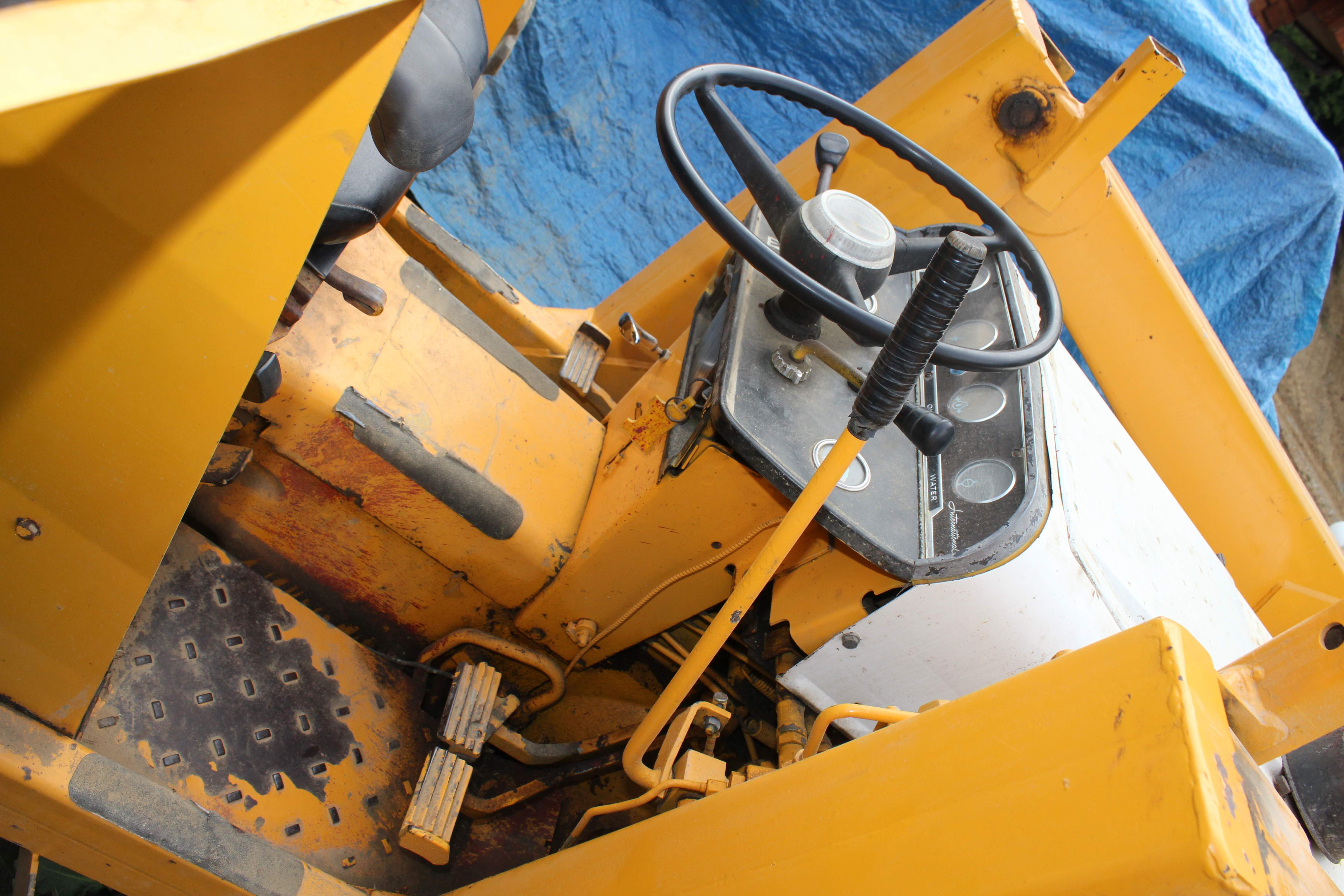

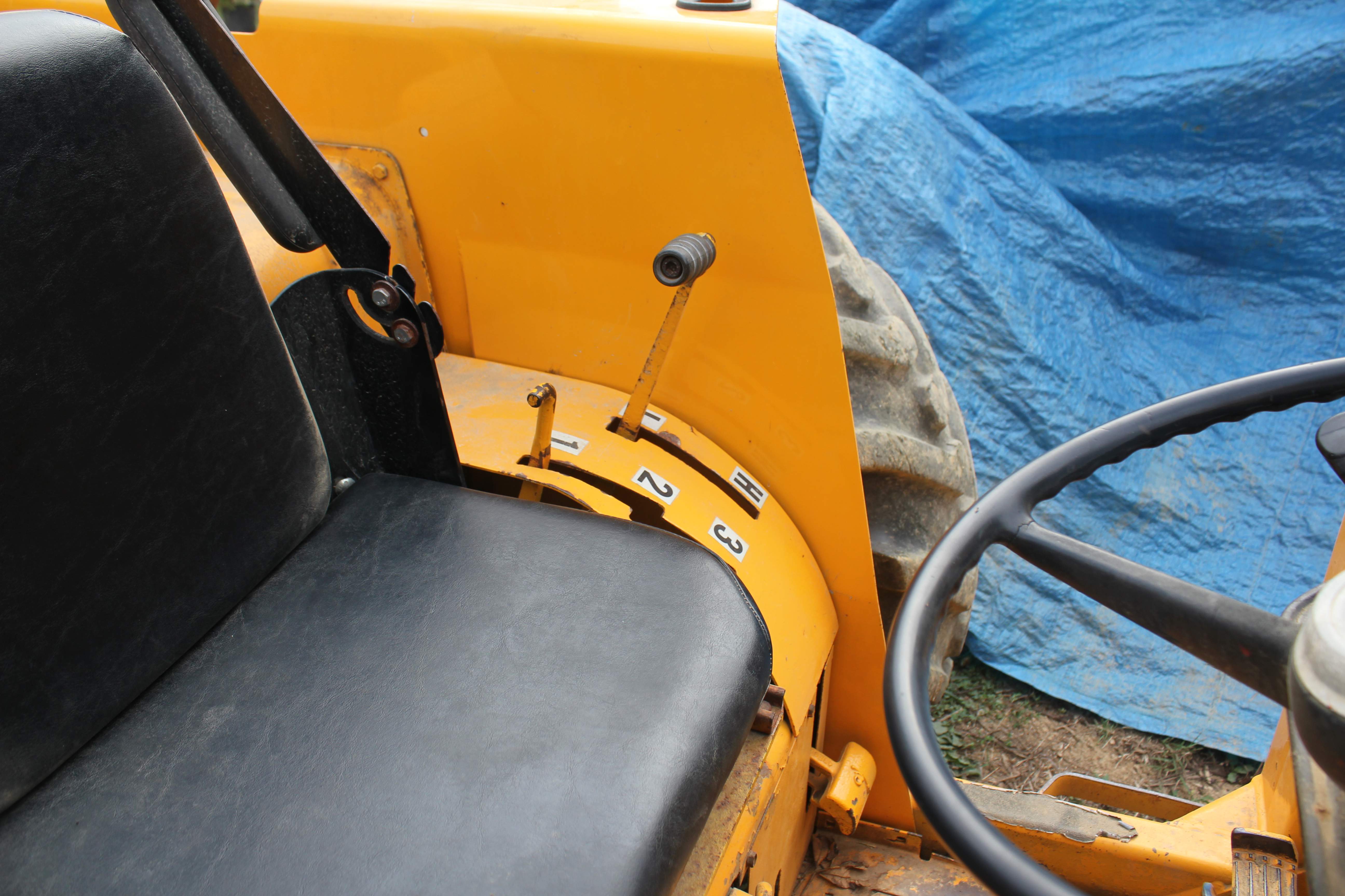

ih 2400
i own a ih loader it has a 3 cyc diesel and has a button on dash to shoot either into it the tractor a can of either sits in a craddle off the engine.also has a shuttle shift and has a 1st 2nd and 3rd gear range i belive it is a 2400 series i am needing help identifiying the tractor need to try and fix the brakes and gauges .[ IMG_7206.jpgIMG_7204.jpgIMG_7201.jpg
/ ih 2400 loader #3
The farm version with a 3 cyl engine would be a 2400!!!
/ ih 2400 loader #4
The farm tractor version would be a 454, 464, or a 484 and the farm version of the loader would have been a model 2000 or a 2001. All including the 2400 had 3-cylinder 179 cubic inch diesel engines The 574 was the next larger size with a 4-cylinder 239 cubic inch diesel engine and would be comparable to a 2500 industrial tractor. The I-H 2400 is the industrial version painted yellow and the farm version painted red. There was a 2400A and a B series and a later model which was called a 240 industrial tractor. All the industrial models were available as a bare tractor, with a loader, or as a tractor-loader-backhoe combination. I sold hundreds of the industrial models; however, I didn't sell agricultural tractors or equipment.
Bill
/ ih 2400 loader #5
Bill
i have the 2500 A SERIES i love the tractor it has the 2050 loader with 7 ft bucket with joystick.
