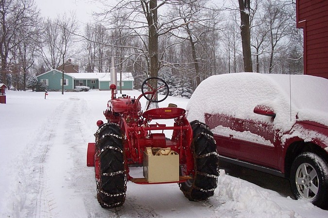

Good Evenin sixdogs,
The IH 140 followed the Super A which followed the A. The offset tractors were mainly used for cultivating, and what made them so attractive at this job was the superior visibility that the operator had while running the machine ! I have a Super A and also a 42 A. I use them for snow plowing and pulling a trailer. I also have a sickle mower for my 42. I bought my 49 Super A for $700 and then restored it a couple of years back, it is a great tractor, and I dont think I would sell it for under $4k to $5k !

Scott--I like your Super A and actually thought of one of those first. I just happened to hear and see the 140 up close first.

Good Mornin Bob,
I didnt forget about those units, but I did kind of fast foward to the Super A ! :eek: They were IMHO some of the best tractors evewr made for that job ! ;)

Good Mornin Sixdogs,
What you will get with a later unit over the Super A is a 123 cu in engine over what I have which is the 113 cu in ! A bit more HP, you will also get a water pump compared to my thermosysyem ! There were a few more improvements but overall the tractors didnt change much ! I would think an IH140 in good shape would go from $3500 to $5000.
Good luck ! :)

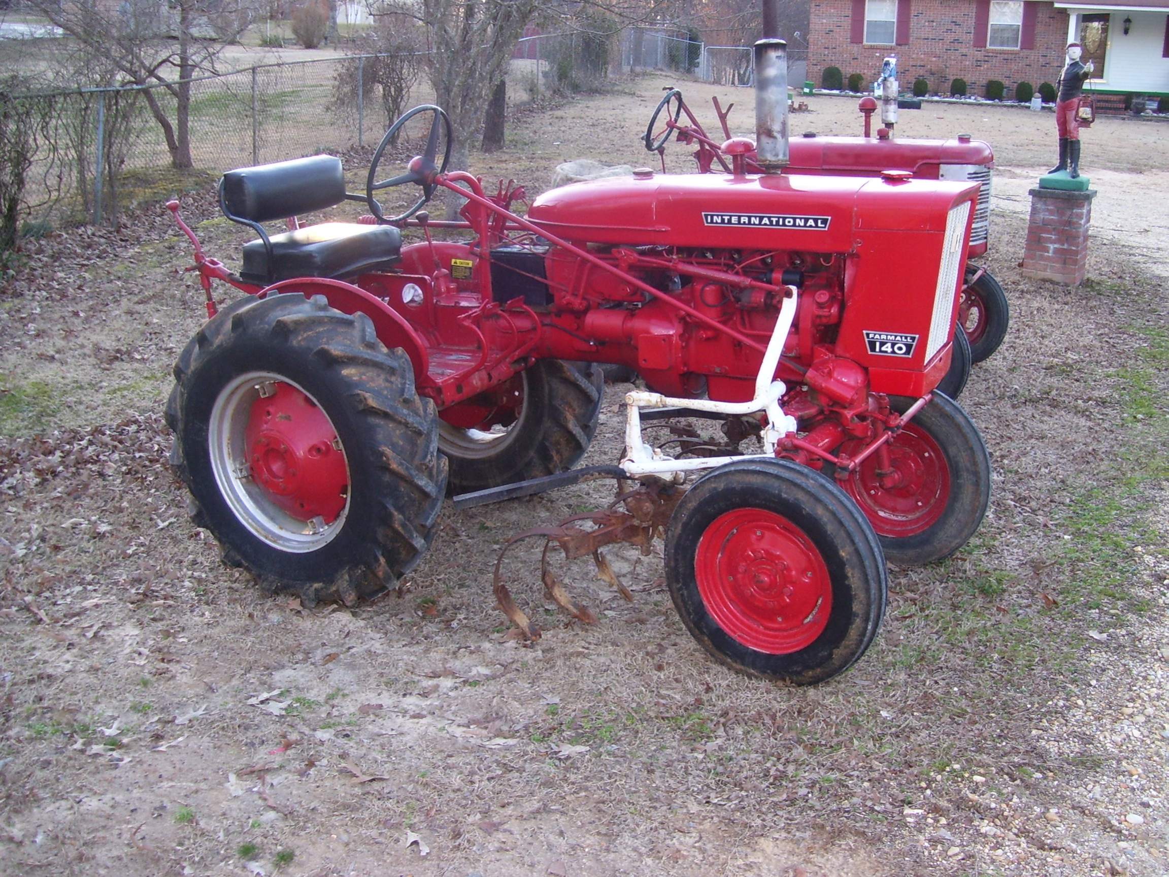

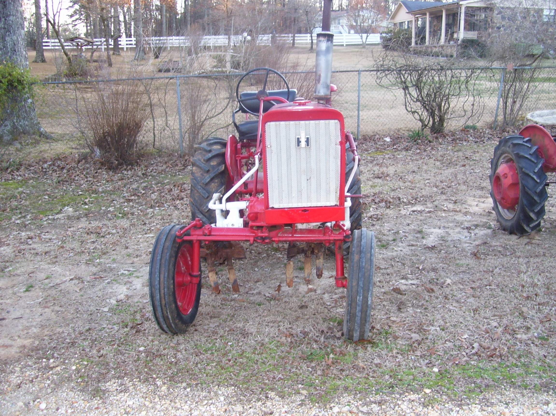

Heres a pic of one of dads 140's this is a 70 model.

Good Mornin Taylortractornut,
That IH 140 is a beauty, thanks for posting ! :)

Thanks we have another one with a 1 point hitch that we redid ourselve thats a 60 model its got a different grill. Waiting to get the hitch and cultivator parts blasted an painted.
