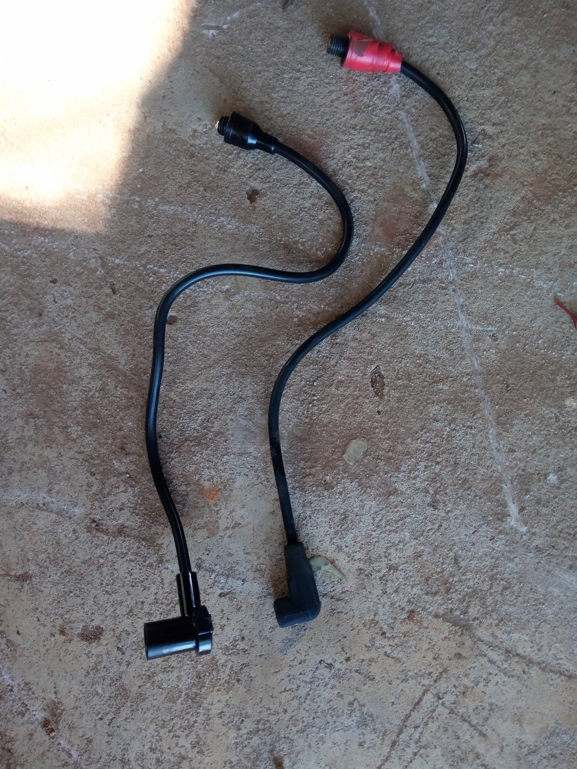

Hi,
Thought I'd share an experience of mine that occurred while working on my Massey Ferguson 35. When trying to resolve a misfire, I replaced the spark plug leads with a new set as shown on the right of the photo, thinking I was improving the ignition system. At 1 year old, they were arcing thru the rubber ends to anything close by.
Not everything new is better.
I have since bought a set as shown on the left, which have hard plastic spark plug ends and are apparently superior. Time will tell.

The best spark plug wires have three insulation coatings and a stranded copper wire that is soldered to the ends caps. Hotrodders and racers have known that they have to make them right that way for years.
But even those parts are hard to come by. When I went to automotive stores - includng NAPA - last year I found they didn't even carry the parts to make up spark plug wires from scratch.
It's such an easy thing to do, and makes such a large difference in performance.

The best way to find a miss (bad plug wire)
is at night when its dark easy to see the
sparks fly
willy
/ Ignition leads cautionary tale
sparks fly
willy
Yep, that's how I accidentally found they were arcing. Otherwise I would not have considered the leads as possibly bad, given how new they were.
/ Ignition leads cautionary tale #5
Spray a little water while it's running, darkness helps.
Years ago a buddy bought high perf wires for his 70 Hemi Cuda, same wires as the old 354 Hemi used in 1954. Ceramic ends down the tubes.

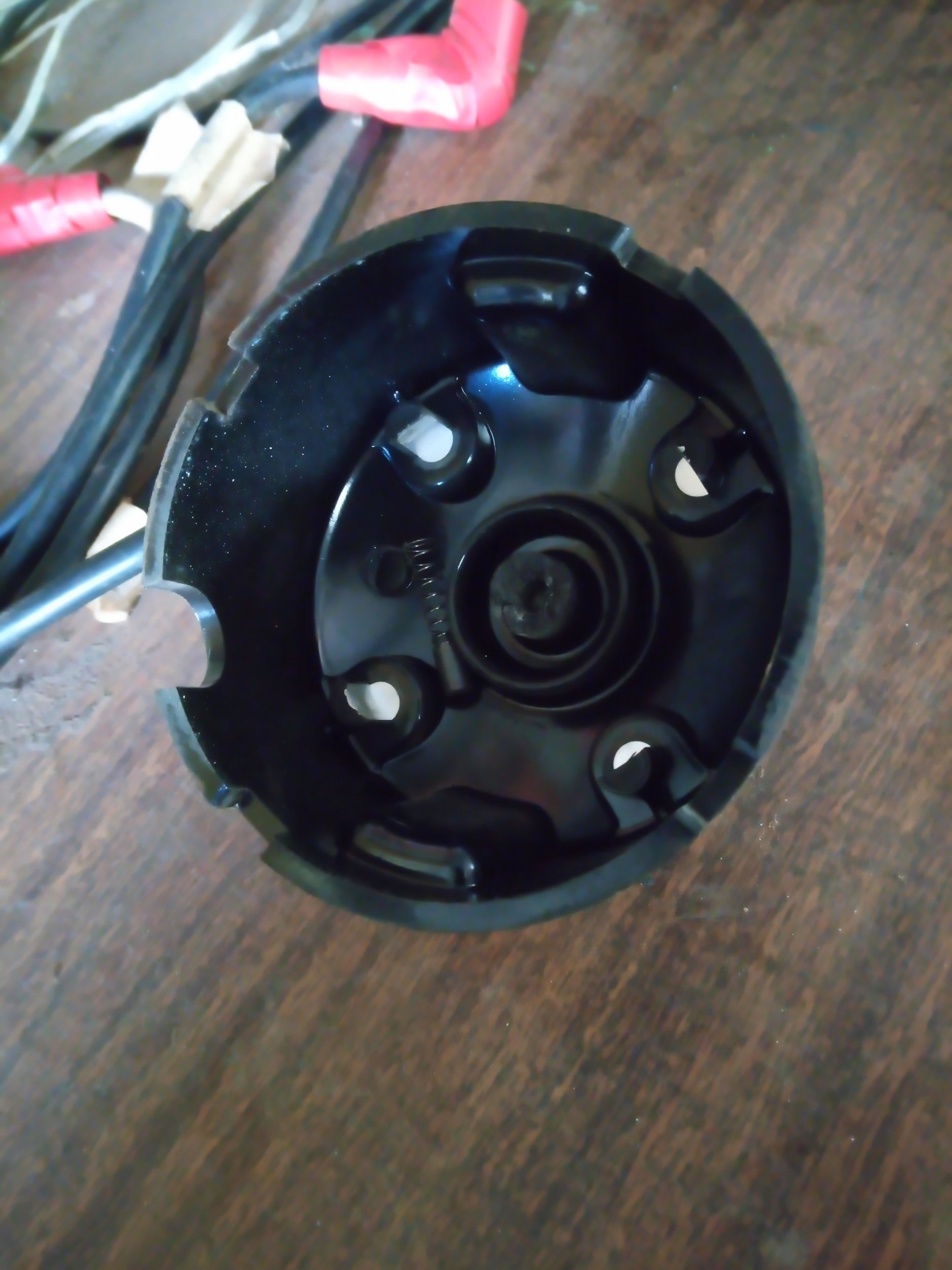

And in breaking news, here's a photo of the distributor cap. Again, 1 year old. That centre post has snapped away or was destroyed by arcing sparks.
I've installed the old one, which I luckily had put aside.
New may not be better.

That may be a similar case for me. K can't see any reason that the centre post should disintegrate, aside from poor manufacturing, but the remainder seems to be a quality part. Perhaps my bad leads caused this?
/ Ignition leads cautionary tale #14
I wonder (center post arc) if there was a gap to the rotor button. You can put some play-doh on button, mount cap, remove cap and see if play-doh is flattened.
#15
Hi,
Good point. Arcing across a gap may have been the issue. I'll test the reinstalled old cap and report back.
