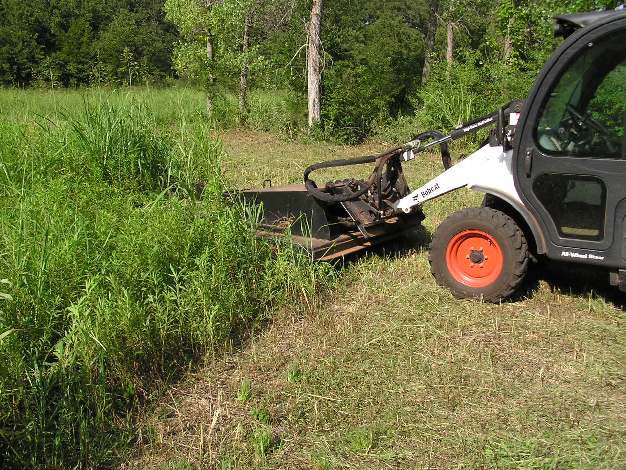

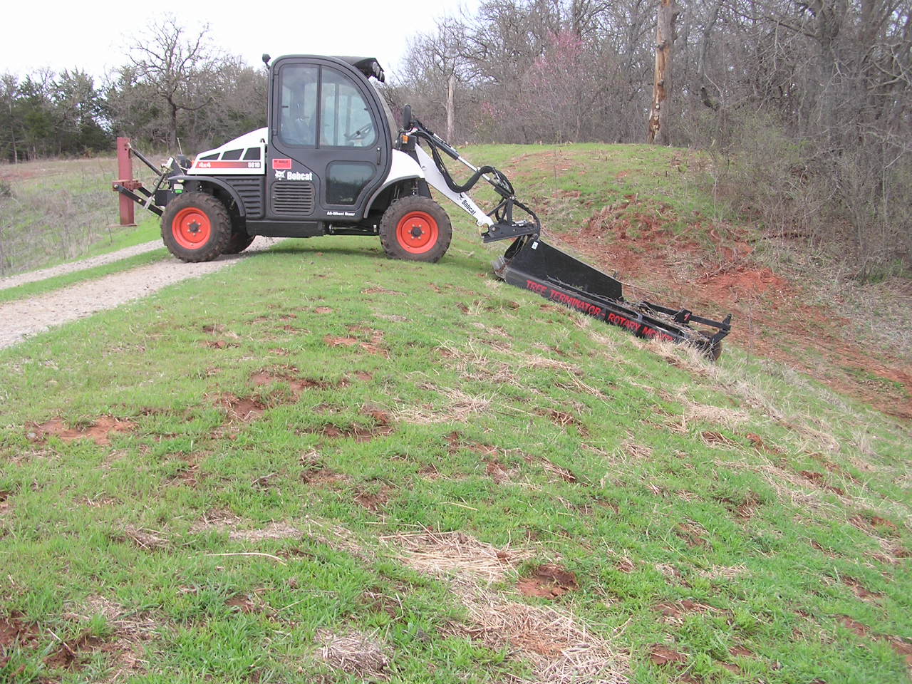

This is mine, with the 7' brush hog.

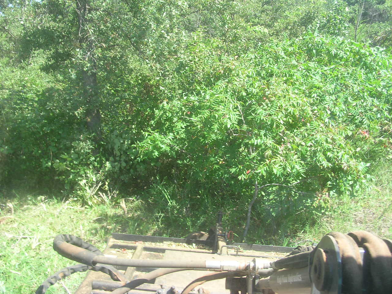

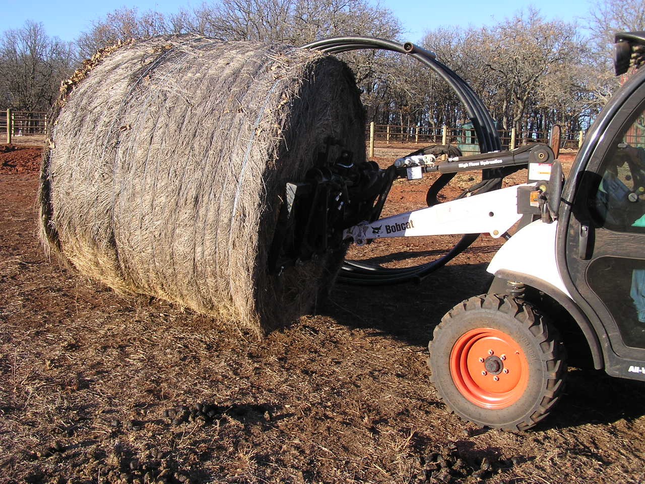

Don't see a listing for breakout force, but it doesn't have any trouble curling a 1500 pound hay bale or the 1800 pound 7' brush hog.

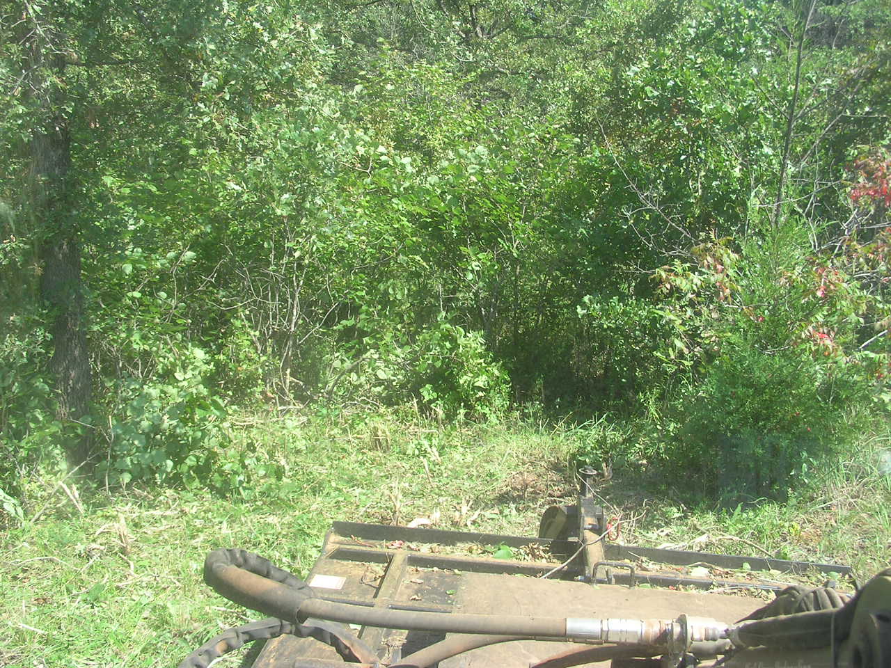

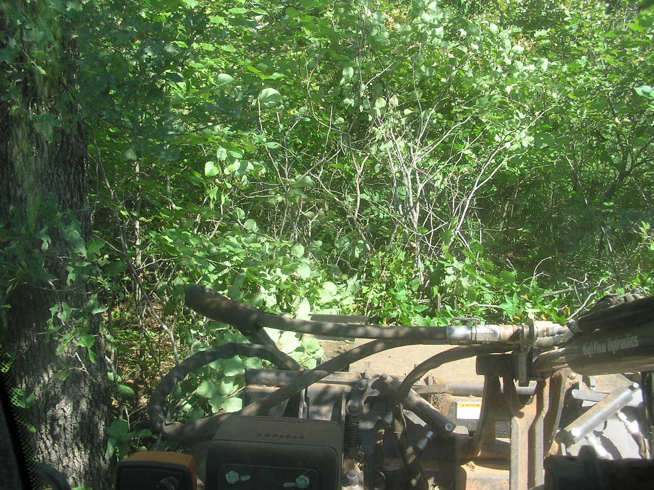

Generally speaking, I have found that a machine that can do everything doesn't do anything exceptionally well.

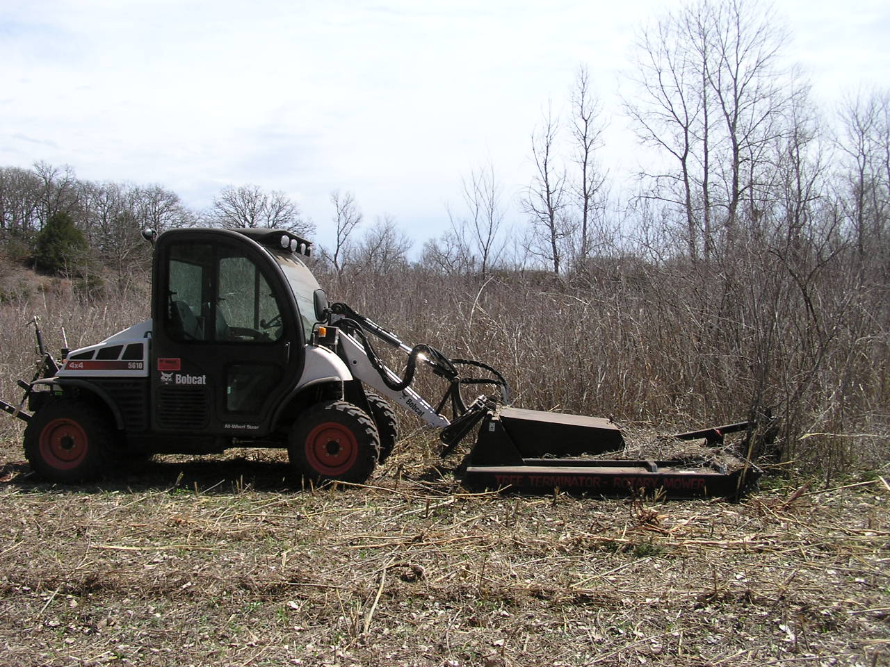

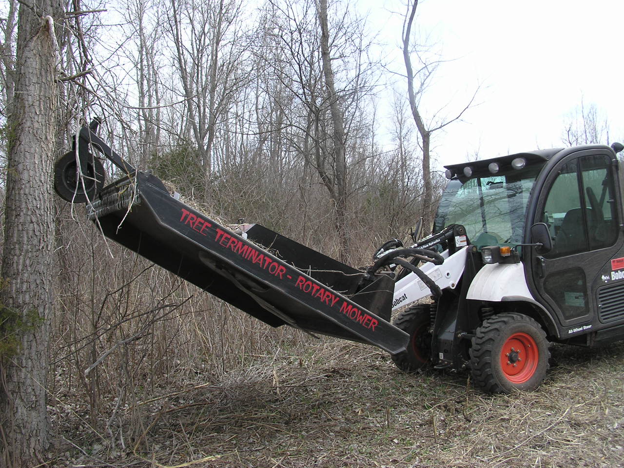

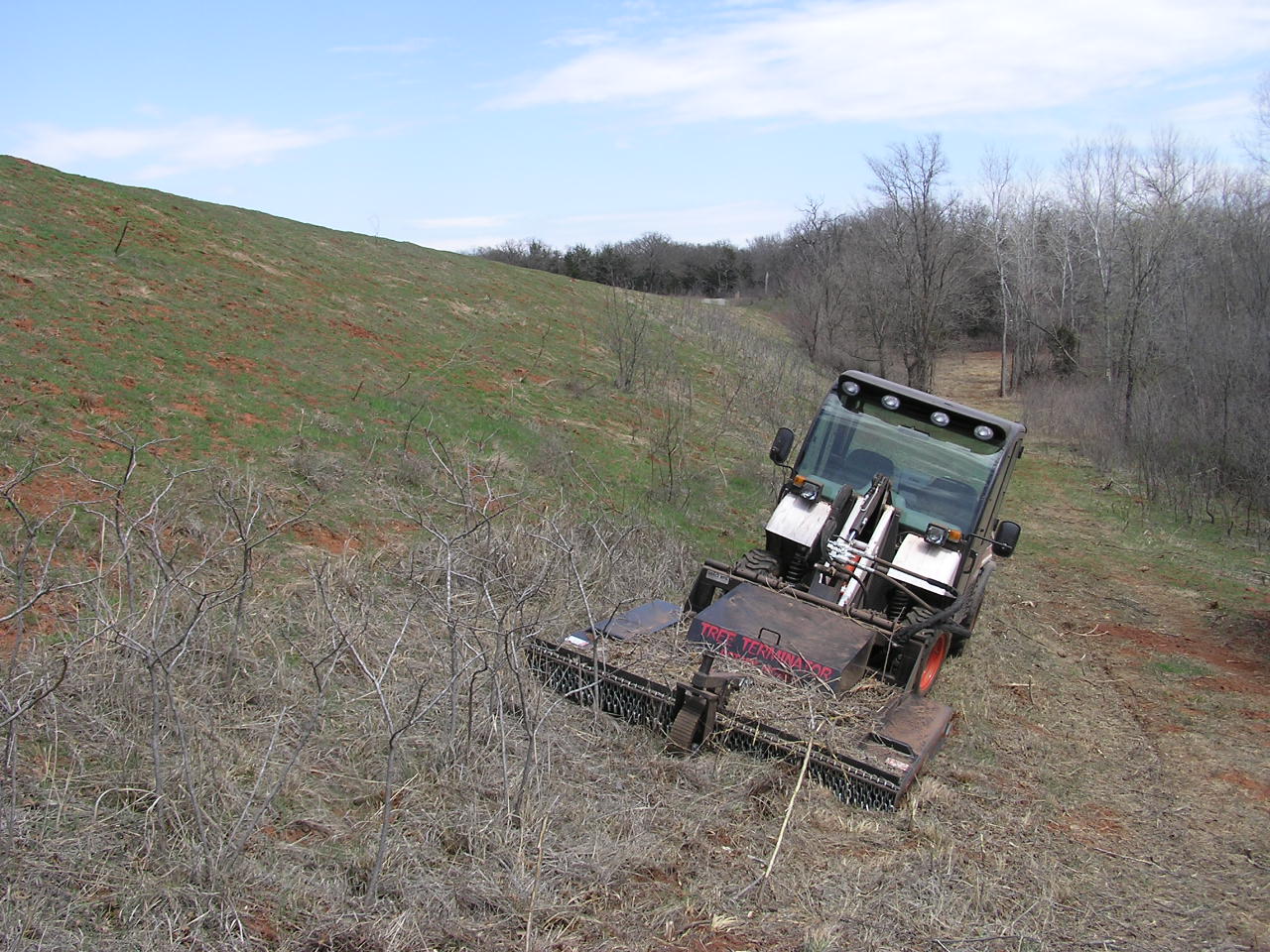

It does exceptionally well with the brush hog. :thumbsup:

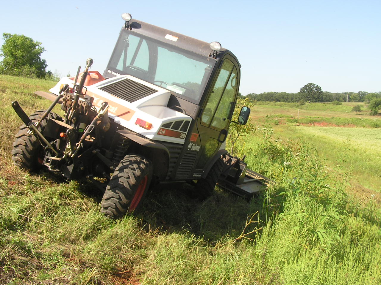

No overheating problems with the F series.

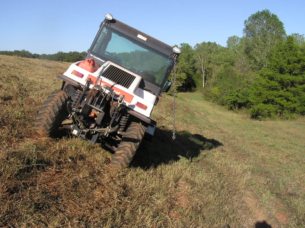

Very stable on sidehills. :eek:
View attachment 348446 View attachment 348447 View attachment 348448 View attachment 348449
