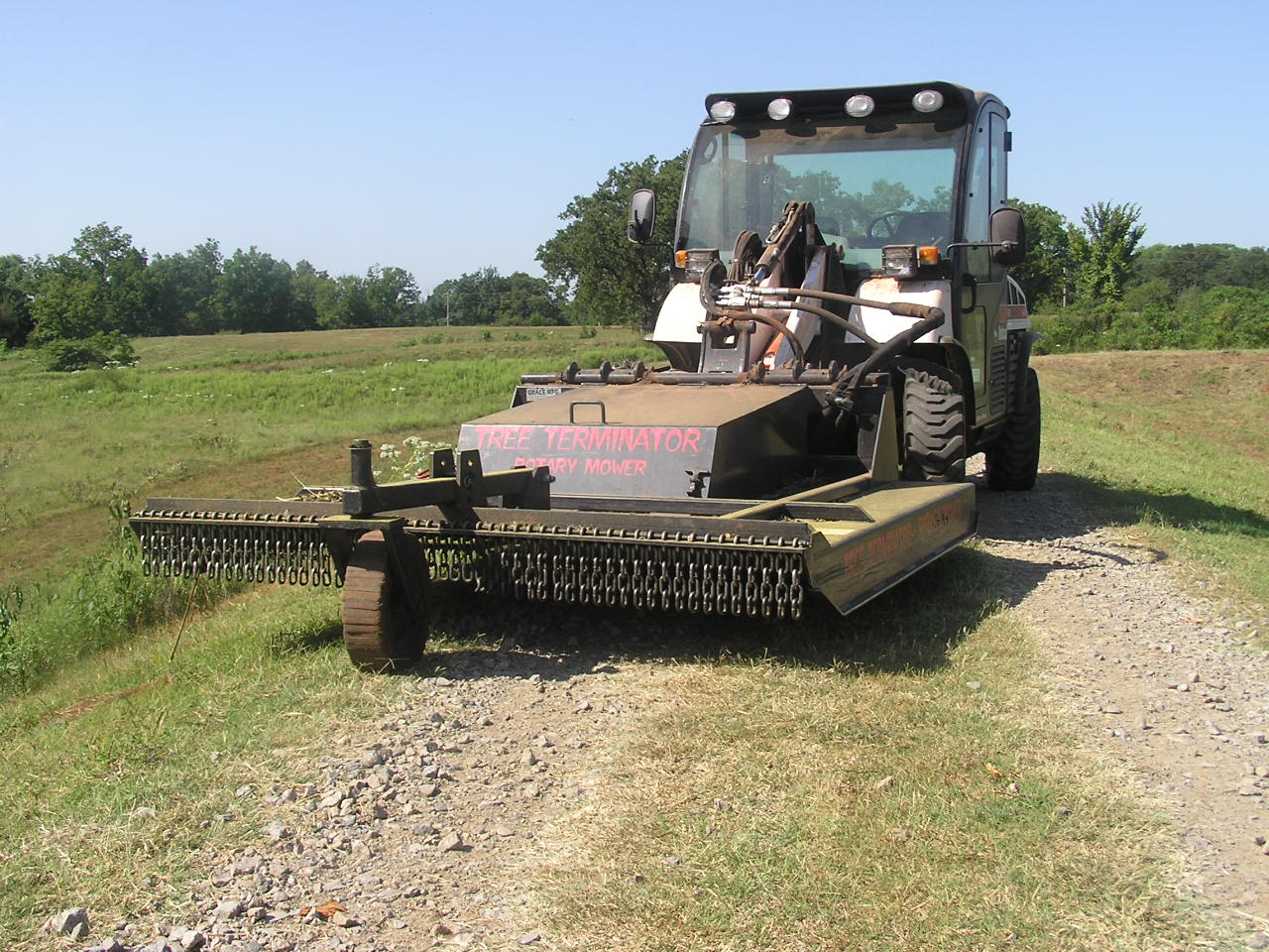

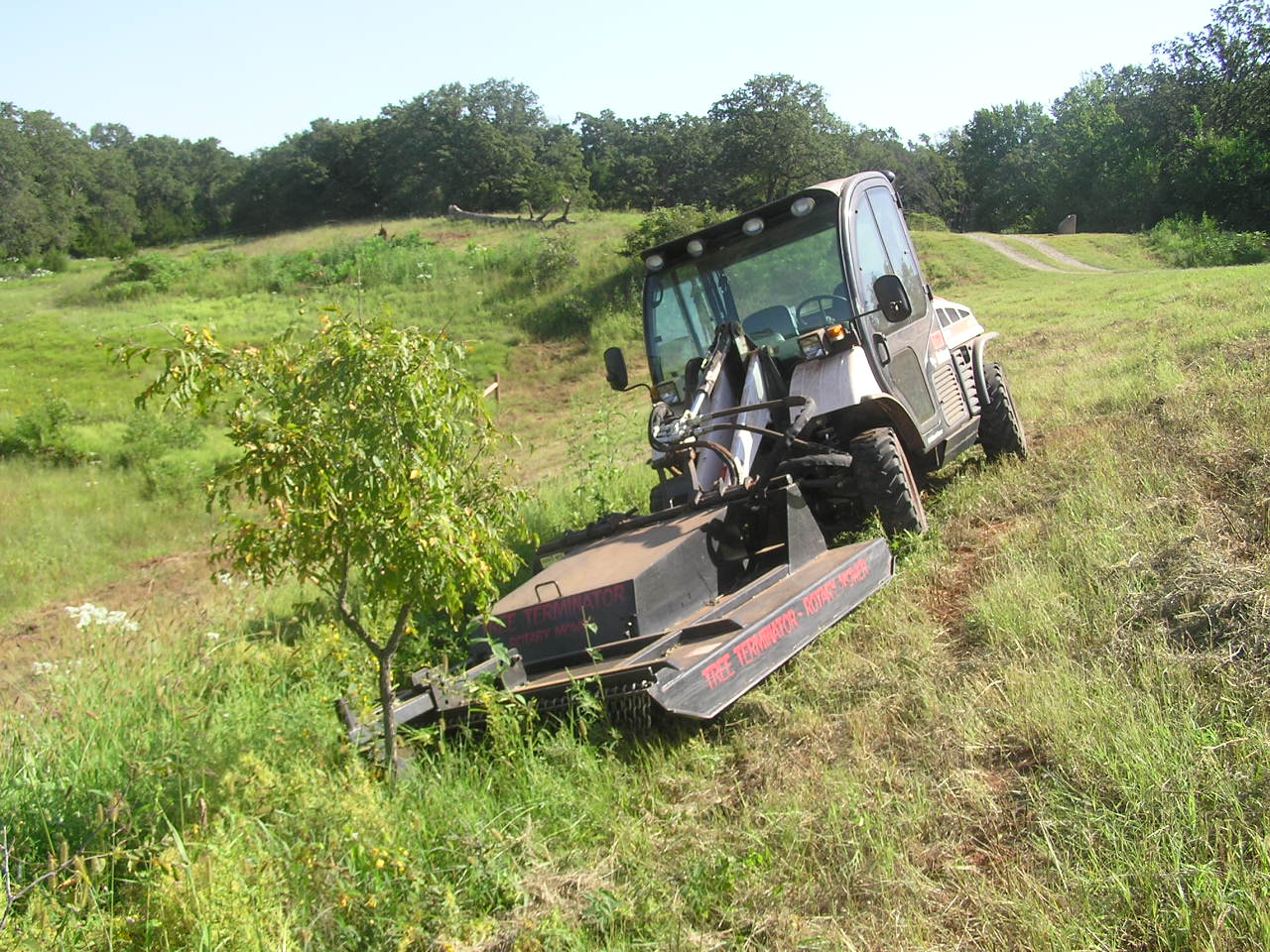

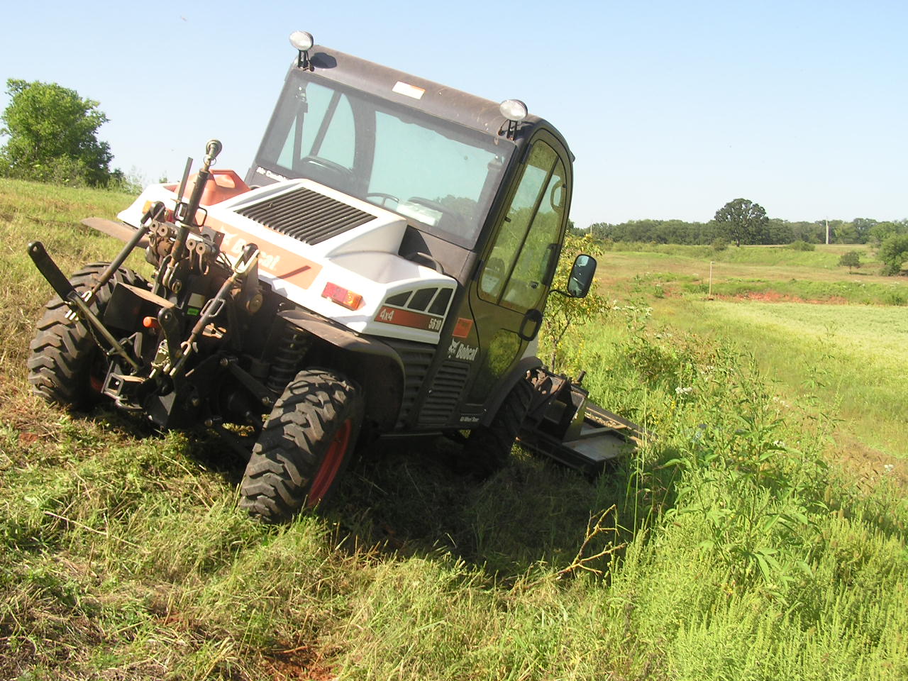

I would recommend the 5610 G series with the traction control. We have the F series that is supposed to have a limited slip differential, but it doesn't work: http://www.tractorbynet.com/forums/...rsus-hydrostatic-post4638521.html#post4638521
It does OK on side hills with the 7' brush hog on the front, but I would not go any steeper than 27 degrees:

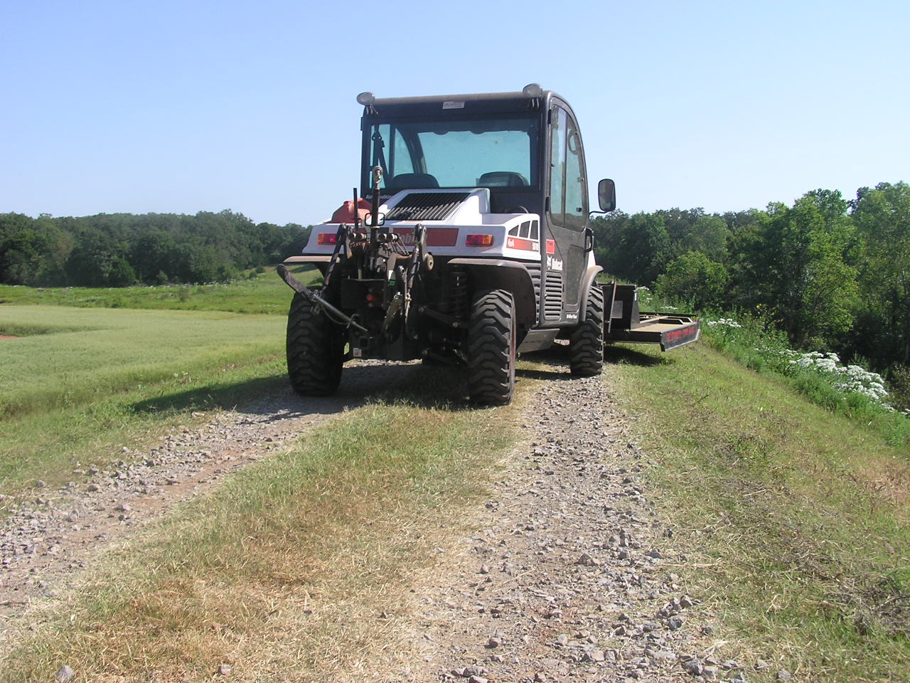

Ours has the taller 29 inch tire and the 3 point is handy:
