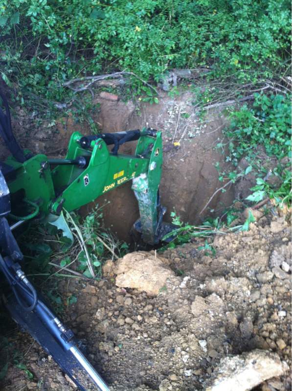

I can't say I fully agree with this. I have dug a number of stumps with my GC2410. It's not a fast process but it can be done (and without beating up the machine). You will spend lots more time repositioning the machine than you would with a excavator, but with some patience you will get the stumps out. I have not needed to cut the roots with an ax or saw. I have been able to split large roots using the tooth of the bucket. The bucket teeth on the GC are smaller than a BX tooth, but they are a little sharper and I keep nibbling away at the thick roots until I have them split up enough that I can finally rip them free.
Having said that I had a project where I wanted to get rid of 6-8 stumps right away. I rented a good sized stump grinder and got through it in a day. That was enough stump work (and on a tight schedule) to justify renting.
Make no mistake, the BH on a SCUT can do quite a lot of digging. In relation to a mini-ex, the difference between the BH on a SCUT and a 30hp CUT is minimal. Yes, the next size up BH is a little more capable, but there is not that much difference. Look at the specs. Few more inches of reach, a little more breakout force. More is always nice but the differecnce between the BH on a B and a BX is not night and day. There is absolutely no comparison between the digging capability of even a small mini-ex and a CUT BH. As others have said if you want the stumps out quick rent a large stump grinder or a excavator.
That said I agree with others that going up in size is generally a good thing. Except when the bigger machine won't fit in tight spaces the little SCUT will. That's the situation I'm in. I'd love a larger machine (Tim the Tool Man) but the reality is I'd get less done with a bigger machine because I have lots of tight areas.
Based on your earlier statement that you have time to get the stumps out I believe a SCUT could work for you. Lower cost is a advantage of a SCUT. You can get a SCUT TLB for nearly the same cost as a upper B series with just a loader. It is nice to have the little BH. You will find projects for it that you did not even think of prior to having it. Having it on hand means you will use it for lots of little projects that will only take a few minutes, but are far to small to justify renting a machine. Without the BH these little tasks would end up never getting done.
Personally, if I were to move up from a SCUT I would want to have a three range tranny and position control on the 3PH. Low (snail) range is useful for pulling something heavy out of a hole (like a stump) and position control is almost essential for precision box blade work. This would put me into a Bxx30, a JD 3000 series, a MF 1500 series, etc.
So my 2 cents is don't sell the SCUTs short. But if you have the room and money for a bigger machine then by all means go for it. If you are going up then make it worth while and get a three range tranny and 3ph position control. From a cost and efficiency perspective I agree with brewdog. Rent equipment or hire out the stumps then use a scut to do all your landscaping projects.

I've done some backhoe digging with a SCUT...., because they're typically very light machines and not very strong hydraulics, it will take awhile but it can be done.
You said you don't mind taking a weekend to dig 1 stump.....that might very well be the case.
I think the property maintenance can be done with a SCUT, the problem boils down to the stumps. Backhoes are expensive, typically 4-6K. Are you going to use it much after the stumps are gone? Or sell it?
Do you want more seat time, (maybe more than you bargained for), or would you rather get the stumps dealt with quickly and move on?
I'd give the rental option some consideration. A mini-ex will move stumps out MUCH quicker. With the blades on them, you can backfill the hole and grade the areas. Also, I would push the trees over with the stump attached, saves a lot of digging.
And, a CUT will be much more capable for digging the stumps.

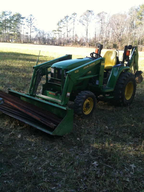

I'm a newbie myself, but recently purchased a gently used 1991 JD855 (around 400 hrs) with backhoe and various implements to work my 5.5 acres of hilly land with a mix of pasture, dense fir and a few old growth trees of various species. I mow with a Craftsman GT 46".
My neighbor is a heavy equipment operator who does lots of trenching work for cable pulls. He has a Kubota BX2350. He borrowed my tractor to dig out a couple of stumps and now he has a bit of buyer's remorse and he's looking to find something similar to mine as he really liked the additional weight and stability of the 855, though our HP ratings are very similar.
I'm very happy with my purchase. I looked hard at the SCUT options, but found myself leaning towards a Mahindra 3016 (which I thought appeared to be a better bargain) before I came across the 855 package deal.
