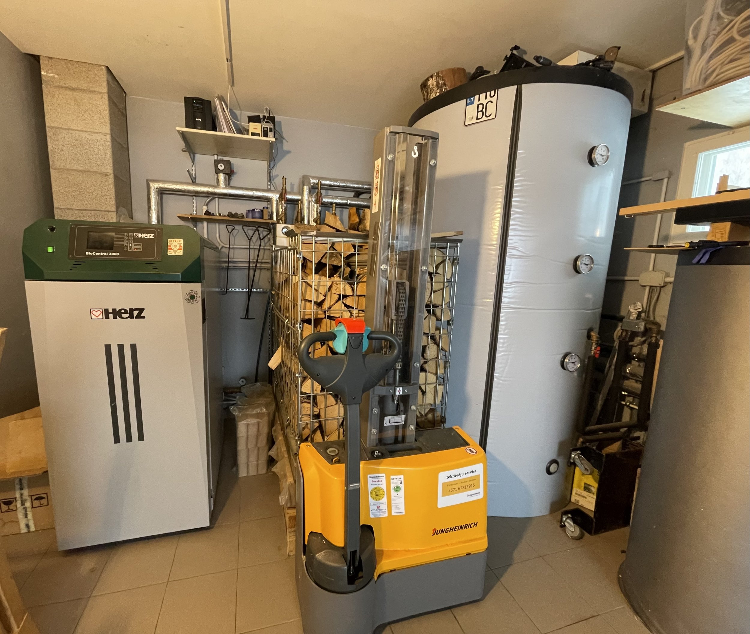

I have wood gasification furnace (or boiler ? I am a bit confused about terms you use).
It has 20 kW power and is connected to 2000 liters big heat accumulator. Every second day I am filling boiler with ~ 30 kg of wood and fire it up. wood burns like 5 - 6 hours, warms up accumulator from 30 C to 80 C. We have underfloor heating, so to go down till 30 is ok
/ Little break for ranting - SI system makes much more sense - 1 W is needed to warm 1 liter of water for 1 C /
Keeping that in mind we can figure out that my accu contains ~ 100 kWh of energy. That's enough for 48 hours. At least it was so till this fall
This year I have made extension for house and obviously now house needs more energy.
And parallel to wood boiler we have installed air - water heat pump
It is efficient is it has to go till 35 C max, which is ok for me. And if temperatures are negative, then as well efficiency is falling. I have used heat pump till + 5 and I have noticed ~ 3,5 COP, which is less than promised but still rather nice
Nice looking setup. Especially the little electric fork lift for a pallet mover.
that neat thing is unbelievable handy and useful not only for mowing firewood
As we are in TBN, I will give to you tractor related example: with help of that little f-ker attaching implements on rear 3p is kinderspiele
