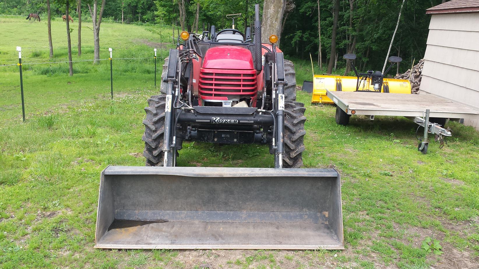

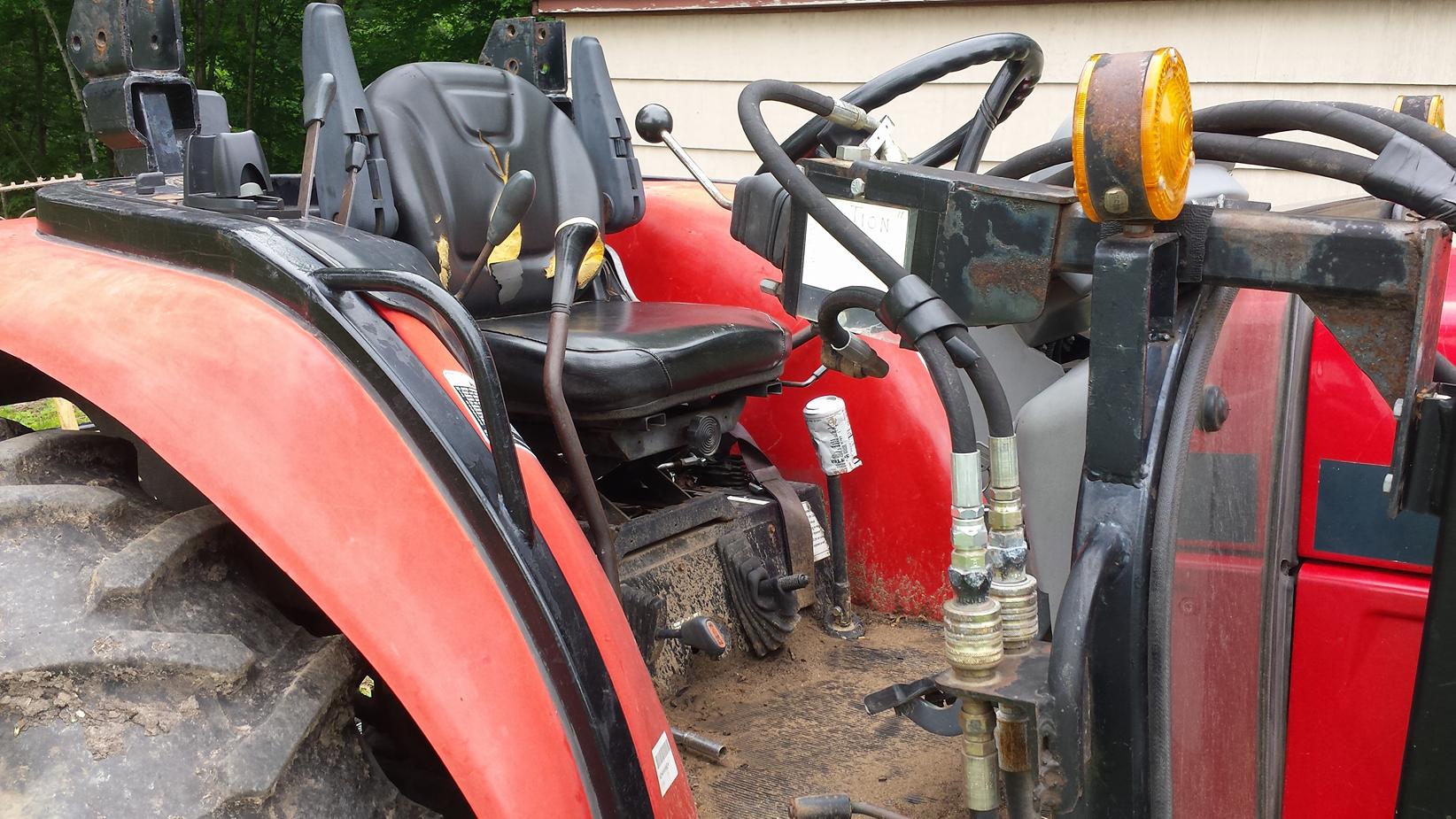

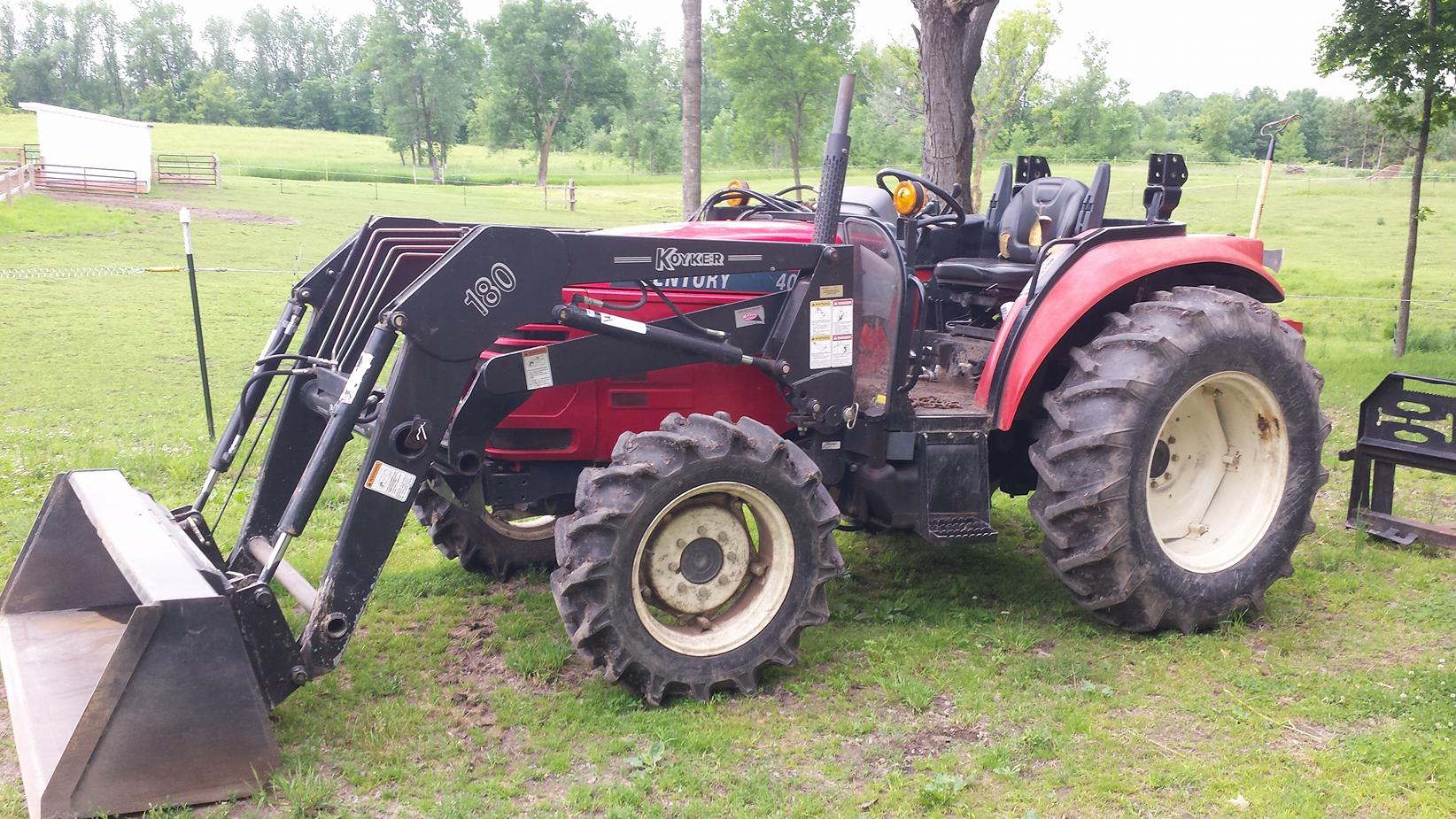

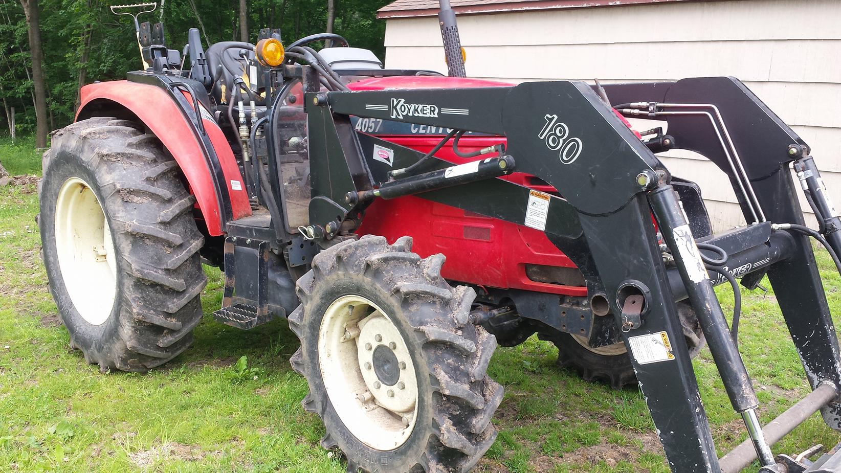

Before you junk it I would love to see some photos ,,I'm sure it's what bransonbuilder said it was ,, I love weird tractors what you going do with it ?

Last post of page 1. He posted a couple of pictures.
