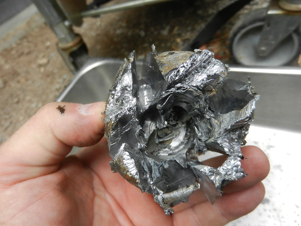

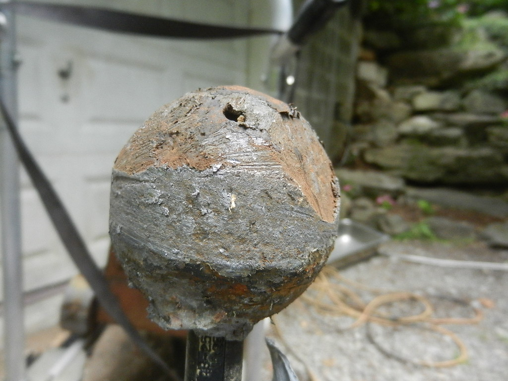

Short update: Got right/angle drill chuck screwed back on. Attached to extension which was holding the buried bit... pulled trigger and viola, ball came right out.
Now I see the bit is buried in the ball and of course, won't back out. So got my Sawzall out and realized not the right tool. Put it back, got my air chisel out and 3-5 minutes later, buried bit is free. I'll have some pictures, wife & I are preparing to go to town to review/buy some floor tile.
Anyway, so in my excitement, I put flashlight down barrel.... I see something odd.
Put flashlight on spotlight instead of flood. WTH????
Babies?
Thank you to MossyToad for giving someone the idea.... there is a SECOND ball, behind the first....Thank God they didn't put what now appears to be ELEVEN. I thought I only had ten balls (now nine balls and a pile of diced up lead)

Here's the ball that came out. The flat side that's on the right side is what I referred to earlier. No idea how/why it's there. No idea if that was part of a deformation issue.
When the drill bit "bit", it ended up spinning the ball. You can see the smooth sides on the ball where it spun in the bore.
Bit was buried SOLID. Rather than try to saw it out, I just got my air chisel and it made short work of it. I didn't want to destroy the ball but I would have been fighting this for a much longer time had I not. Besides, I don't intend to actually fire a cannon ball, just to be cautious AND, since I still have the mass of led, I'm willing to bet I could take it to my newest best cannon friend and he could melt it back into a ball (he sent me some pictures of his ball making tools)

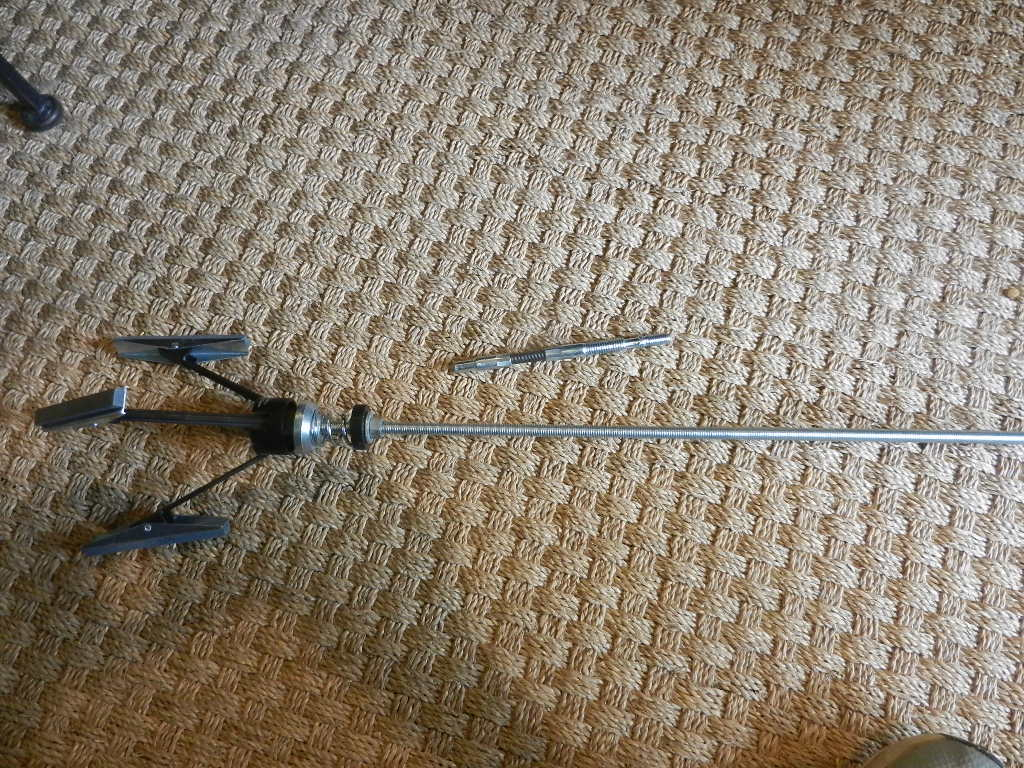

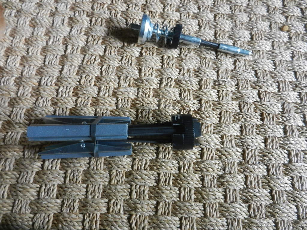

One of my issues on honing the bore is/was the hone is too short. I saw what should work but passed while I thought about it. This morning, I went back to get it thinking I could probably buy a drill extension at Home Depot and extend it. (I was wrong)
Just no way the above is long enough... I meandered through the store...debated on just taking the hone back... then it hit me. The right half screws in....so it will unscrew.
I can go measure it and find out it's a (I forget) 3/16th's 16 thread....and move everything over to a threaded rod...
and viola, I have my extension for the full bore.

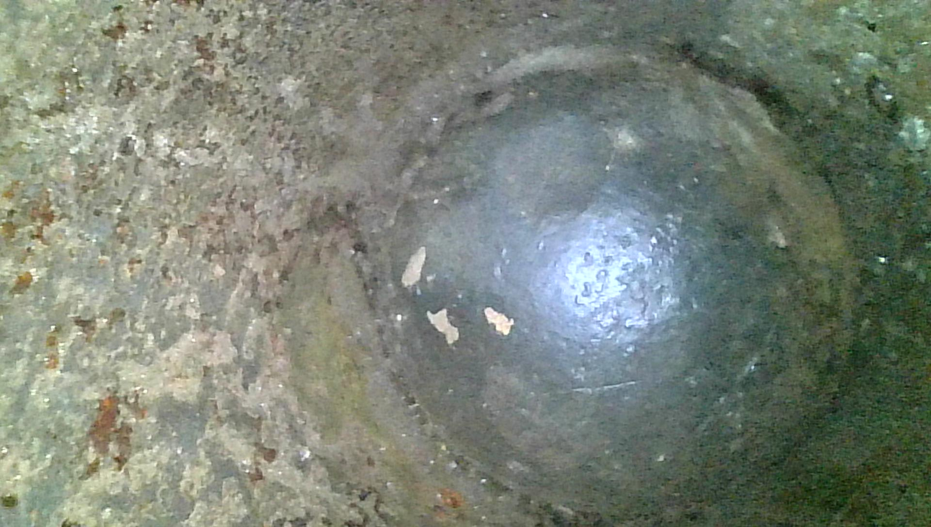

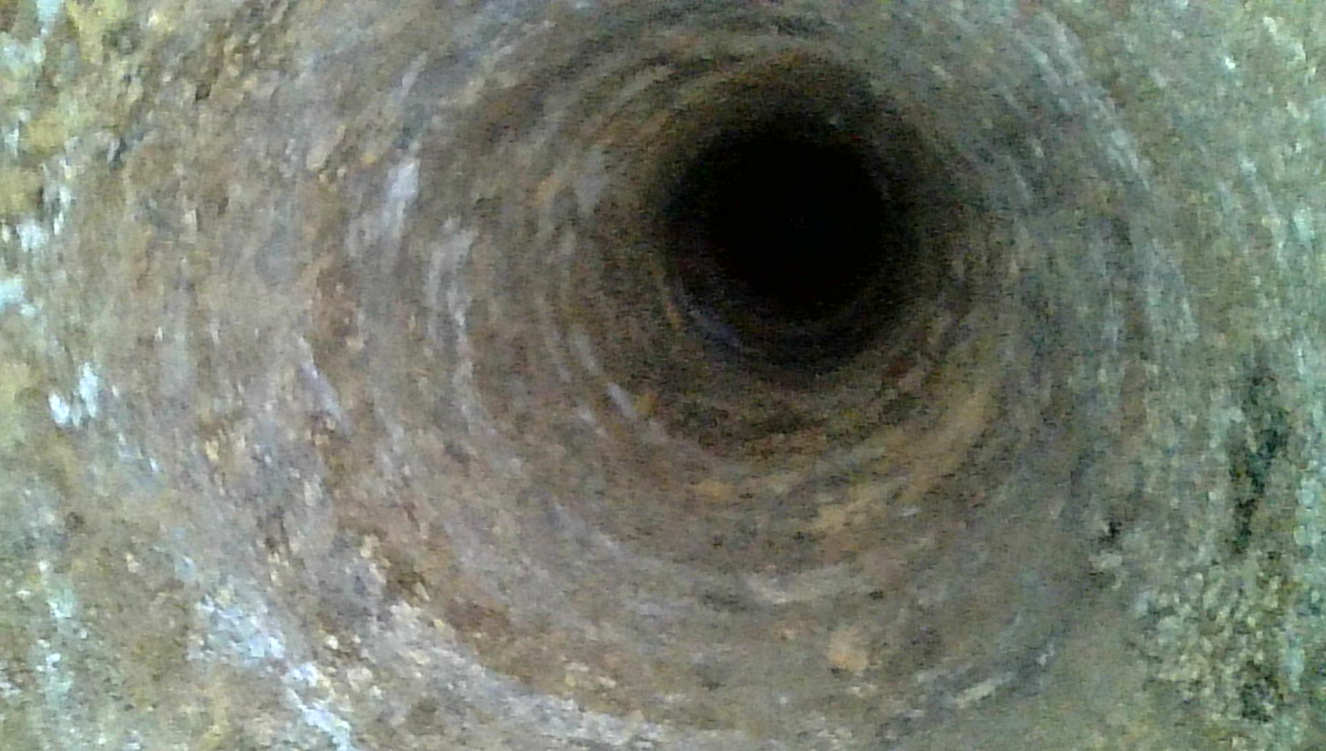

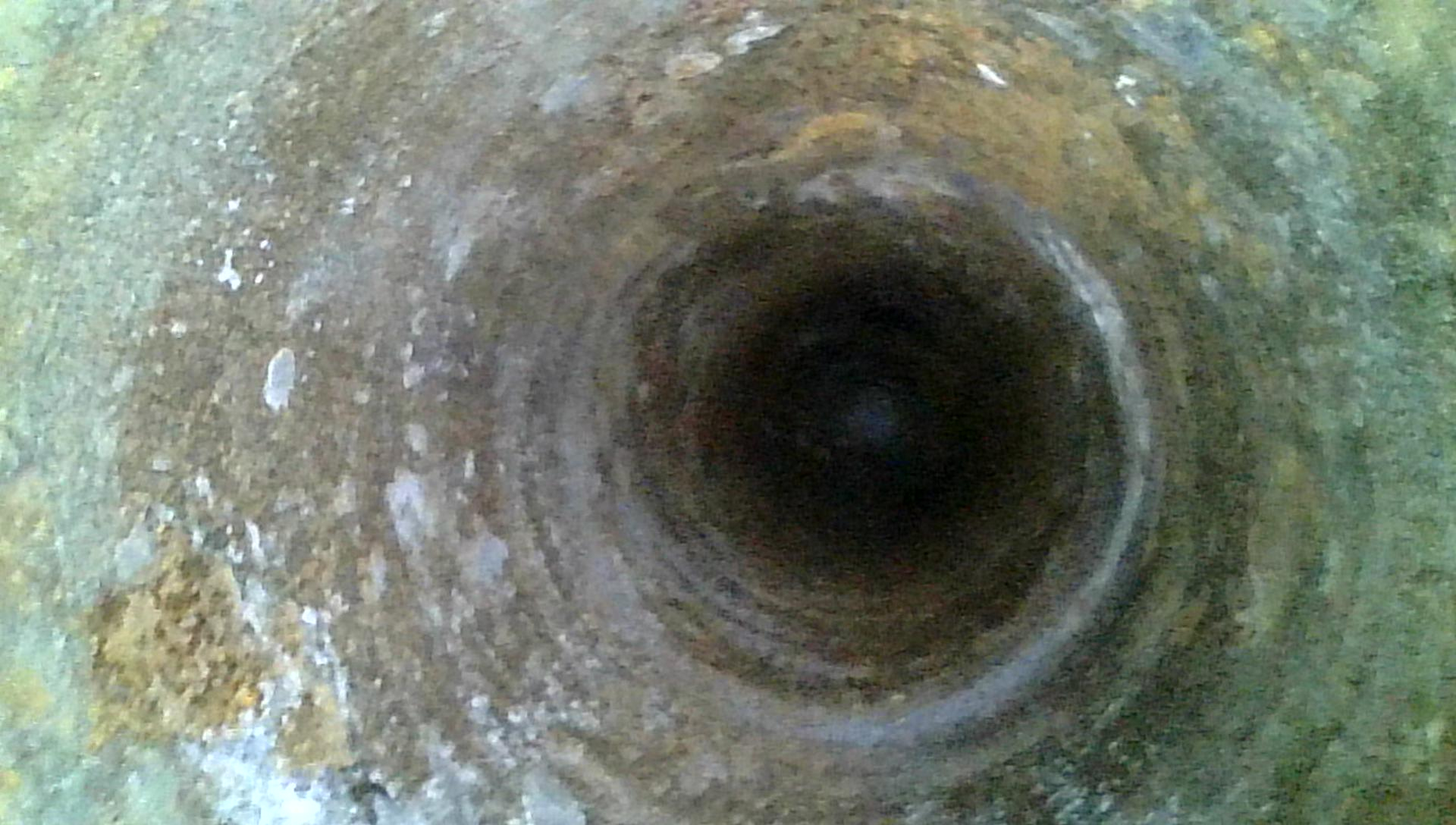

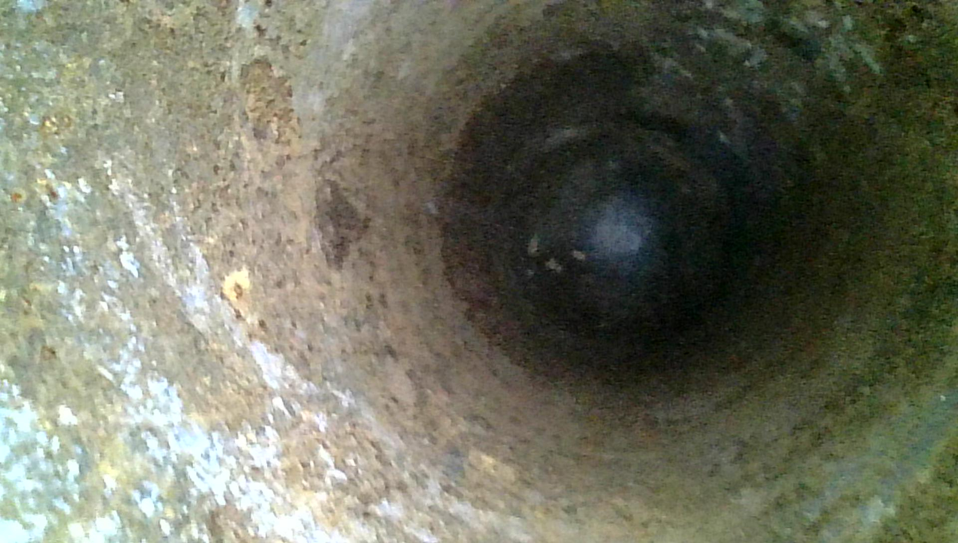

Now it's time to take my borescope back down.... this was AFTER a brief running of the hone. To be honest, I don't think I had the hone firm enough but prefer to go slow so I'm ok with that.
Deeper and deeper...I see a shadow....
This is where I started thinking in the back of my head... WHAT the heck is that? Is the back of the bore nice & shiny? Is it a semi circle to help propel the charge forward? I don't know...
and there is the other ball.
I've since cleaned it out some making it easier to see but that was after i took the picture.
Off the cuff, the ball is NOT moving at all. I'm currently letting it soak overnight. I might just drill it out tomorrow if I get fed up with it.
So that's where I currently am. Oh, and I noticed the ball in part because before I put scope down, I put flashlight on flash-hole and did NOT see any light in the cylinder. That perplexed me causing me to go down via scope.
