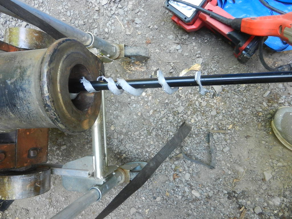

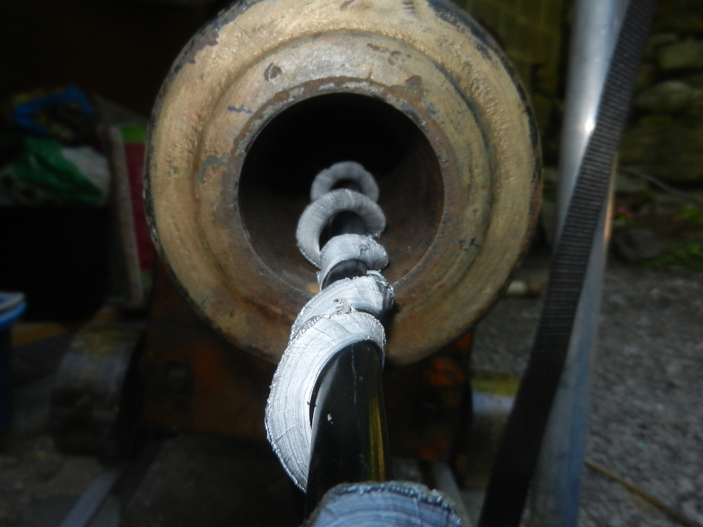

Still.... I appreciate the thoughts. Rest assured....one way or another the ball WILL be out at some point. It's just that my first priority is to not destroy it during process if at all possible. If not, then the job becomes much easier because I can drill into it but, don't really want to.
So, I've got a wood boring bit (the kind that pulls itself into the wood) Milwaukee 1/2" right angle drill and an extension that just happens to let all this work.
Hmmm...can the pointed bit 'catch' the ball? YEP! Can it drill into it and can the auger part drill into it? YEP!! Now I'm getting excited.
The ball at one point, rotated WITH the bit. So the ball was rotating in the bore. I'm feeling this is good as it's not bound. So I start pulling the bit out. I get shavings crawling up the extension then bzzzzzzzzzzzzzzzzzzzzz and nothing, no force against the torque... it's like the bit snapped?
Nope.
Turns out the bolt that holds the chuck on, snapped so the drill was moving but the chuck wasn't.
The ball is still stuck in the bore BUT it's much closer to the exit. It's gotta be close enough that once I get this chuck fixed, I'll probably be able to finish the hole and then I'm thinking take a sawzall to weaken it up and possibly cut it into quarters or maybe half.

Since you have a 2.2" bore why not use a 2" hole saw to reduce the outside diameter of the ball? Since it's lead it should remove pretty easily and not hurt the barrel of the cannon.
