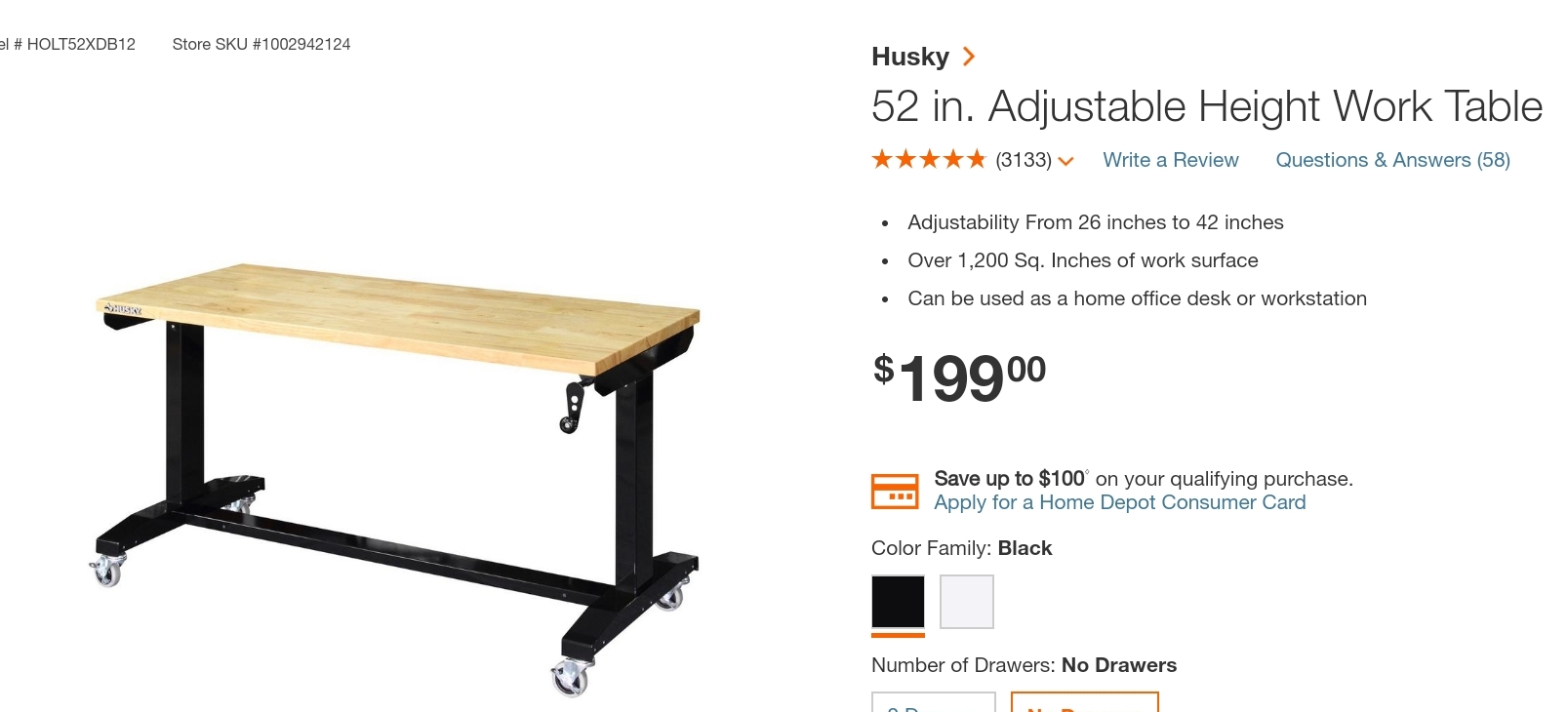

Seen these adjustable work tables at Home Depot. Very well built and 300 pound capacity. Not for hard pounding or heavy work. Looks like a good solution for lighter work and being able to adjust height.
/ Ideal height for new work bench #12
I can see the advantage in being able to adjust height. My favorite 3 benches are 36, 38 and 40" tall. I'm 6'. All of the benches are very sturdy and not adjustable.
Even though there is only a few inches different in height, I find that it makes a big difference when I'm working on something. I might even move the project around between benches until the height is comfortable.
