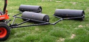

I ganged three 4' rollers together to get about 11' of coverage. Works pretty good. See attached. I built a new frame for the front roller to gain strength and an attachment point for the outer rollers. Also extended the attachment bars of the outer rollers.

That looks like what I had in mind except I think your design looks better than what I had in my mind. Thanks for sharing the picture. What brand of rollers are those, or how much do they weigh?
