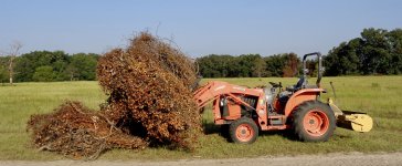

Consider if Pallet Forks will not serve in lieu of a grapple. One heck of a lot simpler and probably very useful to you for moving gear besides treee debris.

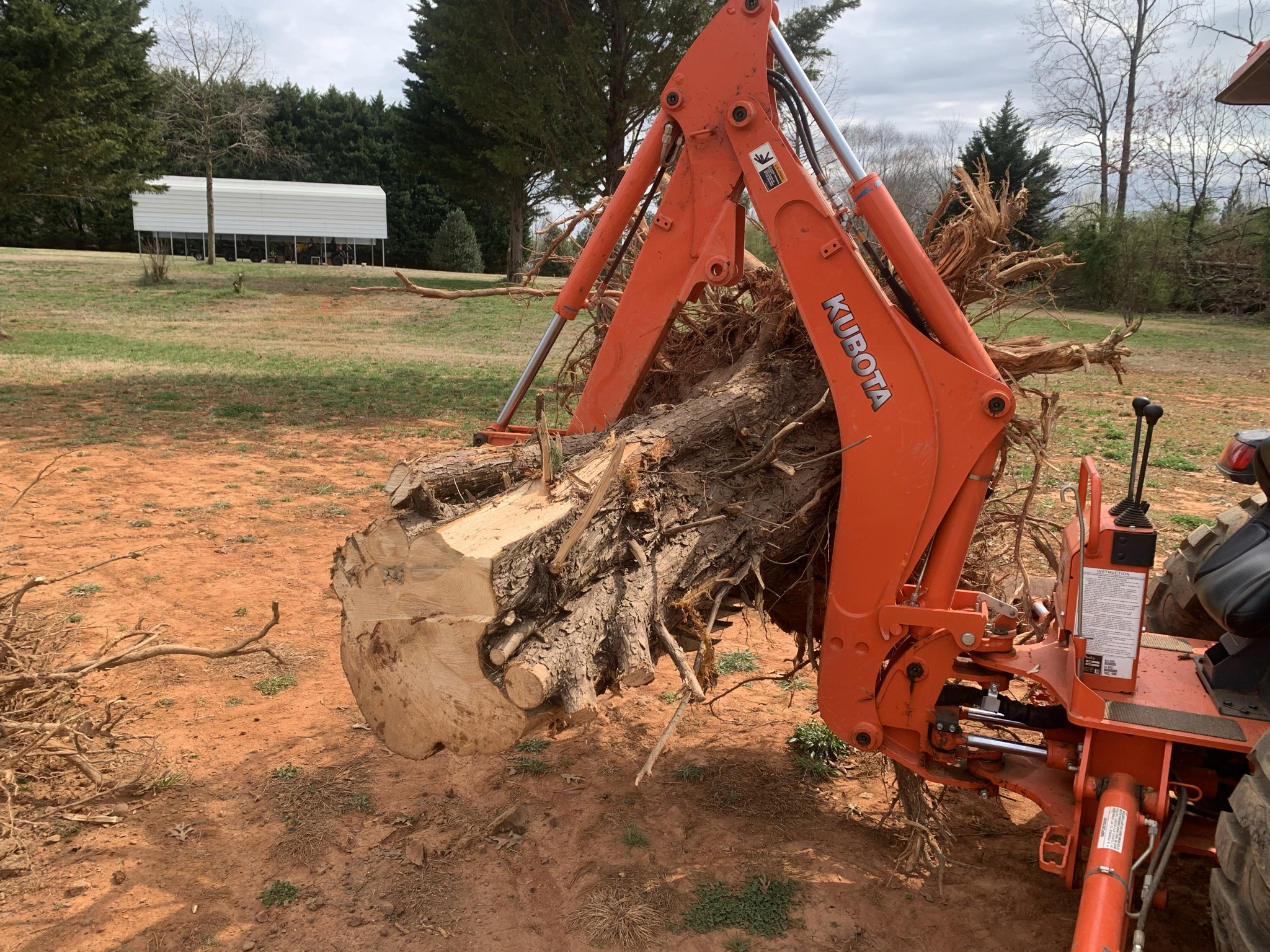

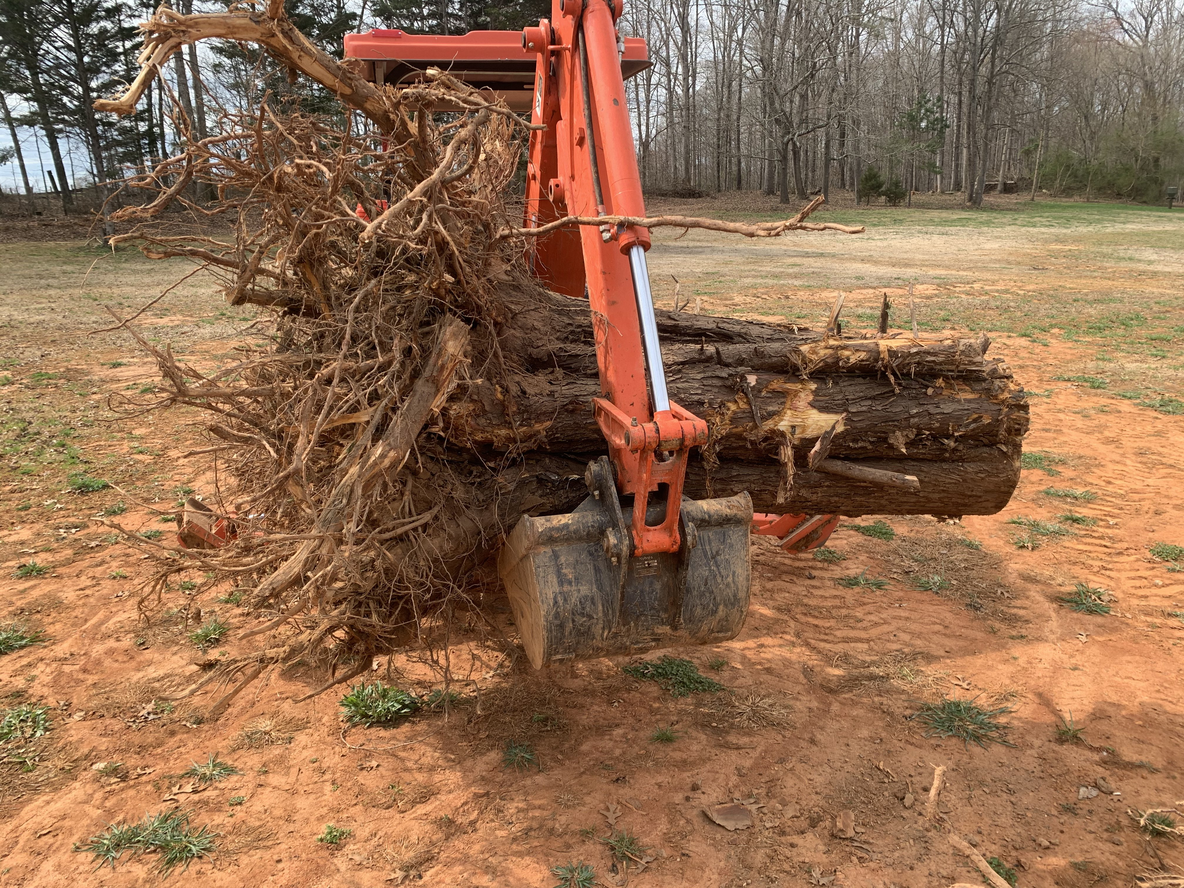

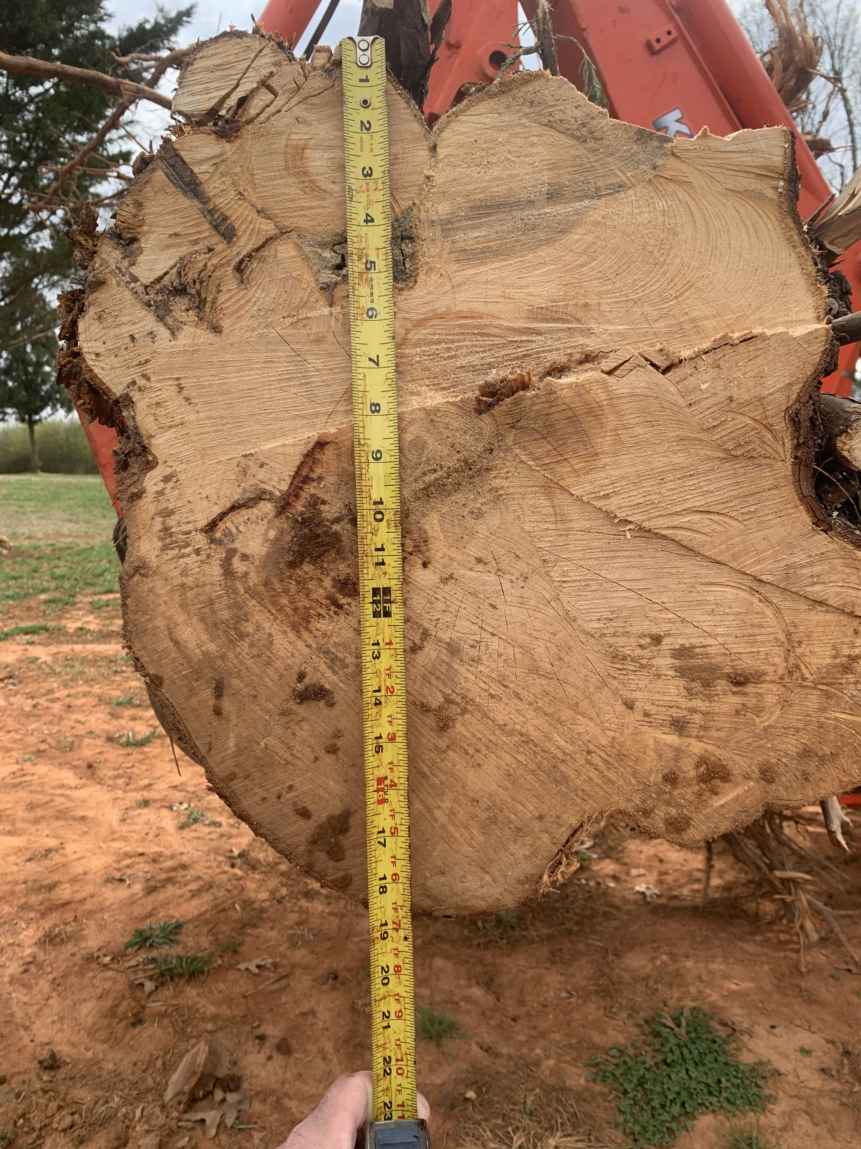

Definitely get pallet forks I have a set rated at 4K one of the most handiest implements to have... I also have the BH 92 it’s very handy as well !!!

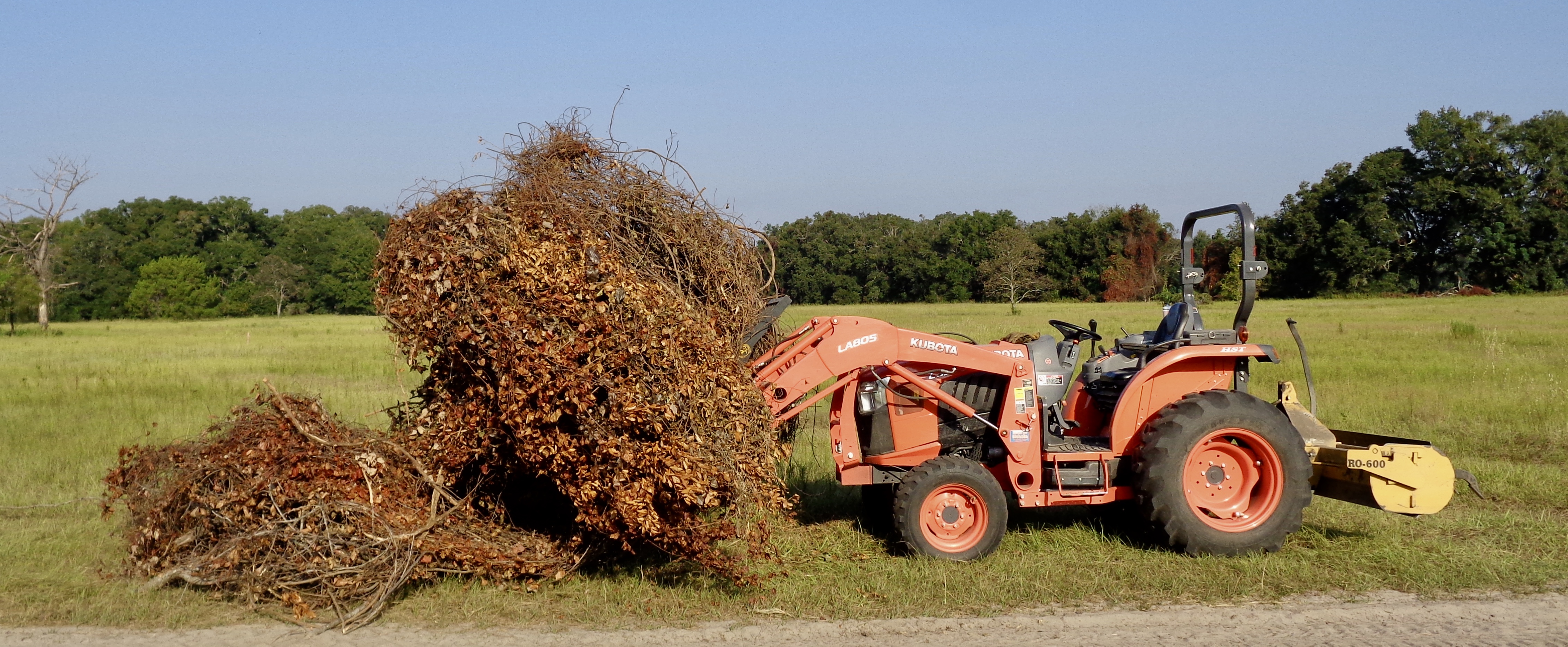

SSQA equipped FEL allows you to switch between SSQA bucket and SSQA pallet forks in just a minute.
If your FEL is not SSQA equipped there are a number clamp-on-the-bucket pallet forks out there.
36" to 38" tine length is more maneuverable than 42" to 48" length.
Easy change of fork spread is desirable. Narrow spread for small brush piles. Wider spread to increase stability when moving tree trunks.
SSQA pallet forks come with an operator guard. Clamp-on pallet forks do not.
Sooner or later everyone with clamp-on forks has a log roll over the bucket and land on the tractor hood, hopefully without injuring the operator. (Ask me how I know.)
Also research Three Point Hitch mounted pallet forks. You can only lift loads 24" but the load is safe in back of the tractor. Logs cannot hit you. Vines cannot get under tractor wheels. You do not need to drive in reverse in order to see, with really large brush loads, as you have to do occasionally with FEL pallet forks. PHOTO
You will have to adjust attack angle of TPH forks using the Top Link.

I have the same BH. Use it almost every time I use the tractor because i'm constantly diggin tree stumps.
When it goes into regen, i crank it up even farther and go find a huge stump. The controls are kinda twitchy at pto rpms!
