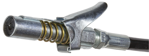

I'm also on the lookout for a zerk connection to my grease guns that allows easier on and of connection that doesn't rely on push and pull pressure. I've seen pictures of it but never seen one in a store.
This is what I use on a lever gun with a flexible hose: LockNLube | Grease Gun Coupler. Free US Shipping over $25
Some old threads: http://www.tractorbynet.com/forums/oil-fuel-lubricants/304889-locknlube-cupler-grease-gun.html
The Review thread: http://www.tractorbynet.com/forums/owning-operating/307933-review-locknlube-grease-gun-coupler.html

The Lock 'n Lube is overpriced, just the connector costs more than a whole grease gun. The only thing more outrageous is how well it actually works. I love mine. It's a ripoff, but so worth it.
