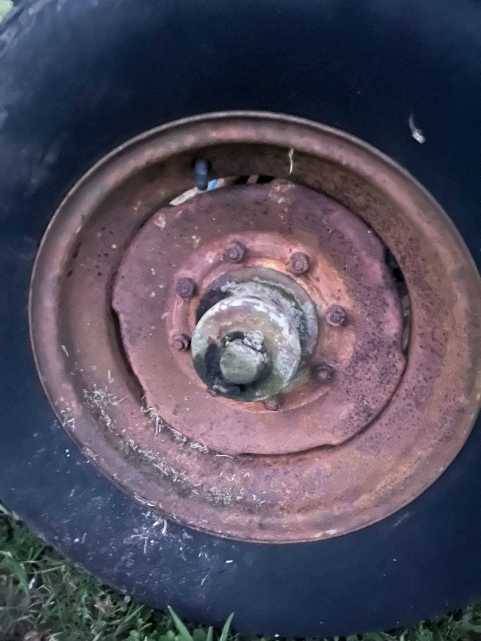

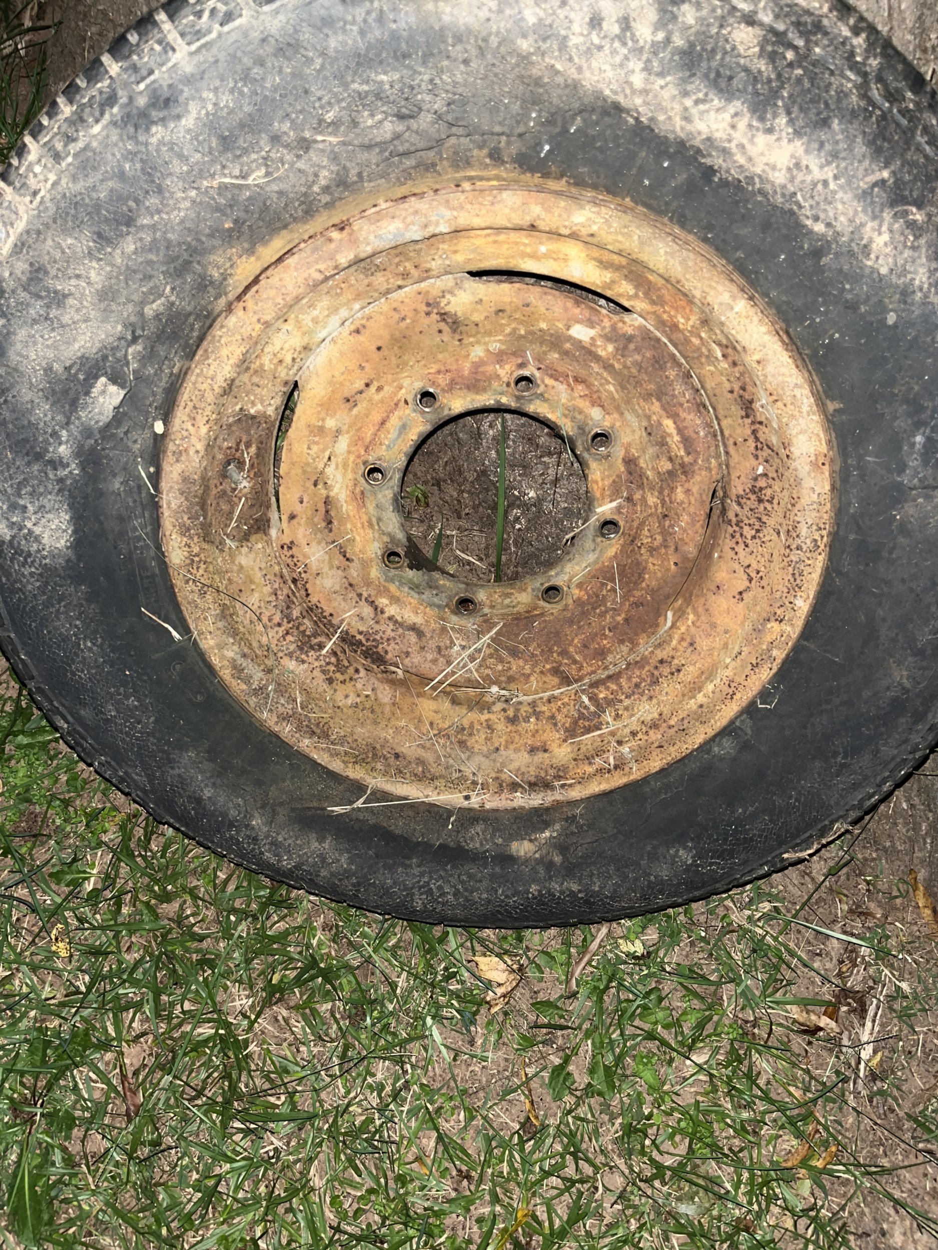

Anyone know what wheels will work on a McCormick M drill that has rubber tires aka low wheel.
The part number in my manual is 453 631 R91 for 15” wheels and 16 632 W for 16” wheels.
They are 8 bolt wheels and the center hole a bit less than 5.25” in diameter.

Well after welding the area around the valve stem on the one wheel I have a working McCormick M grain drill. I planted 2.5 acres of rye with it today.
Note 225/75r15 tires are too wide as they rub on the drive end of the drill. It had 215s on it but couldn’t find any of them.
