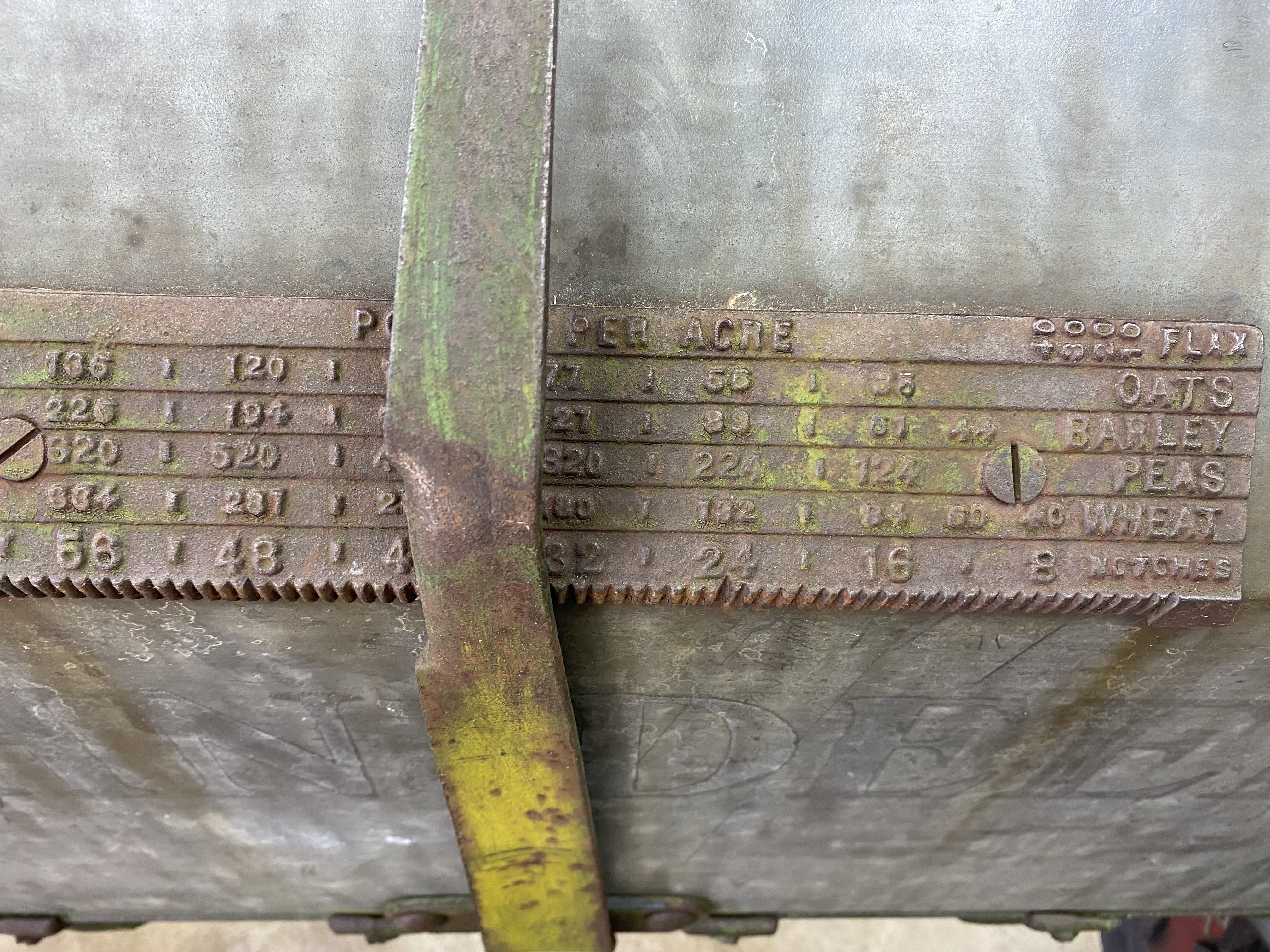

I just purchased a van brunt grain drill that is double disc with 6” centers. It is a 5’. 10’ cut in half. I am looking for the seed chart but I don’t know what model this is. It does have a steel plate showing some settings like wheat but it doesn’t have rye or sun flowers. Any help appreciated.
/ Van brunt grain drill model #2
It would help to ID your drill if you would posts a couple of photos. Is your drill grain only or combo of grain & fertilizer. Rye & Wheat seed should be close to same setting unless you're referring to Ryegrass. It will surprise me if you can locate a seeding amount for Sunflower seeds.

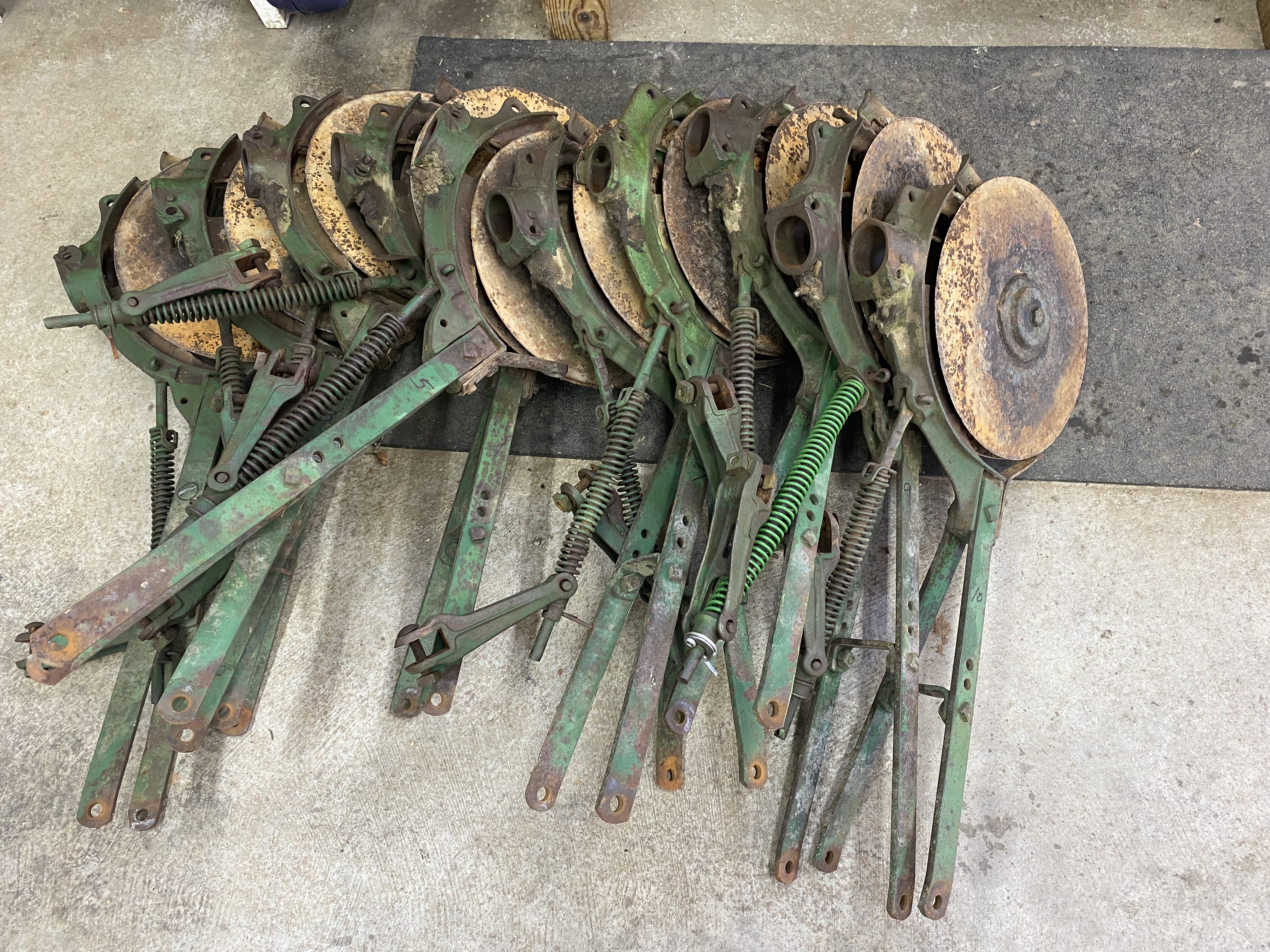

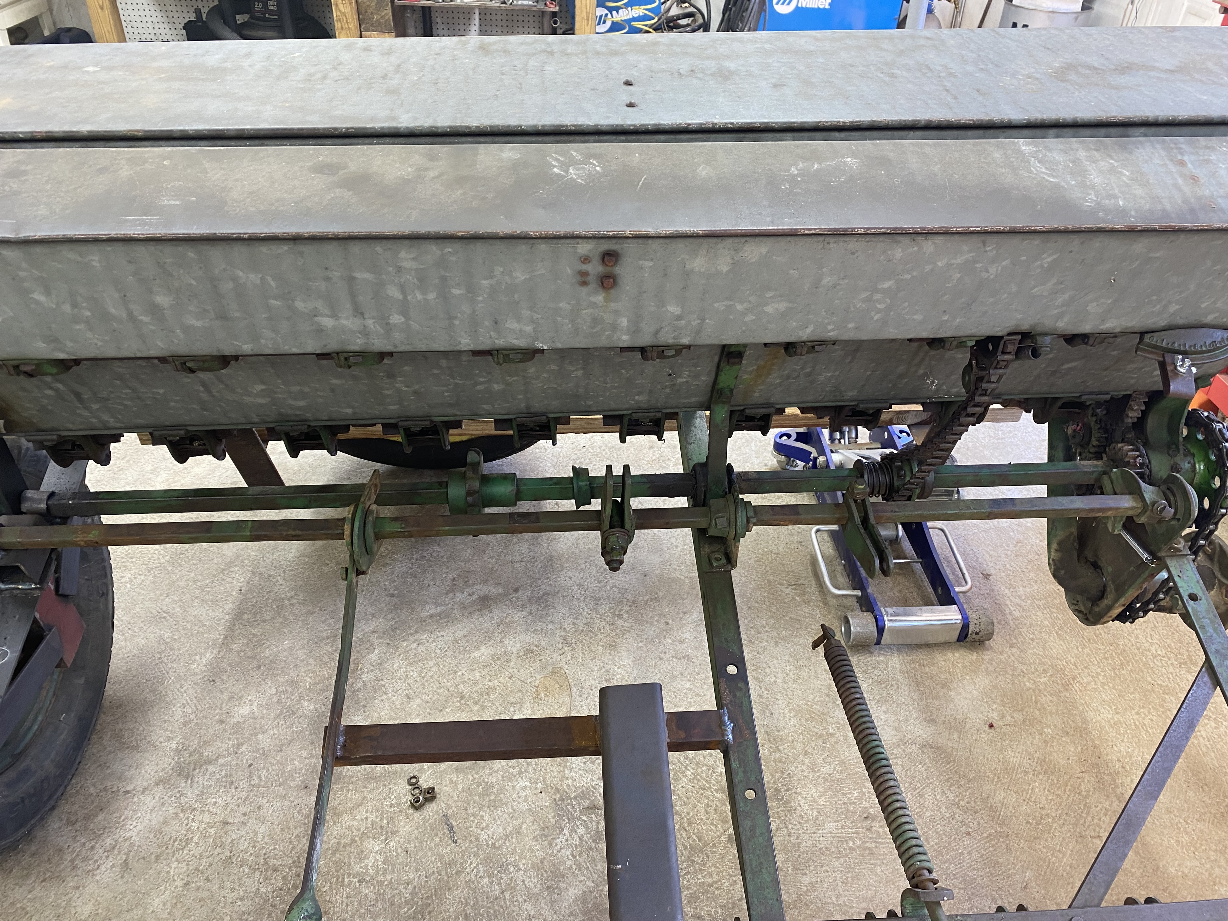

No fertilizer. I have it apart now as I am going to paint it. See attached photos.

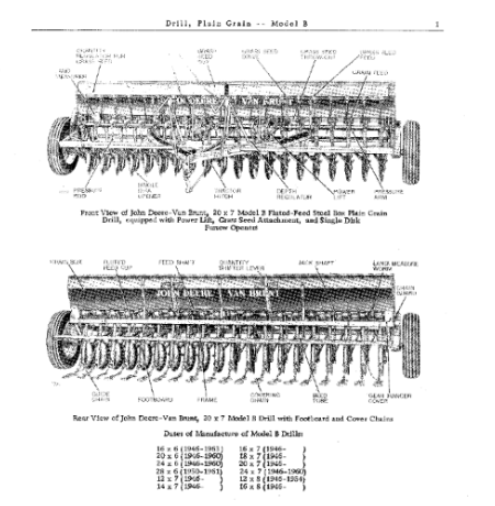

Model B I remember unloading those drill components from a railroad box car then after transporting them to JD dealership assembling that model of drill ack in the late 1960's

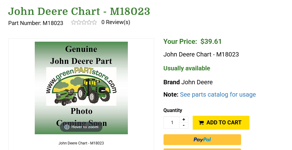

Would the seed chart be available if I do a search for model B then.
/ Van brunt grain drill model #7
Seed chart for Model B grain drill is part # M18023. According to part search on @ JD dealer chart is still available to purchase from JD.
