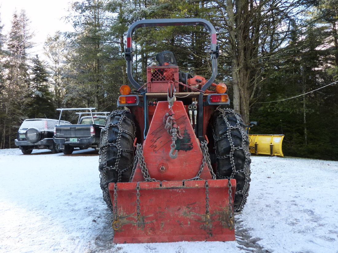

Just wondering if anybody that uses ice chains keeps their tractor in a garage with a finished concrete floor.I have a chance to buy a set of ice chains for a good price but I am thinking they might damage my garage floor.I am talking about the chains that have studs welded to them to give traction on ice.My tractor is an L 3240 with FEL,backhoe and loaded tires that weighs about 7500 pounds.

I use a piece of 1/2" cdx plywood and lay down a couple strips on the apron when I back out. I have forgotten a couple times and there are a few small chips on the edge of the apron. A piece of old carpet also works good. Available free anywhere they install carpet.
