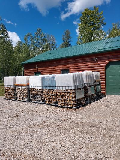

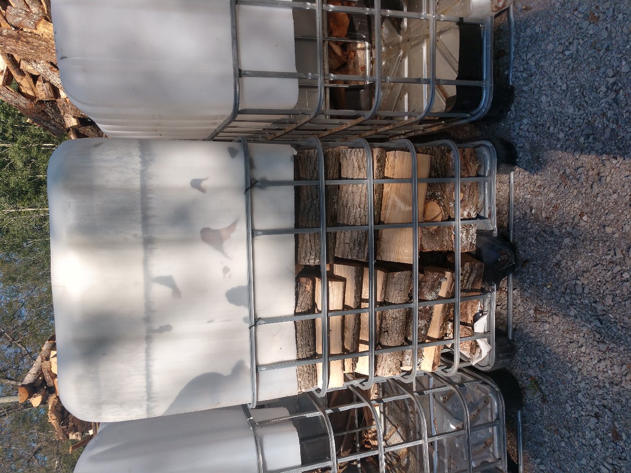

Here is how I do firewood:
Less plastic to dump, more capacity and provides weather protection.
View attachment 682465View attachment 682464View attachment 682466
Hello Shooterdon - Very impressed with the way you cut the bladders as shown in your picture #3. Since a tote that is filled with wood that is level to the top holds 3/8 of a cord - I estimate that I could hold 5/8 of a cord in each tote if I cut bladders in same manner as you. I am currently storing my wood in 20 totes and therefore could store an extra 5 cords in the same amount of space. Thanks very much for a great idea.

It takes about 45-60 minutes to modify one. Mine hold just under 1/2 cord. I have 32 totes...one just a cage. That gives me over two years of firewood. I used zip ties to attach the plastic bin. I am 70 so needed to find an easy way and cheap way. I doubt I will ever need more in my lifetime. I have $800 invested.
