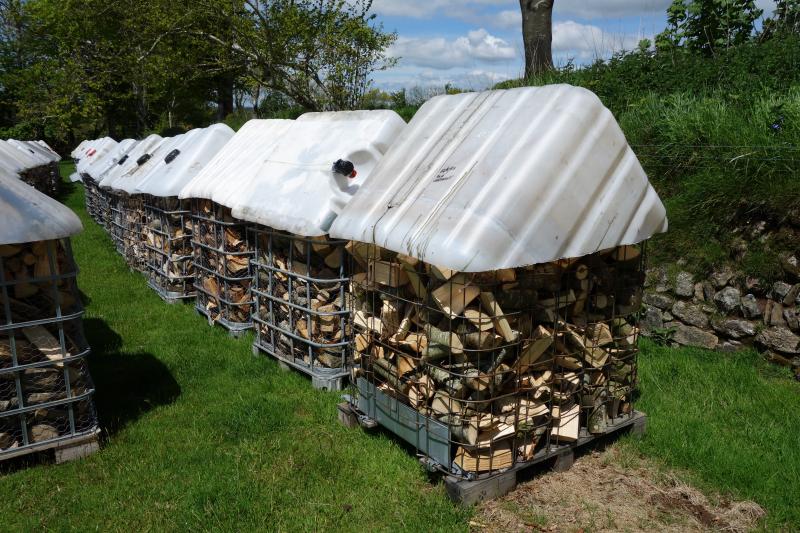

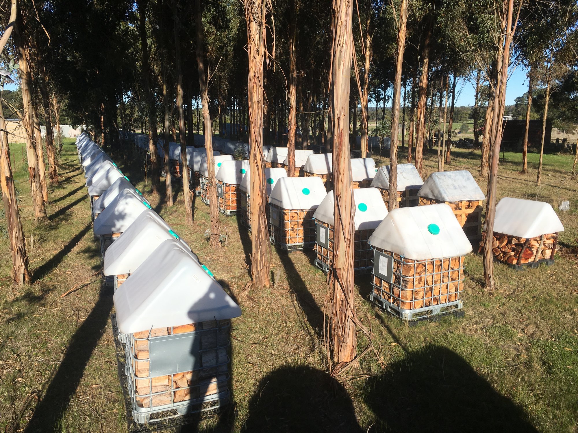

At $30 ea I'd buy a lot. The best price I've found locally is $60. I've for 8 set up for firewood and another as a man cage. I could use another 6-8 for firewood. Last winter I burned about 3 cords.
I cut the bladders up and heat form them to make rain covers. My covers are larger than most people's (I remove only one of the six sides) but they have enough air flow to evaporate any condensation and allow the wood to continue drying when conditions are right. Here we have a 6 month rainy season and a 6 month dry season. I take the covers off for the dry season. My firewood ends up nicely dry after a summer and stays dry in the winter with the rain covers. The cages get a door cut in them for easy stacking and removal of splits.

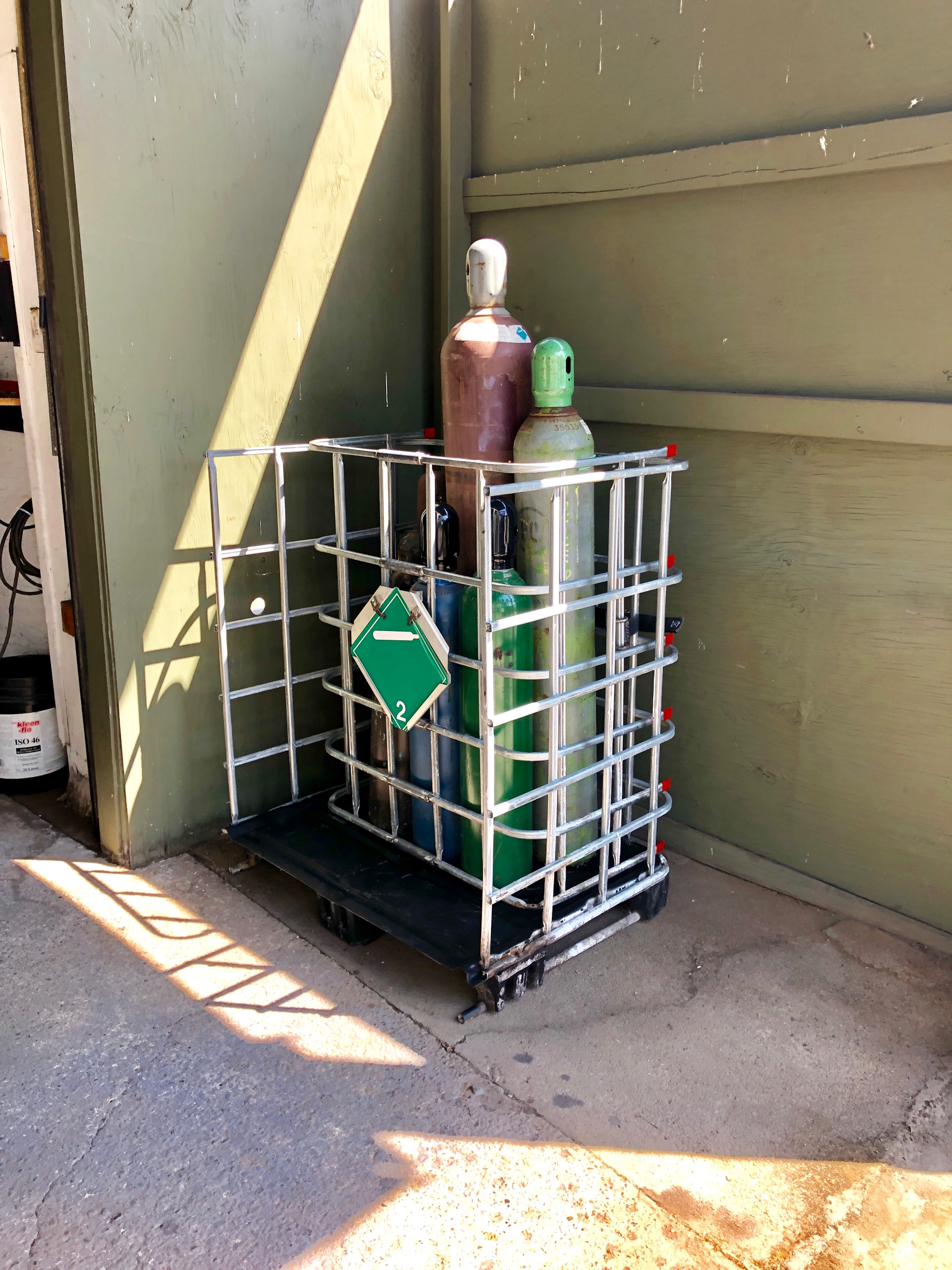

Fortunately i got one from my fertilizer supplier WITHOUT a bladder () for free.
I used it to make a storage cage for welding gas tanks.
Consider the idea stolen! Actually for firewood to come up to the house. Too simple.

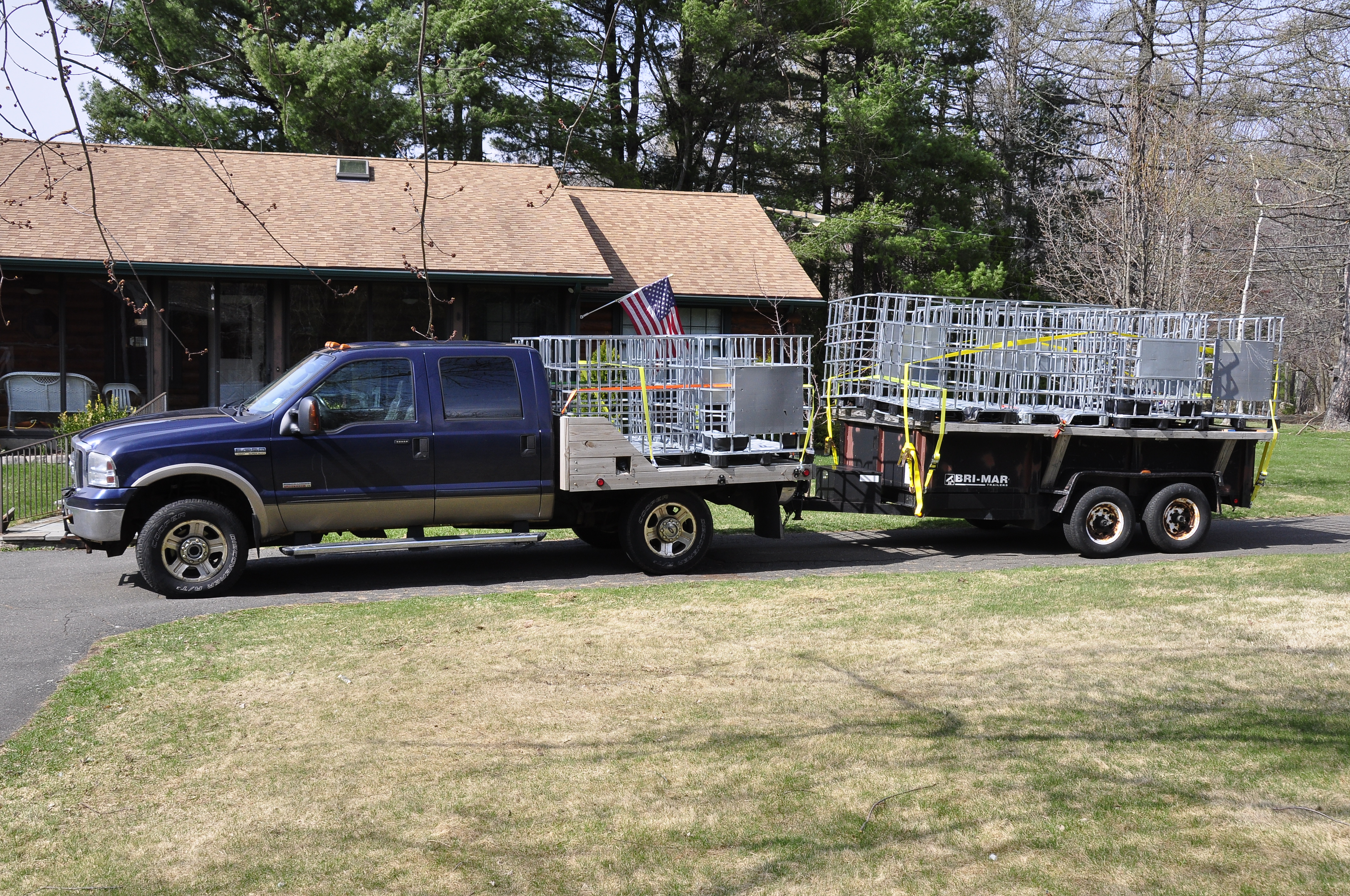

Sure, I neglected to consider your location in my response. But still, if you have more, you can fill them all up whenever you produce a big batch of firewood, and then never have to move the wood again (by hand, anyway) until you're ready to burn it. I got 12x totes on my 6x12 trailer, stacked two high. Unfortunately I didn't expect to burn through all 12 totes in a winter (sometimes do, sometimes don't - still have 9 full ones for this winter... we'll see).

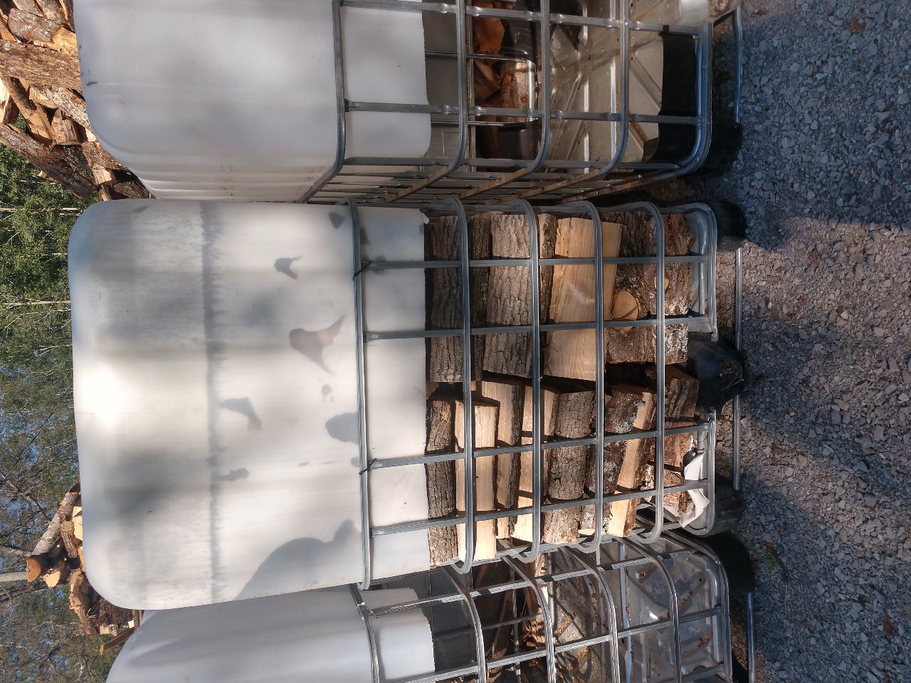

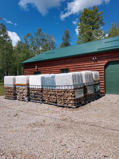

Here is how I do firewood:
Less plastic to dump, more capacity and provides weather protection.

To be honest after seeing Don's idea I wish mine came with the bladders!! Great idea! But complete totes with the bladder are $35 to $50 around here. Then you run into the nasty stuff/cleaning issue. So I will deal.
What are some ideas for weather protection on these things for the folks who lack bladders? I find that just laying a tarp over it does not work because as you pull wood out the tarp loses support. I want a stand alone structure (which is why I love Don's idea). I think I am going to make a very light gable roof that attatches to the top of the cage and use 6 mil plastic or some of that clear poly roofing. Any other ideas
