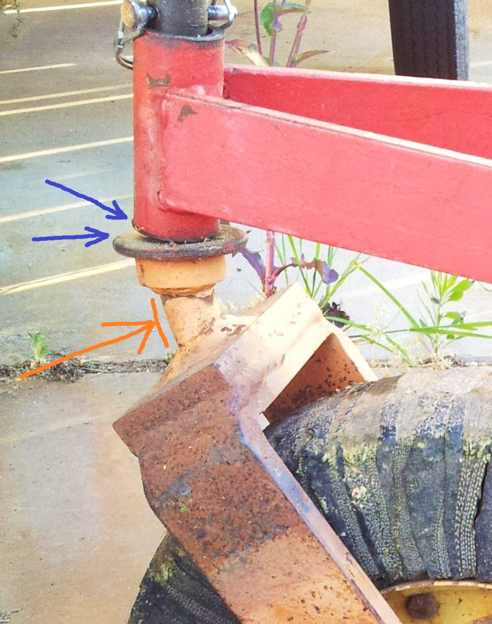

It appears that the yoke stem is bent at the blue arrows. The orange arrow points to what also might be bent. If it was meant to be that way, wouldn't it be easier and less expensive to just grind an angle on the stem where it welds to the yoke plate?
The second photo is my Bush Hog Squealer 480. Slightly different design but note that the stem and yoke plate are built at 90 degrees to each other.
Your mower's tail wheel was in a collision.

I could care less about the tail wheel assembly. Its hella expensive to replace.
There is a second set of bolt holes farther back on the mower deck that he could move the tail wheel arms to.
He would have to relocate the up/down adjustment for the tail wheel, but given the nature of most hobby farm people, that may be a much simpler and way cheeper fix than buying a new $100+ tail wheel assembly.

Certainly bent and, I would want a washer at the top for the pin to bear on...the variety of other pics posted of other designs illustrate the difference between "caster" and "kingpin alignment" IMHO.
The weld of the fork onto the (should-be-) vertical shaft seems like a refit and if there is some slop between that shaft and its tube, I'd suspect someone welded on an undersized shaft ...which has allowed it to be bent ...it should not be a sloppy fit but snug w. just some space for grease. This retrofit of the shaft would account for it extraordinary length (w. no other through holes for fastener)
   / I think my tail wheel is too big #68
The only problem with this tailwheel is a bad previous repair job. Someone has lengthened and stepped down the diameter of the shaft before the weld to the yoke. This is weak and has bent, resulting in the excessive caster and interference with the deck. Just get a new shaft/yoke unit with the same diam. shaft--should be less than $50. A Land Pride or Bush Hog one would probably work. It looks like the tube at the end of the arms is worn at the rear also. Fabricate a new one to the length required by the shaft/yoke unit you buy. Drill and tap a grease fitting and keep it lubricated. Don't try to salvage the messed up shaft/yoke by heating and straightening. It will be even weaker than before and will quickly bend, leaving you right back where you were.
