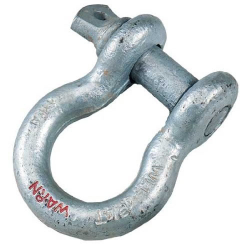

Get yourself 3-4' of 1/4" chain and two clevises such as the one pictured. Now you have an adjustable flexing top link -- cheap!
