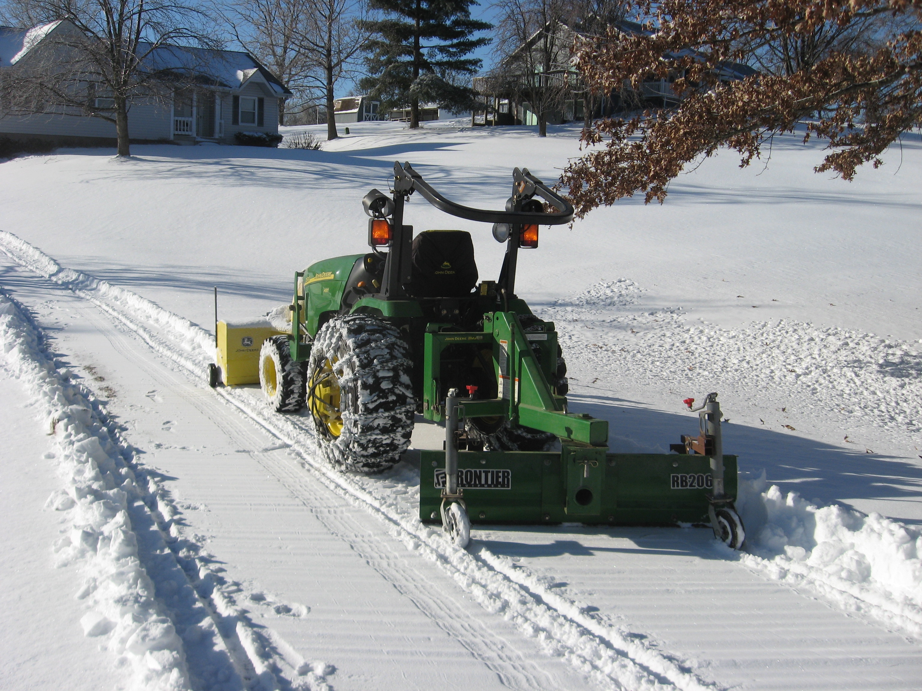

You can put gauge wheels on the rear blade to hold it up a little. I keep mine 1.5" off the gravel and have very little disturbance of the surface.
Also, if you're plowing with your bucket (and don't have edge tamers) you can set your bucket so the lip is about an inch off the ground and then put it in float. It will ride over the snow and you can "bump" your dump/curl function to make fine adjustments to get it to dig a little more or less.
PS: Don't be too hard on yourself, I've been trying to do it for 17 years and still can't keep the rear blade from digging it without gauge wheels.
Are your gauge wheels home made or store bought?
I've been kicking around getting some training wheels for my Frontier 2084 blade.
I built them based on designs I saw here on TBN back about 2013. I think the trailer jacks and casters came from Northern Tool. I just drilled four holes in the base of the jacks to mount the casters. It originally had air-filled tires, but they only lasted about 5 minutes before shredding, so I replaced them with 8" solid rubber.
Also, the jacks originally pivoted, but I didn't think they were rigid enough and also they were kind of in the way when rotated to horizontal. I decided it was just easier to pull the pins to remove them completely when not needed/desired.
I lucked out and had two holes per side already in the blade to mount the receivers. These were actually just prototypes, I was going to build some better ones with genuine 2" trailer hitch material, but these worked so well, I just started using them. Didn't even paint them.
If you type "rear blade gauge wheels tractor by net" into Google, it will bring back tons of hits on designs from people on here. I'm pretty sure there is an old thread on the subject.

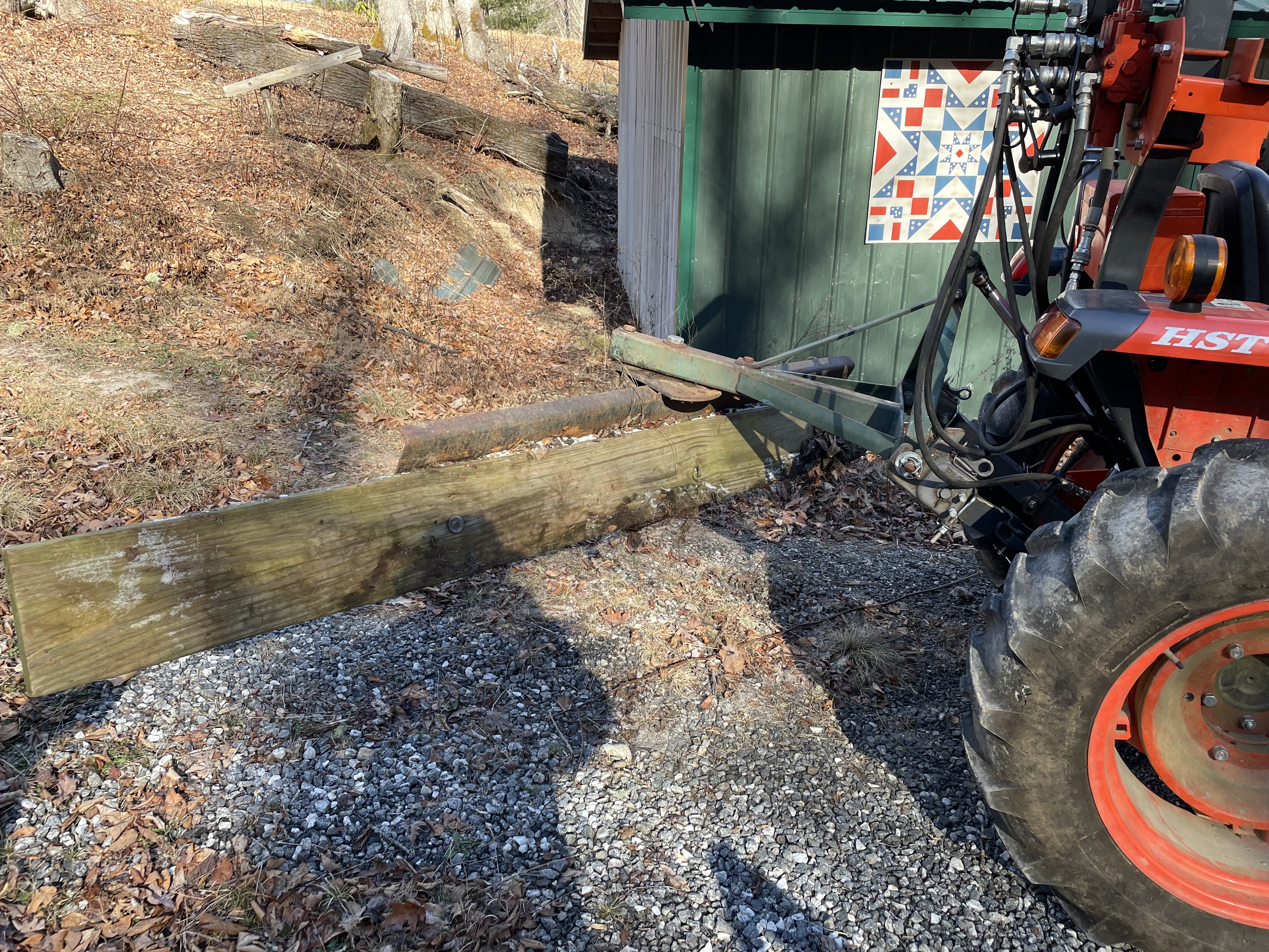

I bolt a 2x to the front of my blade; slightly lower than the cutting edge of the blade and longer for a better reach.
