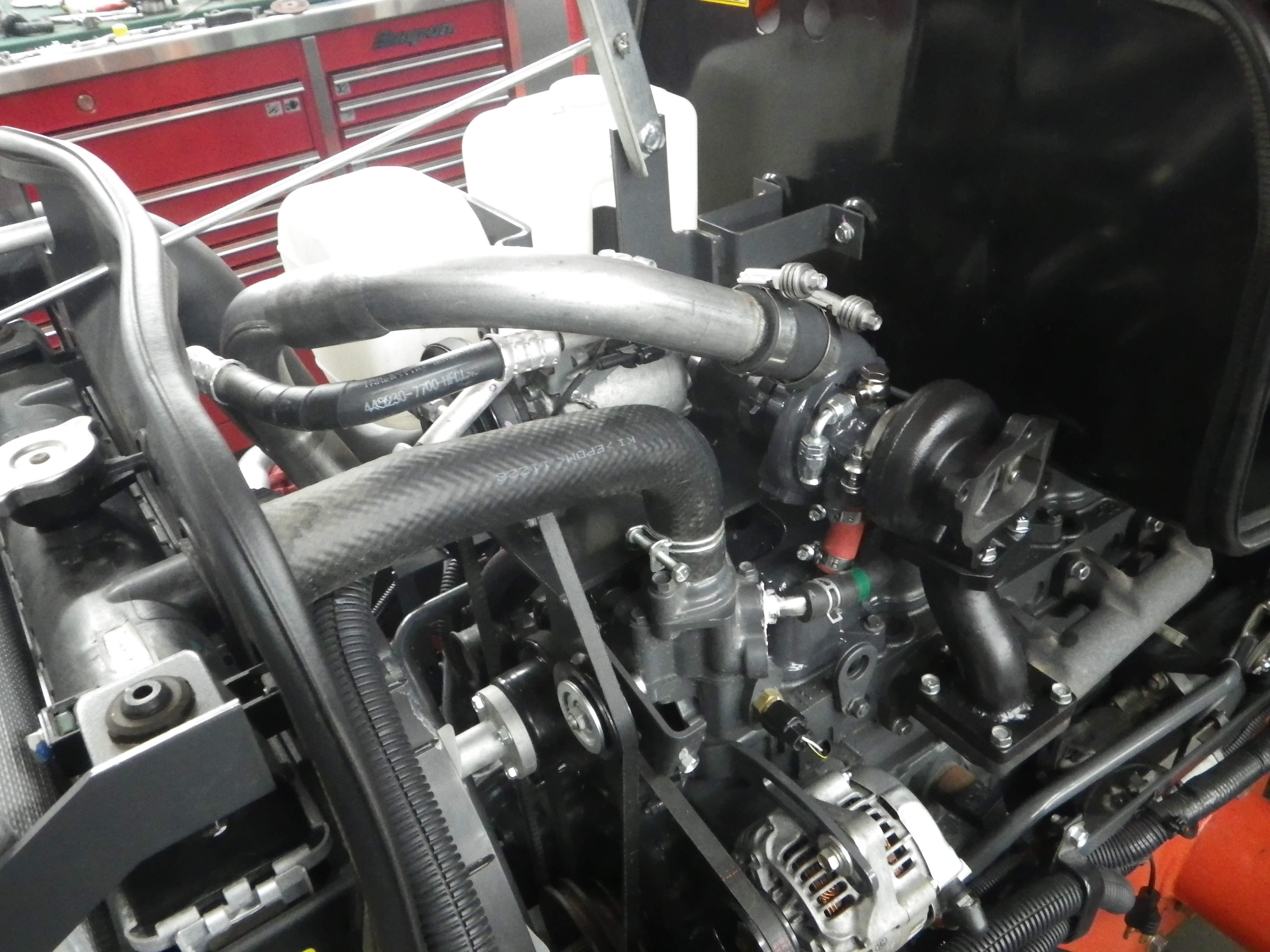

Let's talk cranking compression vs. leakdown test which I did both. Since the leakdown test showed almost no leakage from the cylinders through the valves/rings then cranking compression can only be low due to lower compression pistons or larger chambers in the cyl head.
I am happy for this as the turbo will only help. I would much rather turbocharge a lower compression engine than a higher compression engine.
NO fighting you guys, NO FIGHTING. If Aaron decides to pull posts again you can bet you'll never see the outcome. I have done lots of hot-rodding over the years, some results are good some just lackluster. I have a really good feeling about this one. Everything is coming together, I painted the turbo and assembled for the last time. I still need to make my 4AN oil feed line and build the high pressure pipe to the intake, and a makeshift exhaust until I figure that part out.
Thanks for watching
Photobucket is down so I'll give ya a little taste from tonight.
Fred

I would be interested in seeing what the compression specs are on the turbo version of this engine... Could you have turbo pistons or heads already for some reason? Hmm..
   / I Still Hate My Tractor #428
How is the turbo drain plumbed? Any chance the restricted banjo bolt belongs on the drain side, to hold pressure IN the turbo?

Fred make sure the oil supply for the turbo is after the filter otherwise it will be short lived!
On my Ford I had to install a filter plate to get an oil supply port then add a 10 micron hydraulic filter for the turbo.
90cummins
Will check this, I have to remove the oil cooler to button up some lines, wiring, front diff vent. I can blow air back though the block and see what side of the filter the oil is routed to. Thanks!
Not great pix, in a hurry tonight. Honeydoo list and beer caught my attention. there's enough room on the left side lower to drop the high pressure pipe out the old exhaust hole to use the brushguard as an intercooler. Hard to see but I kind of figured it this way. Even the hood prop rod doesn't get in the way. Everything should work as the factory intended including the windshield washers. ..well everything but the warranty:(
Fred

You have taken the oil supply line off the same port that kubota uses which is filtered unrestricted oil. You will have full flow full pressure oil from that port. As for the hole in the banjo bolt you will have plenty of oil feeding the turbo. Keep in the mind the holes feeding the crankshaft or cam are smaller than that.

Fred after reading and thinking about the posts the thought occurred to me that this particular engine may have been built for turbocharging and was possibly installed in the wrong application, or the pistons intended for a turbo charged version were mistakenly installed.
So installing this turbo will most certainly give you HP & Torque bragging rights without adding excessive stress to the engine.

[...] Everything is coming together, I painted the turbo and assembled for the last time. I still need to make my 4AN oil feed line and build the high pressure pipe to the intake, and a makeshift exhaust until I figure that part out.
Thanks for watching
Fred

Ordering factory banjo bolts today before starting, NO way I am taking a chance on the oil supply.
