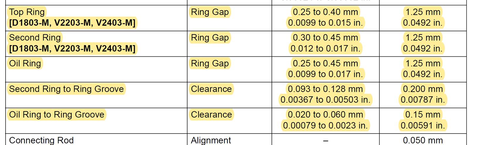

I'm curious what the stock ring land width is and what they measure now. Is there any chance they are setup with this much clearance from the factory?
Also curious if they run a bit more ring end gap on turbo motors.
Added in edit on 10/28/19
I couldn't find any difference in the specs for turbo and non-turbo with respect to ring gap or clearance.
Did find it interesting the top ring clearance was omitted from the specifications in two different places within the WSM.

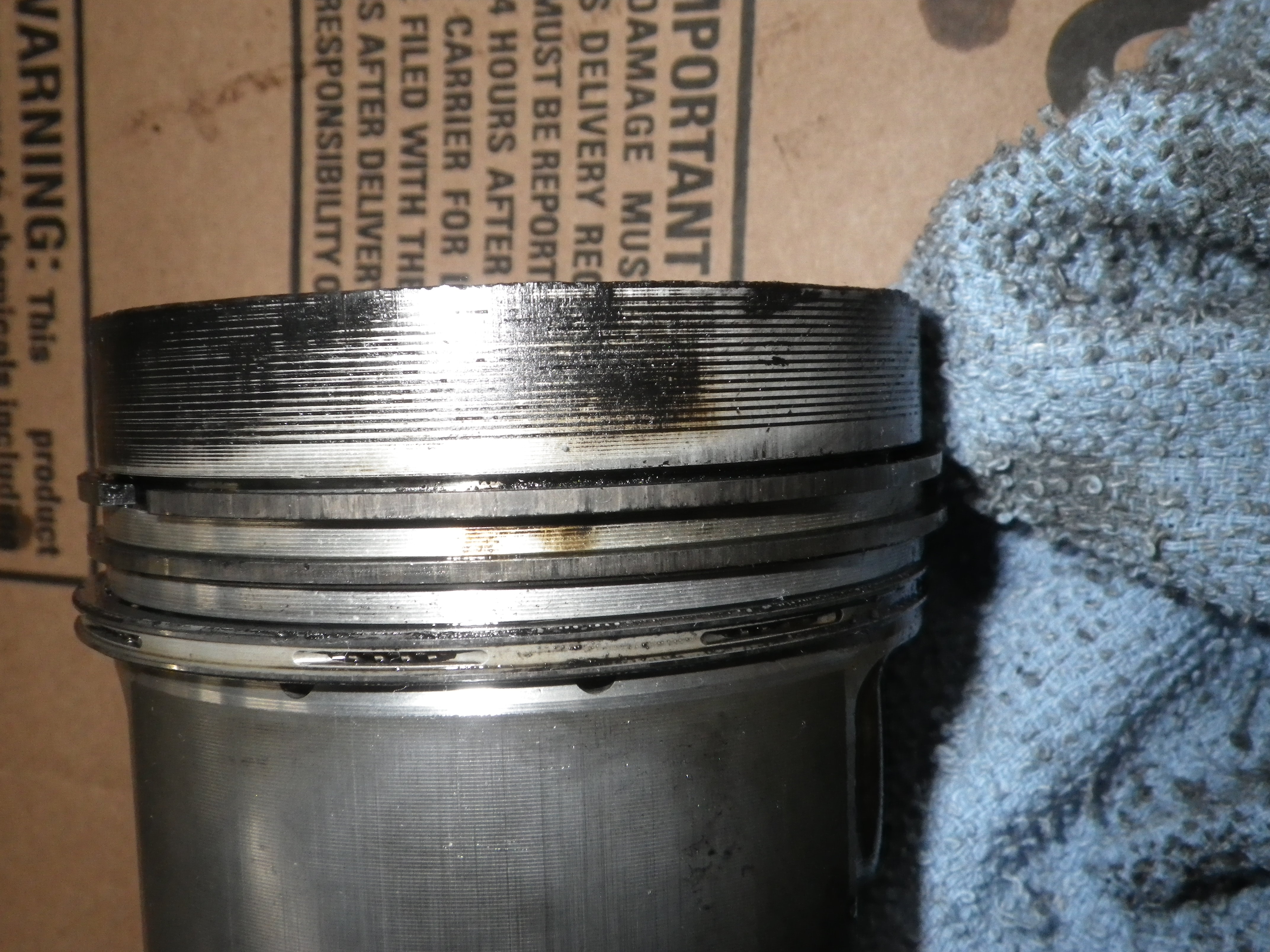

   / I Still Hate My Tractor II #384
This is what happens when you over fuel and boost an engine not designed for it. The wastegate is set at 6.5 pounds (factory).
Looks like I'll replace 4 pistons, rings and remove the turbo then sell it in the Spring because the power will be so bad.

Other than beating it badly while blowing snow it really isn't too bad. There's not any dents, damage other than crap faded paint. The service was done at about 1/2 intervals.
The axle leak problem will be fixed with a new driveshaft and seals and the engine will be tip top shape with new pistons and everything checked properly including injectors.
