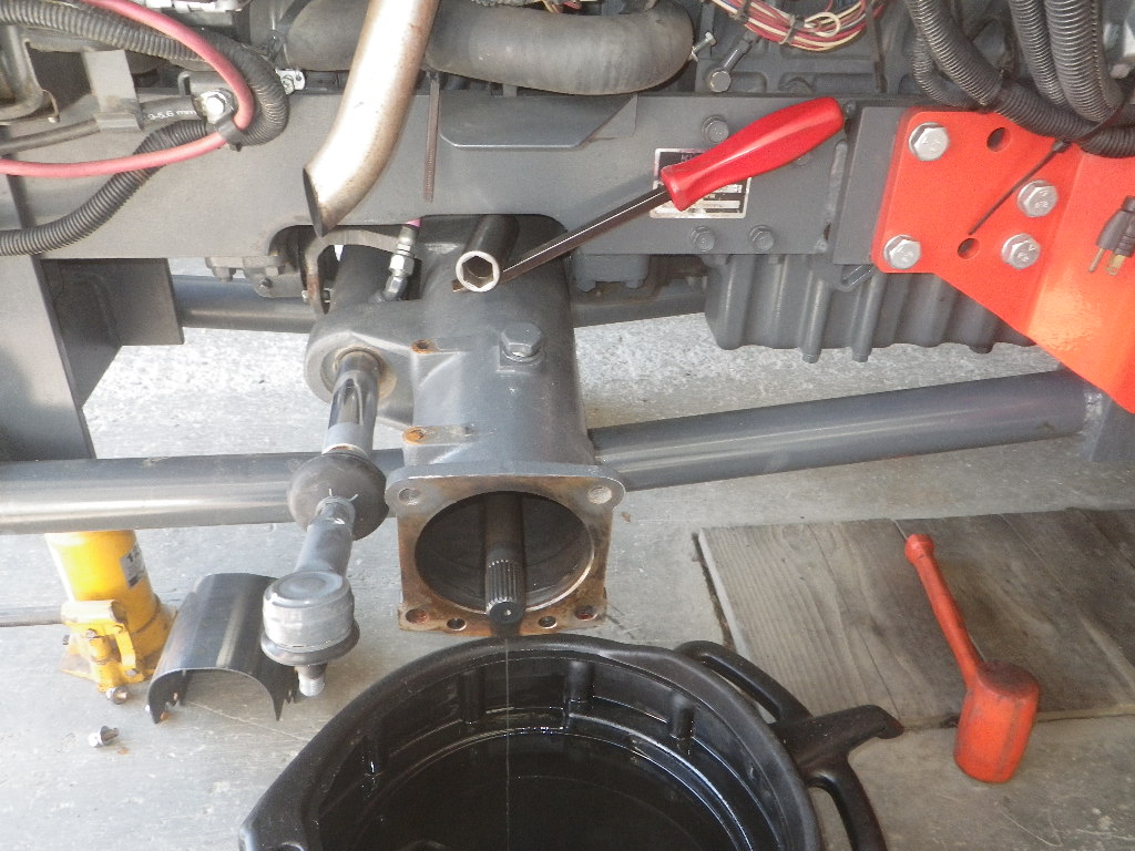

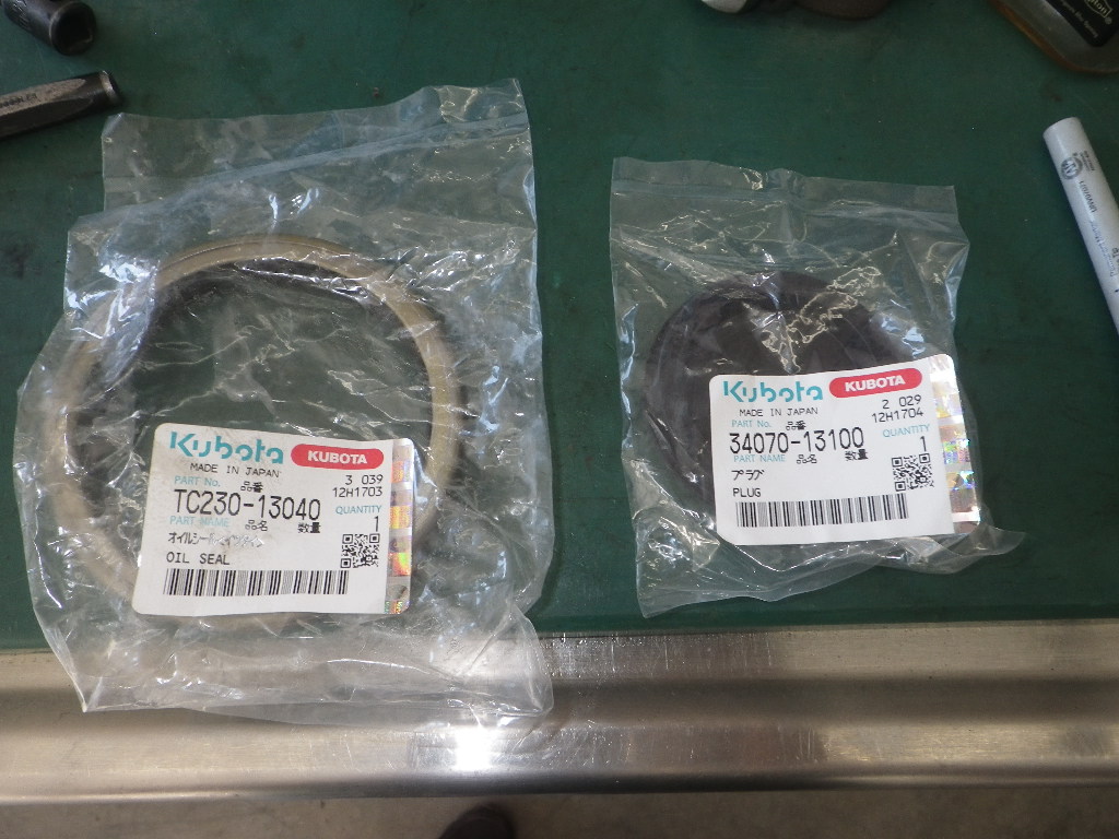

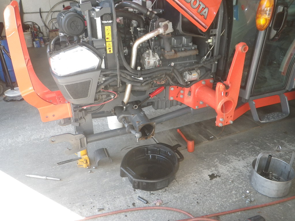

389 hours, turbo still doing it's job nicely.
Popped a front knuckle seal. Everything is oringed these days so all you need are 2 seals and a cotter pin for the steering tie rod nut.
Lots of metal in each lower front end final drive, there is only one way to get it out and that's to remove the lower seal/plug and drain it out, maybe flush it and refill. Then replace the lower seal plug.
Pix below and NO MORE GD PHOTOBUCKET for me, everything got deleted because I refuse to pay Googles blackmail fee!!!
Regards, Fred
And I do STILL HATE MY TRACTOR! 7 payments left and she goes bye bye.
View attachment 524594View attachment 524595View attachment 524596View attachment 524597
Seals blown at < 400 hrs?
No wonder you hate your tractor... Any extraordinary reason that seal blew at such lo hrs?

Rust on the sealing surface, I use the machine to blow snow and it gets put away in a heated building to thaw out, dry and that's what happens. I bead blasted the knuckle and painted it nicely. It's an easy job and would happen every few years I'm sure.
From now on I might spray the joints with oil or spray grease as a precaution.

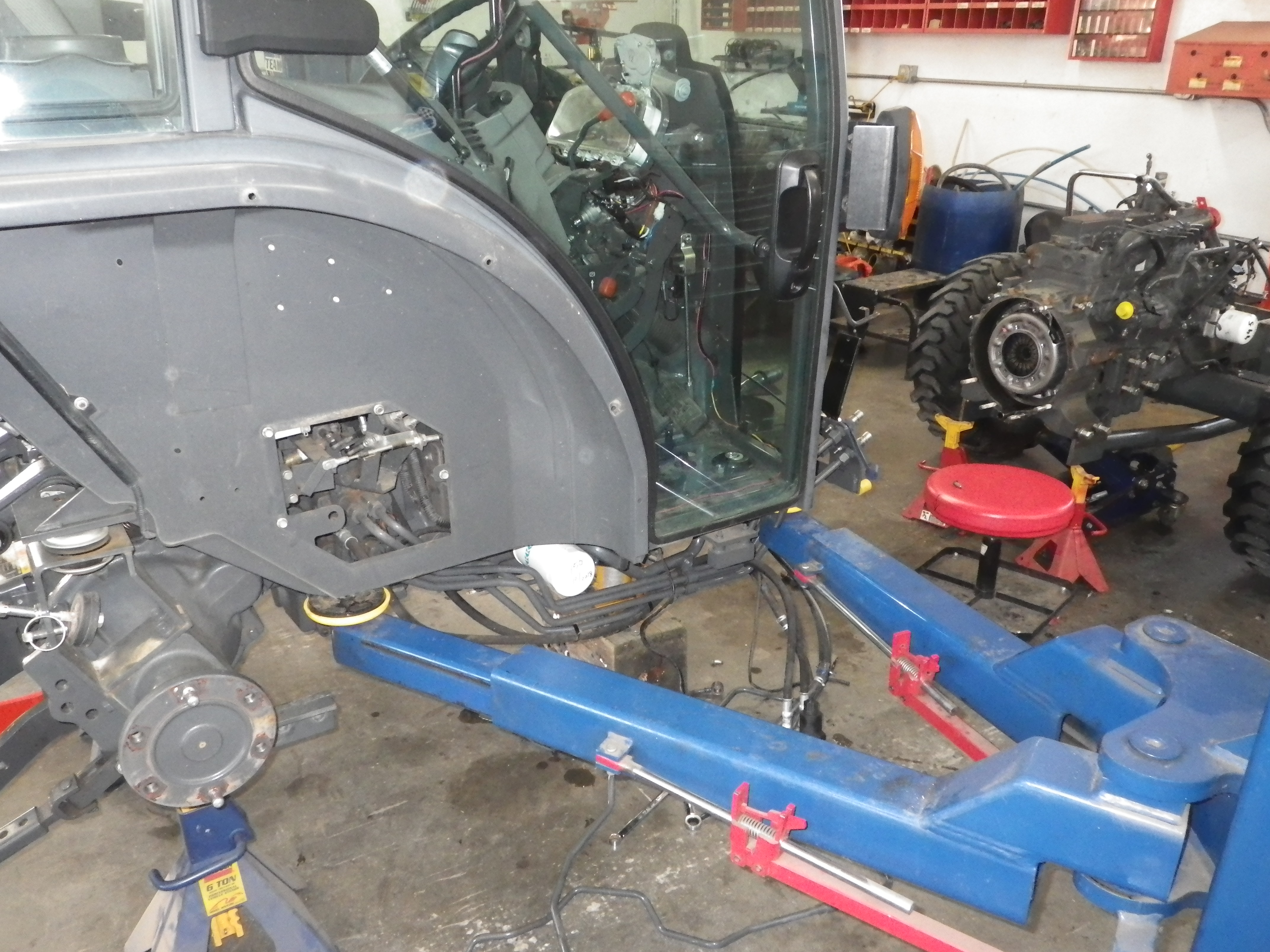

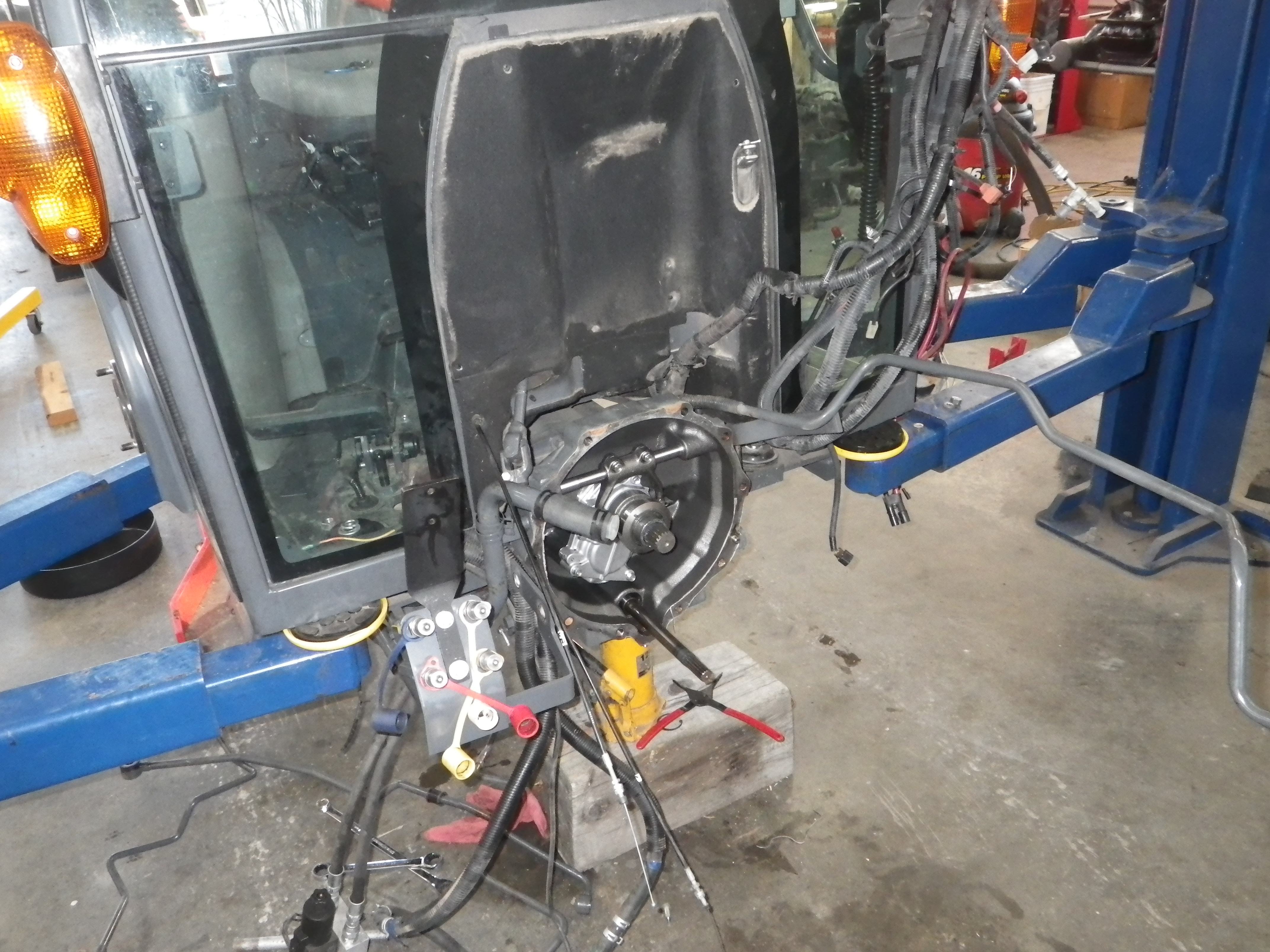

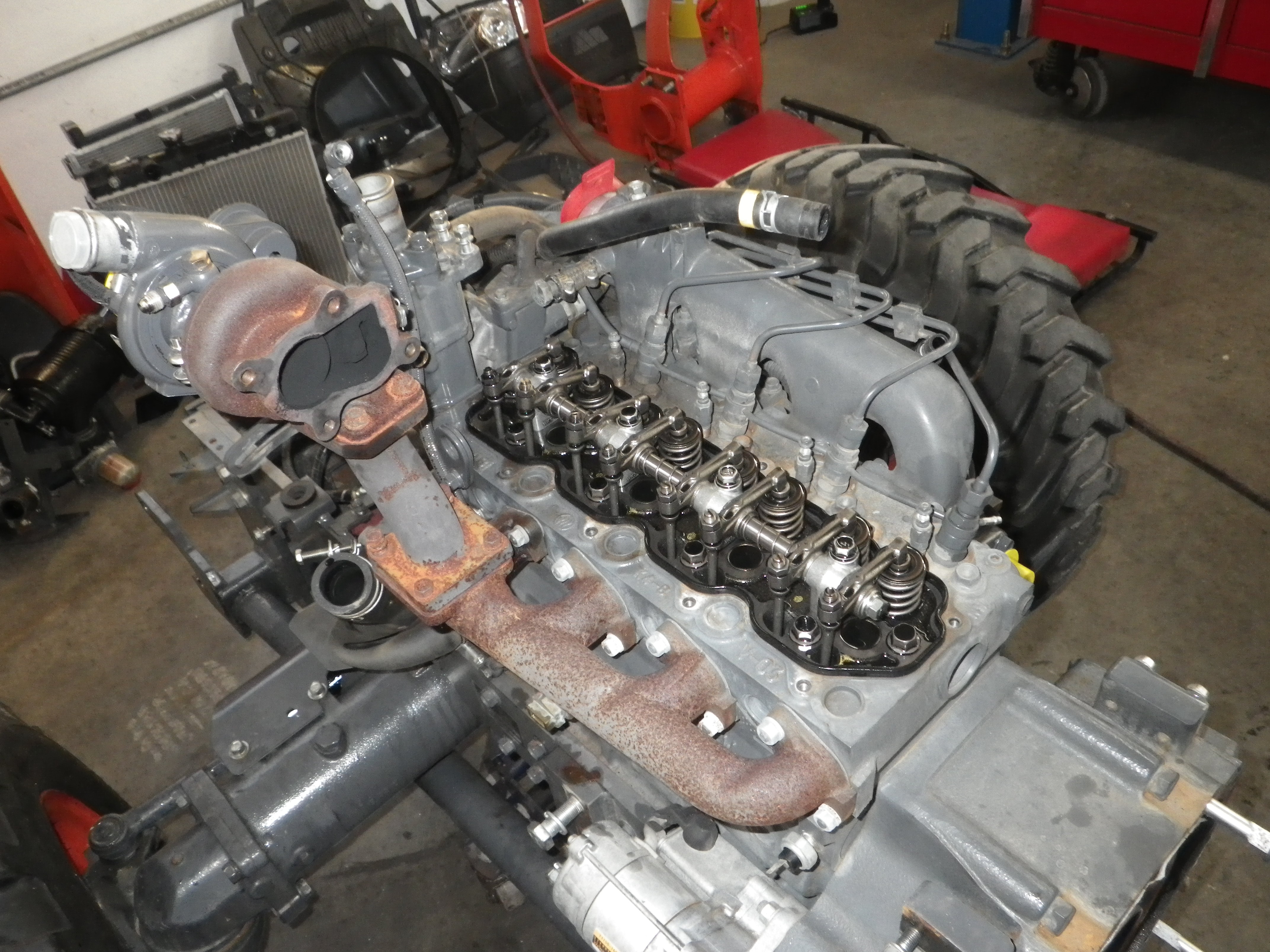

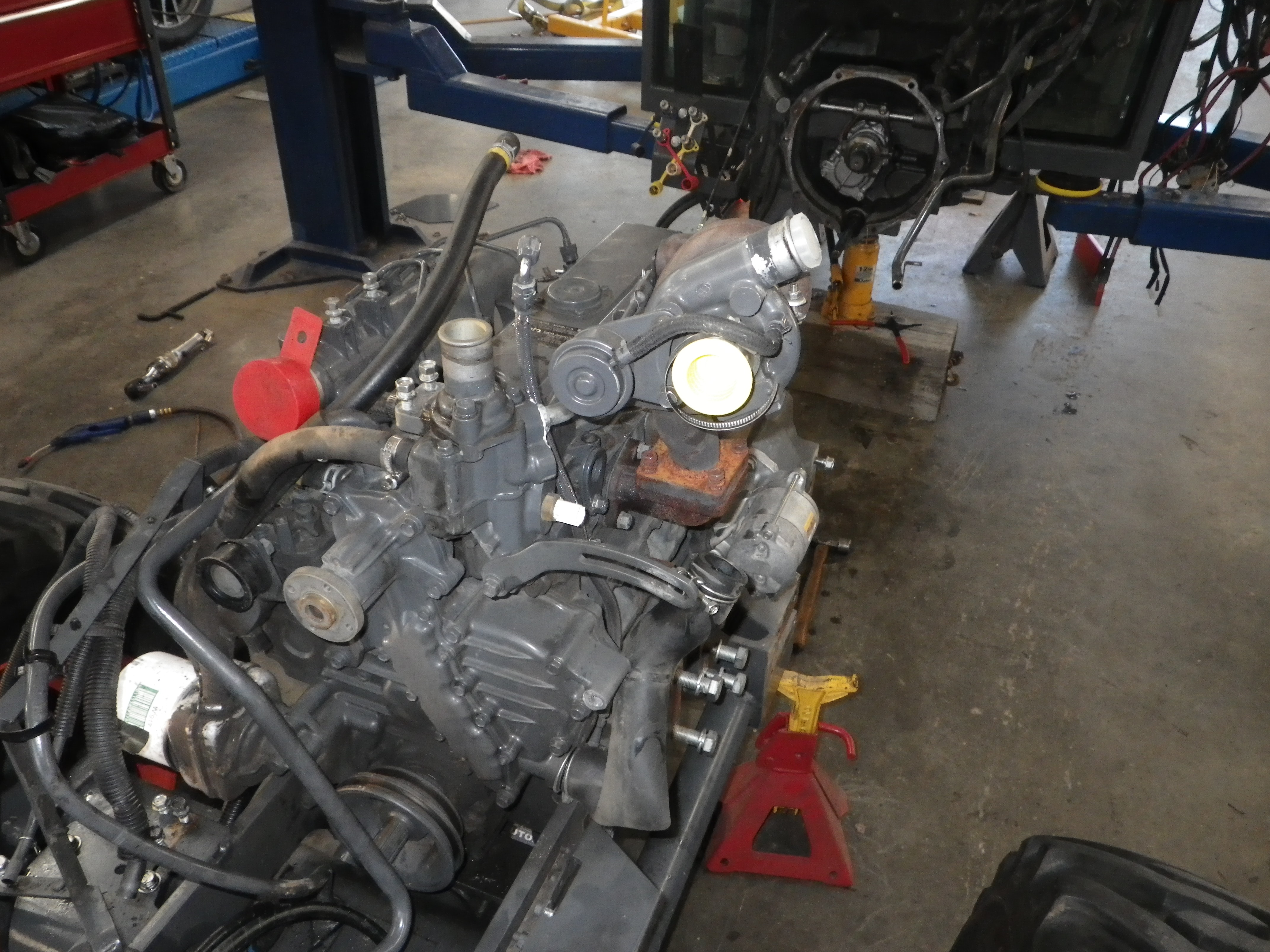

So I lied, I still own this turd of a machine. What a crapshow this repair is...... IMGP0217.JPGIMGP0218.JPGIMGP0216.JPGIMGP0215.JPG
   / I Still Hate My Tractor II #370
So what is exactly wrong with it that it needs repaired?
