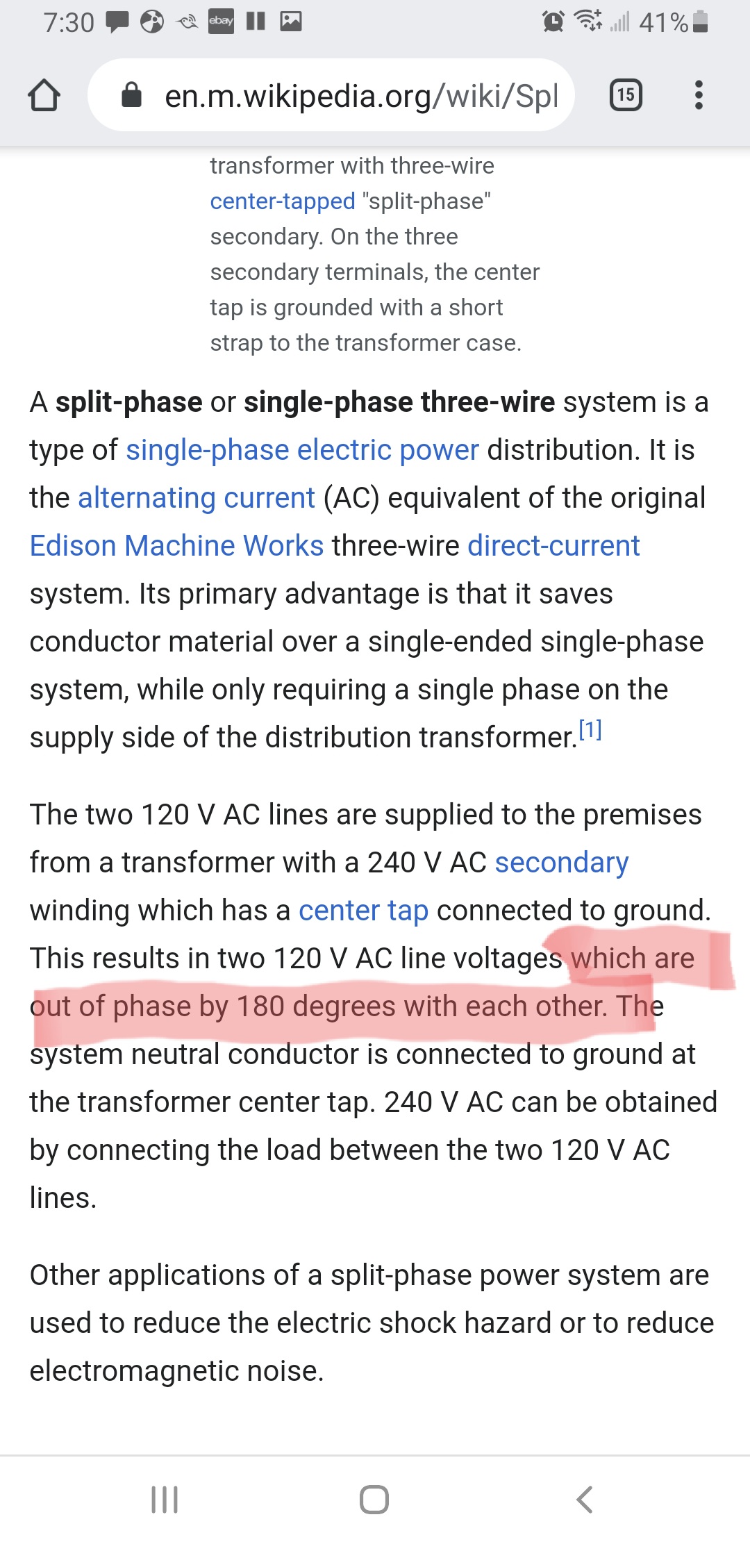

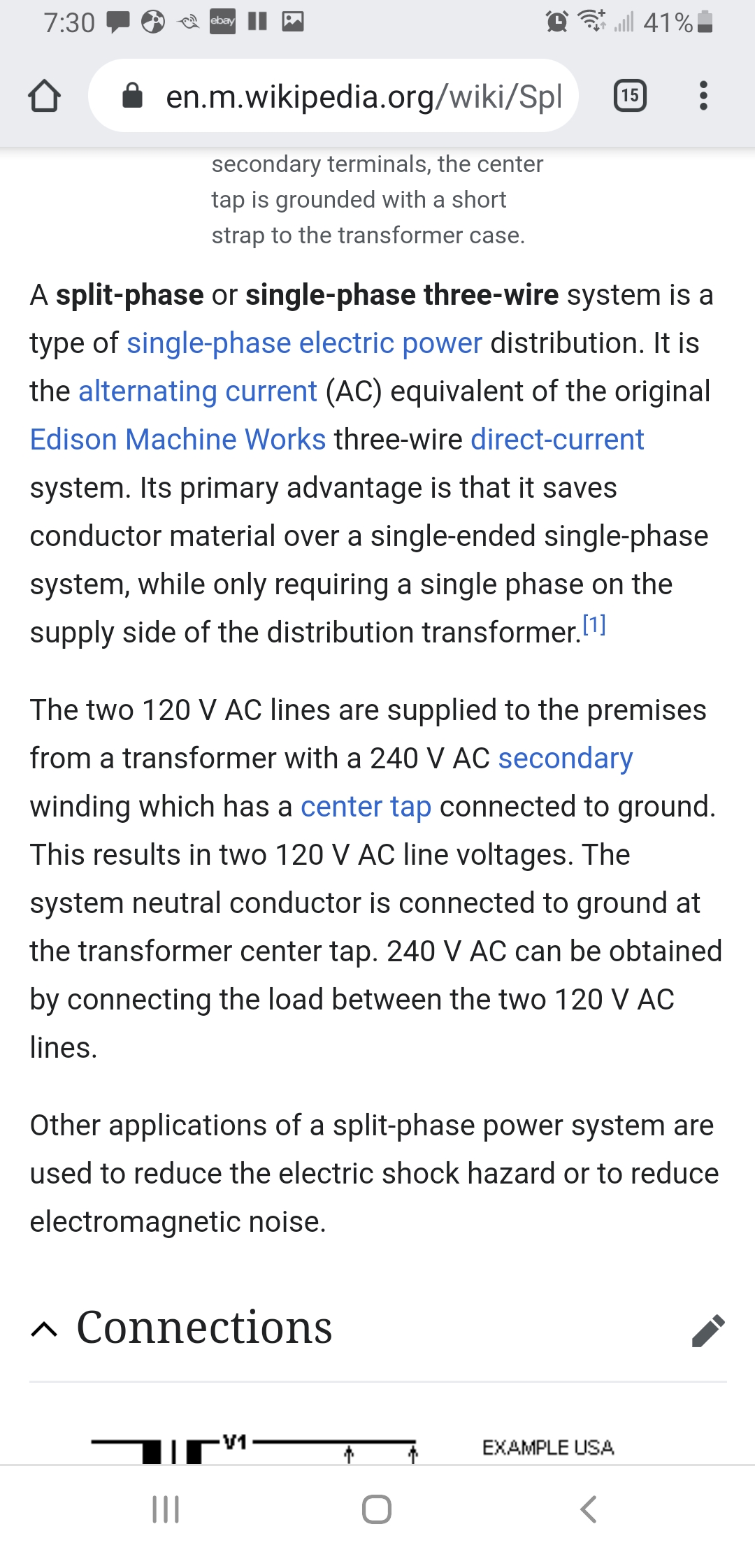

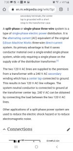

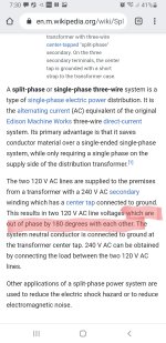

I've fixed the Wikipedia page. For anyone who is curious, this is what it used to say:
Here's what it says now:

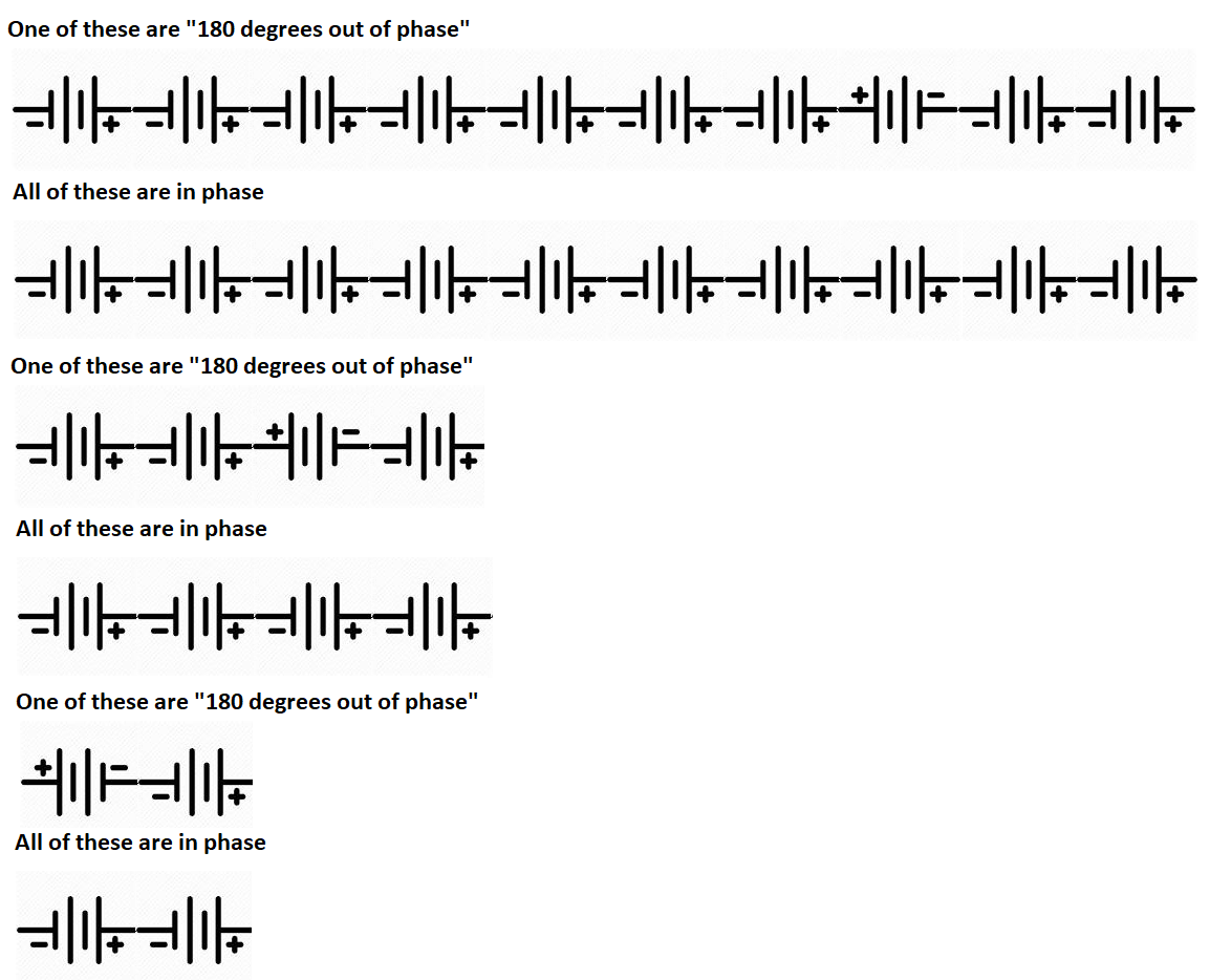

I think the problem here is everyone's (including mine) own personal familiarity with electrical power distribution. If you're willing & able, divorce the issue from the electrical grid and look at the physics.
Here's the simplest precalculus/trig video I could find on the topic of adding sinusoidal waves. Don't take it from me, take it from a teacher:
2 combining waves - YouTube
Waves existing in the same medium (any waves, water waves, sound waves, trig waves on a graphing calculator, electrical waves, etc.) of equal magnitude and frequency, in phase, add to make a wave of the same frequency but double the amplitude. These same waves, if 180 degrees out of phase, cancel each other out. Zero amplitude. This is how sound canceling headphones work.
Electrical waves do not violate the laws of physics. If they add and the result is a wave of the same frequency but double the amplitude, then they have to be in phase. No way around that. If your oscilloscope disagrees, it's because you're feeding it one inverted wave and one non-inverted wave. In order to make your oscilloscope calculate the correct double-amplitude (240v) wave, you must use the add and invert function together. I dont know what else to say.

But this is not an issue of semantics. Reference points do not reverse the direction of current flow. We can talk about Reference points until we are blue in the face and it won't change this (substitue batteries for transformer windings if necessary):
When you say "L1 is 180 degrees out of phase with L2," you are saying that it literally is. But it isn't. It's only appears out of phase when using ground as a reference point. That's an important distinction that very few people are willing to make. I dont know why.
