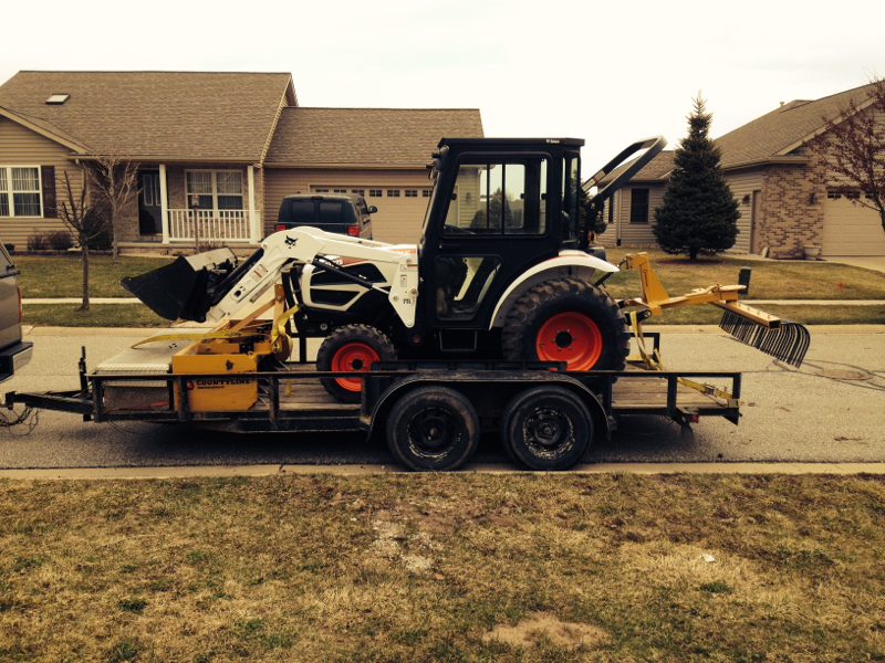

I need a new trailer to haul my bobcat CT 225 with attachments. I'm thinking 10,000 pounds minimum capacity and minimum 18 foot long possibly 20. I would really like to keep the side rails that I'm used to from my utility trailer. And I have never had a beavertail trailer before and I'm not sure I want one now. I'm curious what other people use or recommend and what they like. I will be upgrading from a 16 foot 7000 pound capacity utility trailer show in the picture. Any input would be appreciated thanks

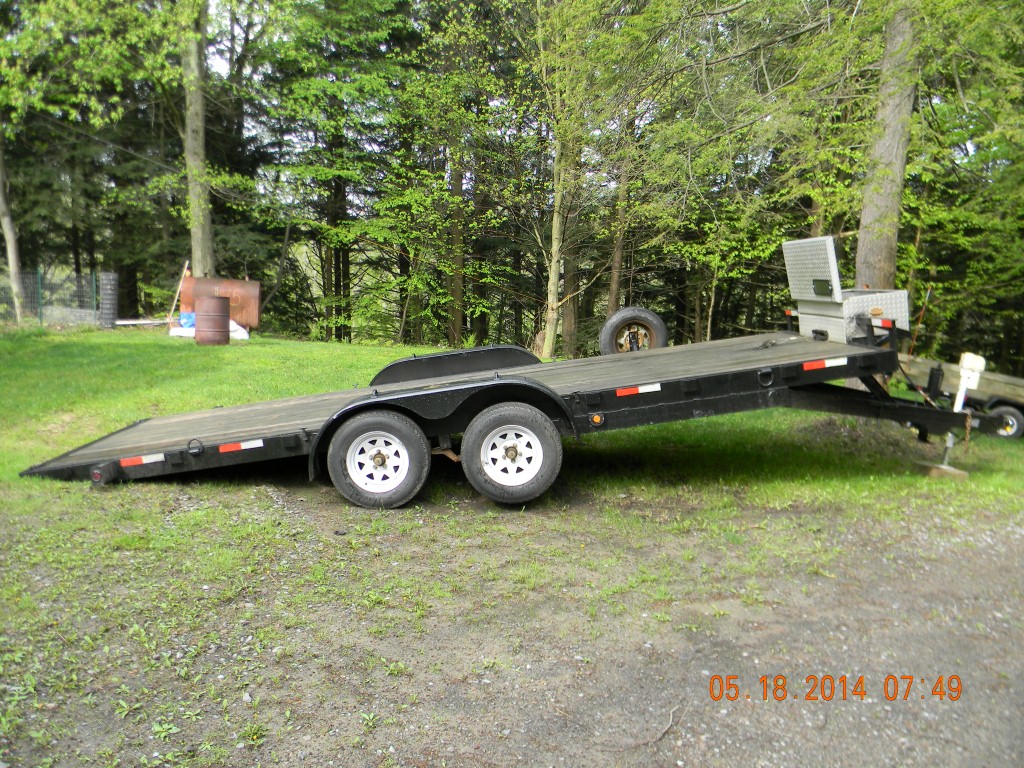

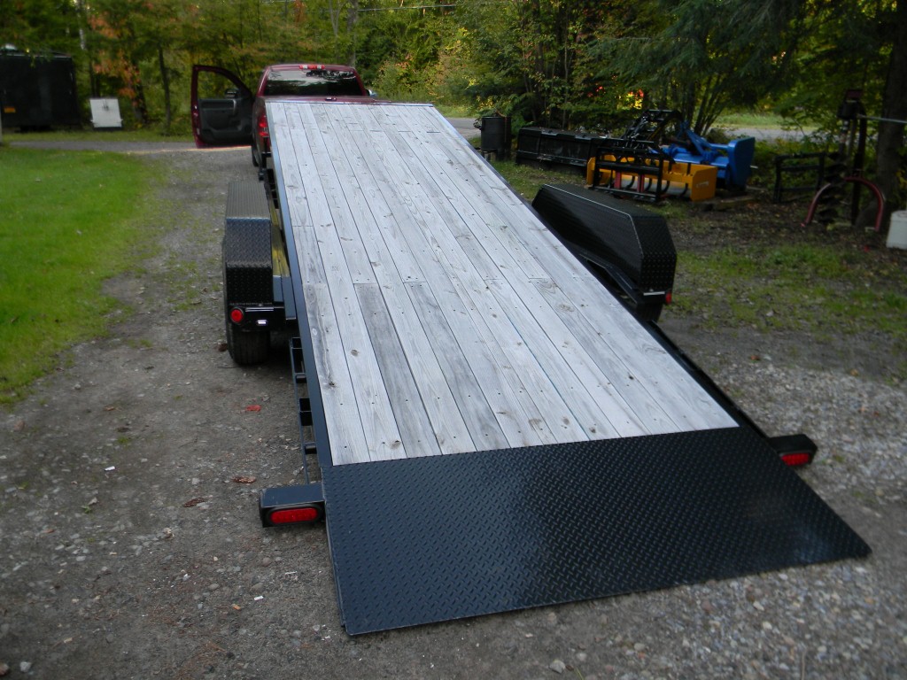

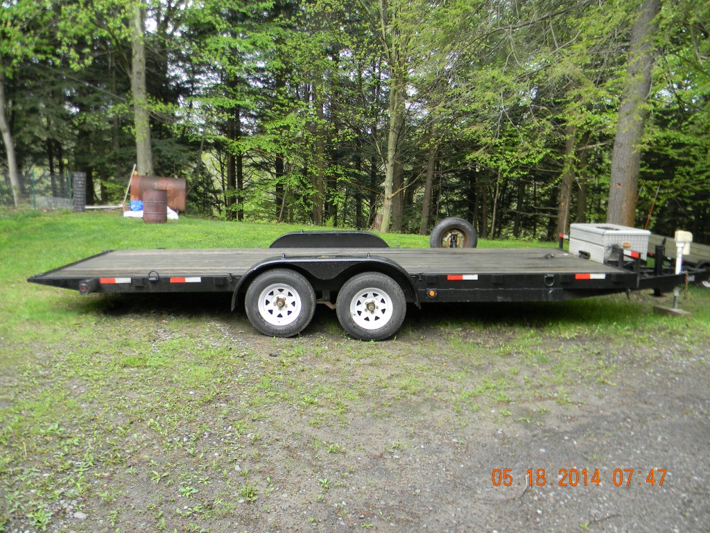

I had to do the same thing a few months ago. I had a 20' H&H 7K tilt bed trailer. That was fine for my previous tractor and implements. Total weight of them was under the 4600 lb. capacity.
Then I sold that tractor and implements (too small for new tractor) and bought a new tractor. The new tractor w/ loader has loaded tires, weighs in about 5000 lb. or so not counting implements. Adding an implement or two pushes the weight well over 6K so too much for the 7K trailer.
Sold the 7K and bought a 24' (22' plus knife edge) 14,000 lb PJ tilt bed. Load capacity is about 10,400 lb.
From the looks of your pic you need at least a 20'er 10-12K rated so the loader bucket and implement on back would both be on the deck. A longer deck gives you room to shift the load fore and aft if needed. There are lots of good trailer brands that have the side rails you want. My preference is a tilt bed. No ramps to mess with but they are more expensive than one with ramps. Fist two pics are the H&H 7K, other 3 are the PJ 14K.

How does that tilt work? Do you have to pump it by hand or is there a battery or what. And what kind of money are you talking

The tilt operates by an 12V electric over hydraulic pump. Double cylinders. Power up and power down. I'll send you a PM.

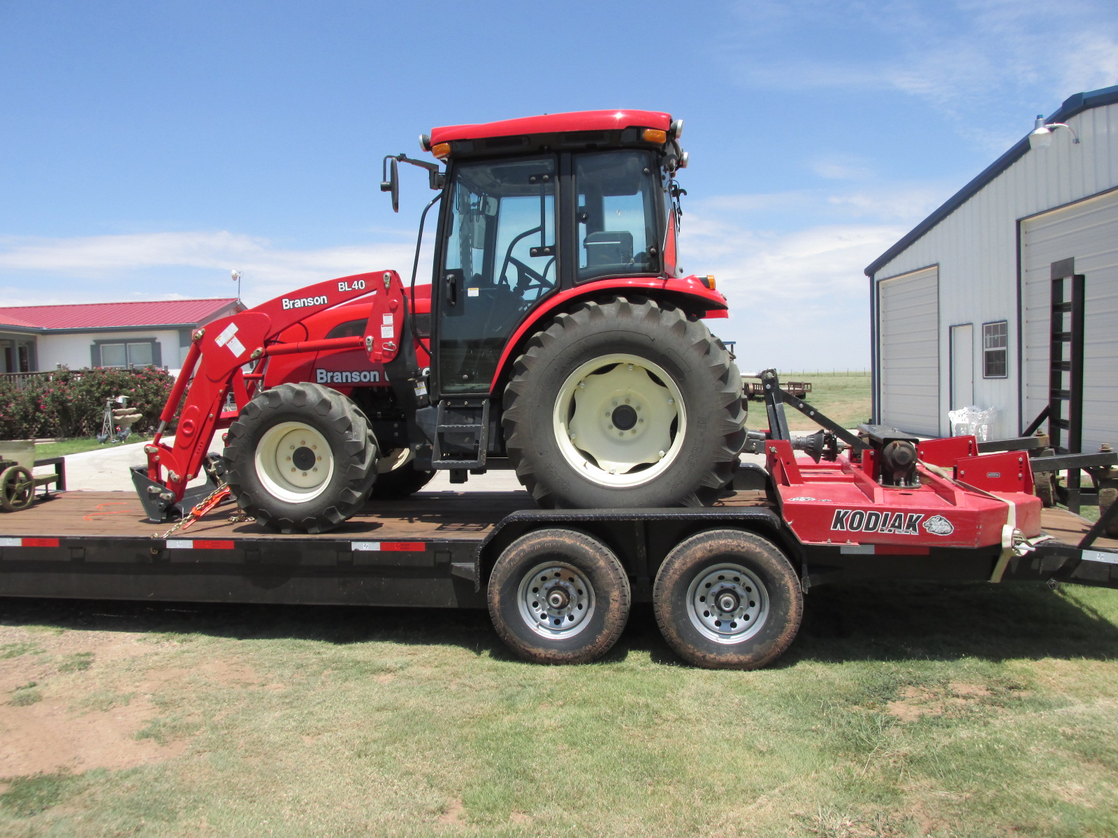

10k 20' (16'+4') deckover. Really like it... F250 pulls it just fine, tractor/loader/brush hog fit nicely. Pic is just after new decking this past summer.
