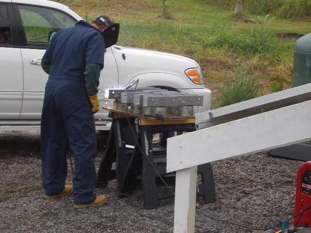

Well, I can lay claim to some ugly welds, but I do think they are strong. I was having wind from time to time.
As for the breaker - have to admit, I was cheating a bit. Being as I had to run the genset, I also had my inverter/charger plugged in so as to be charging my battery bank, so it could very well be it only popped because of this, but I have no way of knowing and the 120 breaker did not pop. Of course, as also stated, could be I've got a weak breaker. Guess, I might investigate replacing it sometime.
David
/ I need a welder.... #38
Just thought I'd post an update. Had a new project, welding some simpson post caps to pipe coupling. Used the 60 amp setting and everything worked fine, never popped the breaker once.
David
