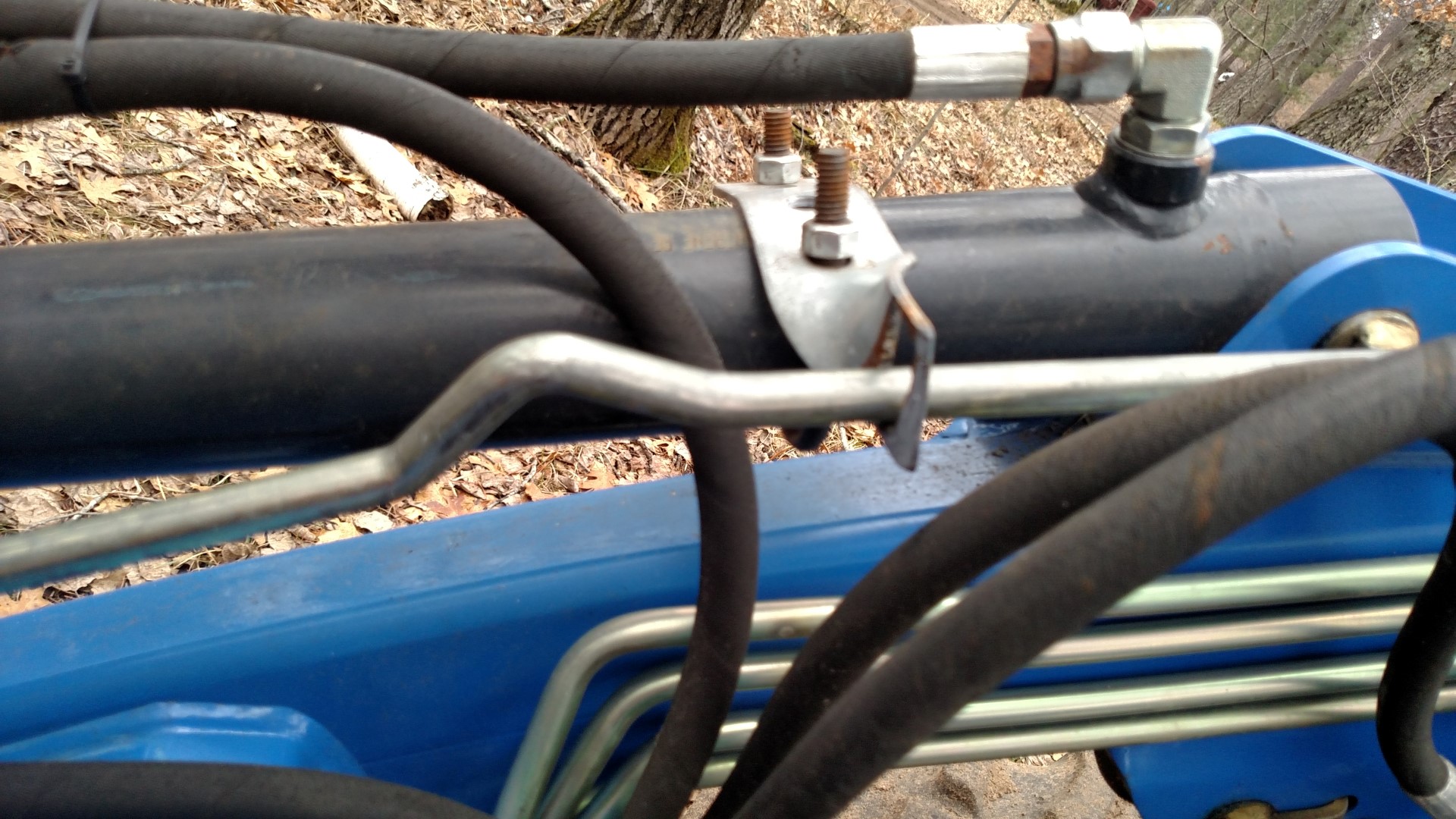

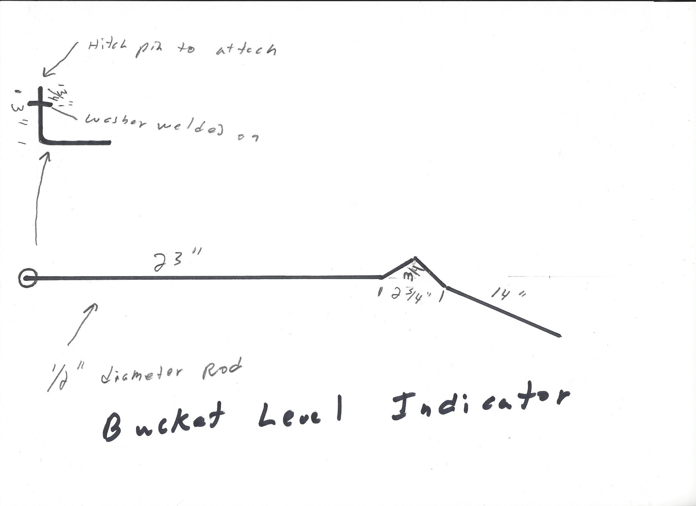

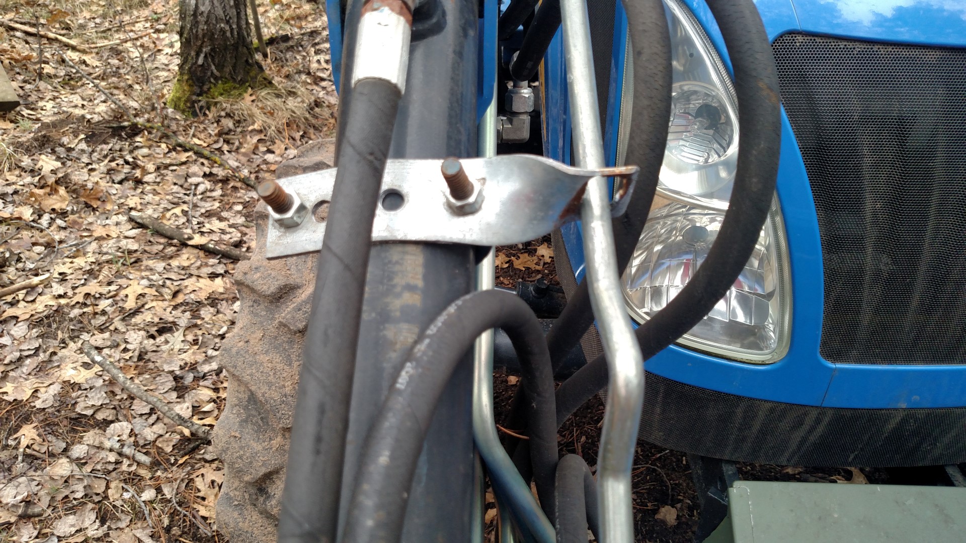

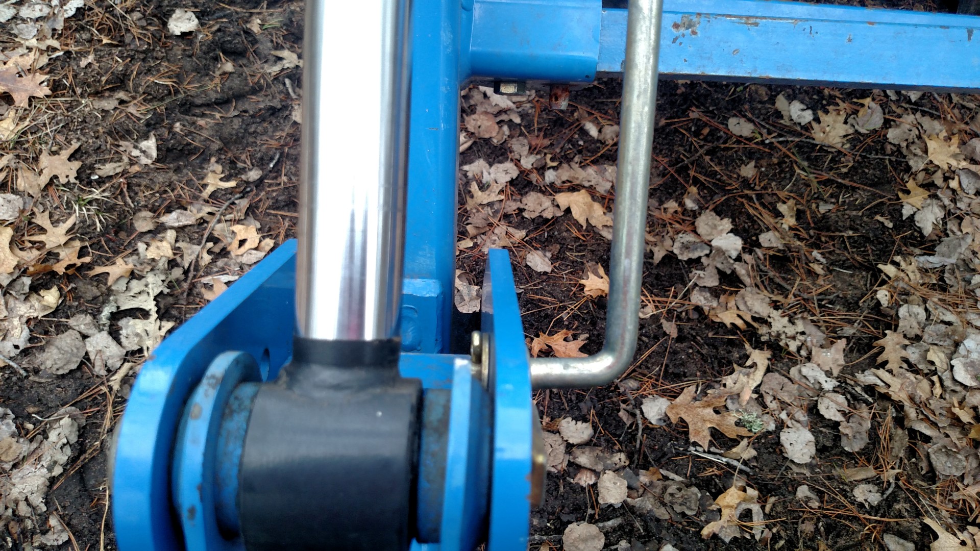

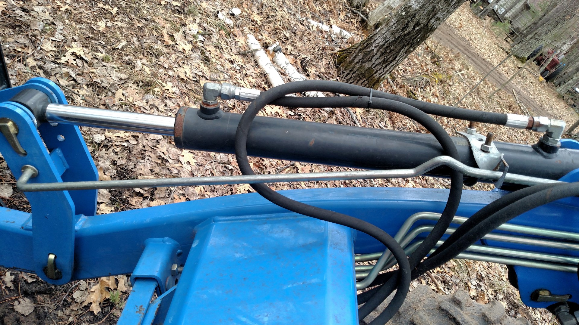

I agree that practice makes perfect. If you're not perfect a bucket level indicator helps until you are perfect. Here are pics of mine.
Bucket Level (Large).jpgBucket Level 2 (Large).jpgBucket Level 3 (Large).jpgBucket Level 4 (Large).jpg
   / I NEED A TIP HOW TO SEE IF MY BUCKET IS LEVEL THE GROUND #49
Simple and effective! I like it!
   / I NEED A TIP HOW TO SEE IF MY BUCKET IS LEVEL THE GROUND #50
Yep, airbiscuit has the same type that I do. Couldn't find any good pics of mine.
As to the friendly bantering, those of us with indicators are not the ones suggesting hours of use to become effective, regardless of tractor brand. :D
